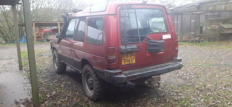

Dan the van Posted December 13, 2021 Share Posted December 13, 2021 Aware that D1 prices are rising rapidly I've been on the lookout for a cheap one for a while.Spotted this on the'Bay,committed the cardinal sin of purchasing unseen(@£900 it was worth a gamble).Cheap because it only had 1st/3rd/5th but i pre booked an MOT,got insurance and i intended to drive it back.WCPGW?.So come yesterday we loaded my oppo's D1 with everything I could think we would need and set sail for N Cornwall.Found the place easy enough,car looked ok,chucked in the new battery I'd bought(it had been laid up for 2yrs) and turned the key.Nothing.Immobiliser stuck on,tried a new battery in the key fob but it was dead.Ok so far so good*.Decided to tow it the 30 odd miles home which we duly did.No pics of the journey back due to a strap a little* shorter than I would have liked and not much brakes hence left hand was permanently holding the transmission brake.🤣.Anyway,Jim knows what's what and the miles steadily clicked off until we arrived back at the DTV Ranch.Further update dreckly.🙂. Saabnut, Peter C, chodweaver and 17 others 20 Link to comment Share on other sites More sharing options...
sutty2006 Posted December 13, 2021 Share Posted December 13, 2021 3 door too. Very nice. Welcome to Hell. It’s warm in here but you get used to it eventually. Make sure to get a good welding mask and plenty of wire + gas. djim, Shirley Knott, grogee and 5 others 6 2 Link to comment Share on other sites More sharing options...
Dan the van Posted December 13, 2021 Author Share Posted December 13, 2021 Lol I've had two before.I'm a total no hoper.🤣🤣.Just found the EKA code so going to do the bypass procedure in a bit and it'll run hopefully.Gearshift issue is likely to be the bias plate broken.Lever sits below 1st instead of 3rd. sutty2006 and LightBulbFun 2 Link to comment Share on other sites More sharing options...
Dan the van Posted December 13, 2021 Author Share Posted December 13, 2021 So,sit rep:Approved factory immobilizer bypass fail due to probable drivers door lock problem.It works but not doing what it should.Have ordered an immobiliser bypass loom for £20 which should get me up and running.In other news I got the pressure washer out and gave it a good clean above and below.Body is real straight.Paint is v shiny,even the roof.Isolated lacquer peel on top of drivers wing and door.Already found two small holes in the n/s inner wing last night along with a bit inside the o/s/r inner arch.tadts.N/s is fine.Had a good poke underneath and it's proper solid in all the usual places.Nothing to do really,bit of surface rust to chase back and paint but the proper job can wait 'till the spring no prob.Looks like I accidentally bought a decent one.😁.Engine still unknown but it's got oil and water in the right places and I've turned it over.134000 is nowt for one of these so should be reet.🙂. Flat4, sutty2006, CreepingJesus and 6 others 9 Link to comment Share on other sites More sharing options...

Dan the van Posted December 16, 2021 Author Share Posted December 16, 2021 Update.It runs!.Had a moment to look at the key fob lunch time.Opened it right up and a widget bit fell out.Close inspection with a glass assertained where it should be,tiny dab of super glue to hold it on the contacts and,bugger me, it worked.🙂.Took a fair bit of cranking(fuel related) but sounds ok.Oil +charge light not going out tho',will look into that later.I shut it off and walked away congratulating myself,looked back,and saw the huge puddle of oil underneath.🤣🤣.Not terminal tho',the big oil feed to the turbo has a huge split in it.🤬.Was gonna change the oil anyway.🙄.Will order a new fob tomorrow.Progress!. sutty2006, tooSavvy and warch 3 Link to comment Share on other sites More sharing options...
Dan the van Posted December 16, 2021 Author Share Posted December 16, 2021 Oh and the gear shift.Got drive in 1/2/5+reverse,hard to find 3rd,4th ok but no drive in either.Still a linkage problem I think??.Input welcome.🙂 Link to comment Share on other sites More sharing options...
warch Posted December 16, 2021 Share Posted December 16, 2021 12 minutes ago, Dan the van said: Oh and the gear shift.Got drive in 1/2/5+reverse,hard to find 3rd,4th ok but no drive in either.Still a linkage problem I think??.Input welcome.🙂 All my gearbox knowledge is based on earlier vehicles, but I'd check the bias plate or whatever they call it hasn't come loose and is impeding the gearchange. If this is ok and the bush for the gearstick isn't buggered have a look at the linkage on top of the box and make sure it operates smoothly*. IIRC 3rd and 4th are on the same shaft so the issue could be fairly major or something piddly like a sticky mechanism. Dan the van 1 Link to comment Share on other sites More sharing options...
sutty2006 Posted December 16, 2021 Share Posted December 16, 2021 It does sound internal. Can 3rd or 5th be engaged but nothings coming out of the gearbox? If so I’d say it’s got an internal fault in it Dan the van and warch 1 1 Link to comment Share on other sites More sharing options...
