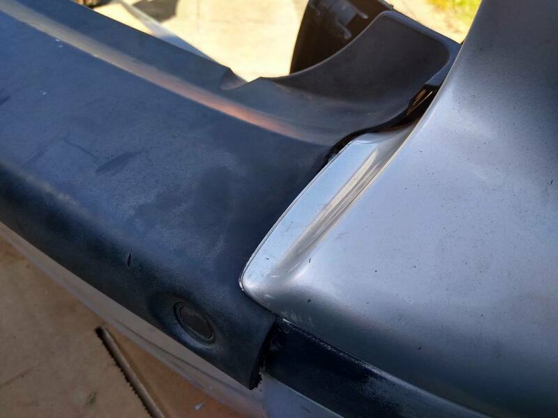

grogee Posted March 17, 2022 Author Share Posted March 17, 2022 Had another look. I don't think this is overspray - I think the black is actually on over the silver but has worn off, leading to what looks like overspray. So I think @Popsicle 's suggestion of spraying something back on is what's needed. The problem will be trying to match the finish of the centre insert, which is indeed proper plastic. I don't want to just spray A.N. Other matt black paint on. Any suggestions? Link to comment Share on other sites More sharing options...
Popsicle Posted March 17, 2022 Share Posted March 17, 2022 Spray it all orange like they VW boys do, it'll look sick innit. Chances of getting an exacting match black are pretty slim I reckon. I presume two shades of black will mess with your head? Pain in the arse but would it be worth spraying all the black trim? grogee 1 Link to comment Share on other sites More sharing options...
grogee Posted March 17, 2022 Author Share Posted March 17, 2022 43 minutes ago, Popsicle said: Spray it all orange like they VW boys do, it'll look sick innit. Chances of getting an exacting match black are pretty slim I reckon. I presume two shades of black will mess with your head? Pain in the arse but would it be worth spraying all the black trim? Sick, yo! Orange and green! Yep two shades would make me twitch. I'll have a think. This bumper stuff is only cosmetic, I need to get the thing mobile again. Ironically the front bumper is worse but I was planning to take that off and fill/spray in the summer. Tomorrow is other side hub & brakes then I'll see about tweaking the air con. Link to comment Share on other sites More sharing options...
stuboy Posted March 17, 2022 Share Posted March 17, 2022 camoflage it................ Popsicle, AnnoyingPentium and grogee 3 Link to comment Share on other sites More sharing options...

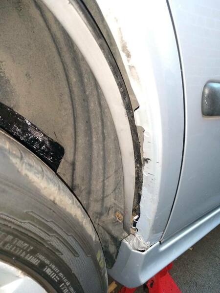

Wgl2019 Posted March 18, 2022 Share Posted March 18, 2022 1 minute ago, grogee said: final piece in the puzzle is these wheelarch finishers. I think they should be held on with silicone goo, there's certainly some in them. But I'd like to get the old stuff out before applying any new goo. Has anyone got any suggestions for cleaning off old silicone sealant? They are just glooped into place. Screwfix sell a silicone remover but not sure how good this is, iirc I used some horrible roofing mastic to stick mine back down as I had it left from sorting a different job. grogee 1 Link to comment Share on other sites More sharing options...

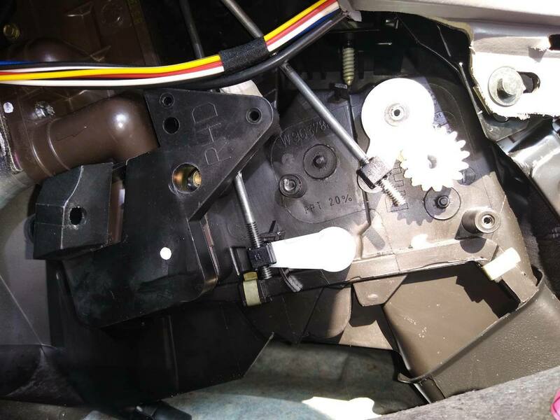

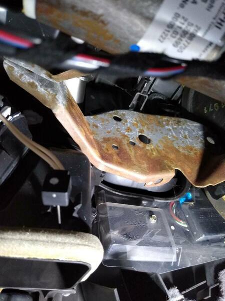

grogee Posted March 22, 2022 Author Share Posted March 22, 2022 Today I attempted to fix the sticky flaps. Having had a play with some trim off, the distribution drum thingy rotates enough to do windscreen and floor level, but it won't rotate around far enough to give face level. Annoying in the summer. Access to the bits I'm trying to reach is horrendous. The stepper motors and levers are on the driver's side (of course) and there's a dash brace right in the way of where I need to be. Of course the WIS book of lies makes no mention of this access problem, and instead just explains the procedure with a removed climate unit on a nice clean bench! Thanks, Saab. I may end up taking the dash out, which is obviously horrible, but I do have alternative wheels. Maybe I'll SORN it for a bit in the summer and do the front bumper (fill/spray) at the same time. However before I try that I'm going to take the driver's seat out and lie on my back to see if that improves matters. Job for tomorrow! Cookiesouwest, djoptix and AnnoyingPentium 3 Link to comment Share on other sites More sharing options...

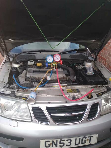

grogee Posted March 22, 2022 Author Share Posted March 22, 2022 Done a bit of digging on the A/C system. The plan for today was to fix the flaps, but that looks quite involved so I decided to check AC system. After all, cool air through any vent is better than no cool air at all. Seemingly drawing a blank on my first try, with both high and low ports reading about 30psi, I had a look at the fuses. A while back, I'd disconnected the anti-theft system fuse to prevent an error message on the SID on start up. However, that same 10A fuse apparently powers the compressor clutch - when I plugged the fuse back in, there was a 'clunk' from the compressor and the high side rose to about 150psi. That's good, shows the compressor is compressing. I've added in some more fake R134a to top the system up and now high side is up to about 175psi which seems healthy. The AC pipe going to the cabin is nice and cold, too. I imagine the anti-theft fault warning will come back, but I can live with that if it means a comfortable cabin. Cookiesouwest, Rust Collector, rainagain and 3 others 6 Link to comment Share on other sites More sharing options...

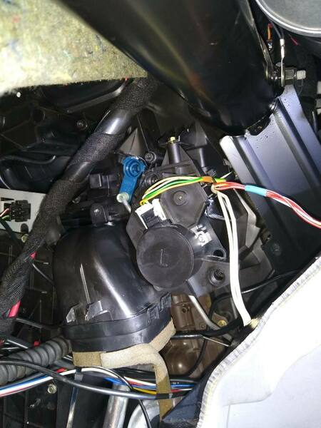

grogee Posted March 23, 2022 Author Share Posted March 23, 2022 Today's mission involved working out how the Saab's HVAC system worked from first principles. There were some clues in the WIS book of lies, but they weren't necessary conclusive to the fault on mine - unable to shift to face level. Anyway I took the driver's seat out which wasn't as bad as I thought it would be. The seat belt mount has a quick release which is handy. Then I laid a couple of slabs of foam on the floor and lay on my back to get at the foot level vent. Taking this off reveals the distribution 'drum' which rotates to direct air to screen, feet or face. Mine was able to do feet and screen but not face. According to the WIS you have to push it fully clockwise to get face level. Mine appeared to be jammed so I forced it then heard a crack... oops. Turns out the actuator is on the passenger side. The crack was this blue/grey arm thing which had failed. I tried superglue but it takes a fair amount of torque to rotate the drum even after I've lubed it all up. To check it was working ok from the passenger side I had to Jerry rig a 1/4" extension and ratchet then turn it from the other side and see if it moved. There's no room to get fingers in there - thanks Saab. The good news is that there's a Saab spares guy on eBay who sells useful but obscure bits so I've been able to get the arm 2nd hand along with some stepper motors (which I don't need - yet). Cookiesouwest and rainagain 2 Link to comment Share on other sites More sharing options...

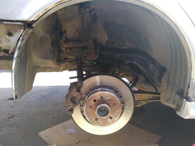

grogee Posted March 24, 2022 Author Share Posted March 24, 2022 Today I are be mostly under my Puma. It's making a rattling noise that I can feel through the steering wheel. I've had it on stands three times now to try and isolate the source, but everything I've checked is ok. Today I double checked subframe bolts (even though I'd paint marked them and they haven't shifted). And caliper bolts, ARB links, wishbone bolts etc etc. All tight and behaving. I'm thinking it must be exhaust rattling around somehow because the routing is a bit poor and it touches on the body in one spot. While I was under the car I treated a few spots of rust that would only get worse, so wire wheel, rust juice then a couple of coats of chassis black. The front radiator carrier thing is a bit crispy too. I gave it a quick going over but a new Ford one is only £23 so not worth going mad over. Anyway it's been bugging me but no smoking gun yet. Also found this bumper scrape which I treated with some scratch remover, it's better now but not perfect. Ah well these things happen. mercedade, Sunny Jim and rainagain 3 Link to comment Share on other sites More sharing options...

grogee Posted March 27, 2022 Author Share Posted March 27, 2022 More Saab bothering this afternoon, once we'd got rid of MiL. I have fitted some of the second hand spares I bought. The challenge seems to be turning the distribution drum - it sometimes seems to stick and jam up. But I've freed it up as best I can, and squirted a load of silicone oil in there. Fitted the spare servo/stepper motor that does the distribution drum. I didn't have a choice because the replacement crank thing had a hex rather than a T-shaped spline like the old one. I can't get the unit apart any further to do anything else, so if I've still got problems then I need to consider dash off and new/used climate unit. Not something I really want to contemplate for now. I'm hoping if I just leave it in AUTO and air con on, the windows won't mist up and I won't need windscreen blow. But I imagine I'll need some defrost action in about six months when the weather starts to get worse. Anyway I've just got to screw the trim back together tomorrow, then the next job is a wash, polish and wax... That counts as heavy lifting in my book. Link to comment Share on other sites More sharing options...

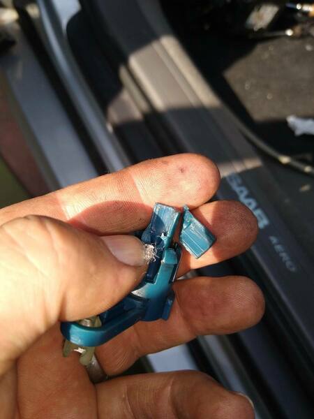

Barry Cade Posted March 27, 2022 Share Posted March 27, 2022 On 3/23/2022 at 3:37 PM, grogee said: Today's mission involved working out how the Saab's HVAC system worked from first principles. There were some clues in the WIS book of lies, but they weren't necessary conclusive to the fault on mine - unable to shift to face level. Anyway I took the driver's seat out which wasn't as bad as I thought it would be. The seat belt mount has a quick release which is handy. Then I laid a couple of slabs of foam on the floor and lay on my back to get at the foot level vent. Taking this off reveals the distribution 'drum' which rotates to direct air to screen, feet or face. Mine was able to do feet and screen but not face. According to the WIS you have to push it fully clockwise to get face level. Mine appeared to be jammed so I forced it then heard a crack... oops. Turns out the actuator is on the passenger side. The crack was this blue/grey arm thing which had failed. I tried superglue but it takes a fair amount of torque to rotate the drum even after I've lubed it all up. To check it was working ok from the passenger side I had to Jerry rig a 1/4" extension and ratchet then turn it from the other side and see if it moved. There's no room to get fingers in there - thanks Saab. The good news is that there's a Saab spares guy on eBay who sells useful but obscure bits so I've been able to get the arm 2nd hand along with some stepper motors (which I don't need - yet). I've had issues with both my 9-5 blend doors, used these and never any issues again. Link to comment Share on other sites More sharing options...
grogee Posted March 28, 2022 Author Share Posted March 28, 2022 Thanks @Barry Cade. I think the heater blend doors are working ok at the moment but I did have to superglue the arm onto the LH side one. Anyway that's good to know. I'm surprised there isn't an equivalent kit for the distribution drum. Even after my fiddling the movement isn't exactly smooth which means that poor little servo motor is doing a lot of work. Anyway fingers crossed it'll be serviceable for a while Barry Cade 1 Link to comment Share on other sites More sharing options...
grogee Posted March 29, 2022 Author Share Posted March 29, 2022 Did a test (press AUTO & OFF simultaneously) and the system does a calibration/check. The calibration is important because the motors don't 'know' where they are until they pass through their full travel. The check highlights any faults and today I'm pleased to report 0 faults. I could hear the flaps and stuff whirring away so that's probably good. I can only imagine the whole thing was a warranty disaster for Saab. It's a very Heath Robinson setup with long levers and linkages that just look destined to fail. And the aforementioned motors are quite stressed even with substantial reduction gearing. Anyway I've since been on a mission cleaning the outside. I am in my last week of current job which means I'm basically doing NOTHING and have all day (between school runs) to do stuff to the cars. Yesterday was back breaking polishing, today is back breaking waxing and detailing. Of course the weather threw a wobbly and it was raining this morning as I was chamoising the car dry, a Sisyphean task. Went to the cheap shop for wax but they only had some weird spray on stuff which doesn't feel very convincing. Of course I continue to forget I'm paying for Amazon prime and so I've ordered some cheap turtle Wax liquid stuff which I'm more used to. No pics yet as I've only done one side of 'back to black' which is grim stuff. I did wonder whether black shoe polish might be more effective? Link to comment Share on other sites More sharing options...
