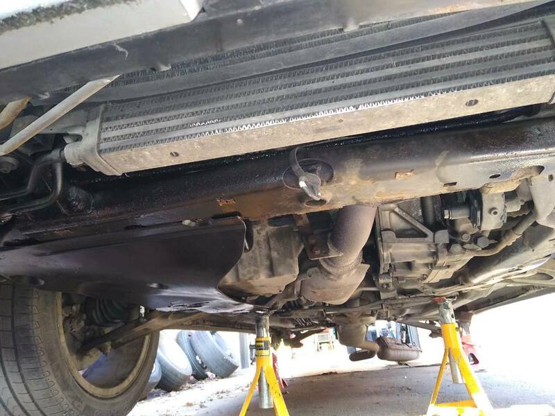

grogee Posted January 28, 2022 Author Share Posted January 28, 2022 Had a bit of time and dry weather today, so I got the Saab front level sensor fitted. It's part of the xenon lights system to automatically drop the lights if there's a load in the boot (or if you boot it). In the course of removing undertray that was in the way I've found an oil leak, not sure which flavour. Is there a favourite place for them to bleed? Levels all seem ok so I'm not losing loads. Perhaps I'll think of it as auto anti-corrosion system. I've been putting off tackling a bit of rot in the rear, because WIRE WHEEL and MESS/NOISE. But got some good news about a job today, so I used that momentum to get on with it. It's actually better than I thought, a bit of surface rust on the rails at the rear. They are thick box section so once wire wheeled I soon found solid metal. Treated with some rust juice and I'll get a coat of zinc primer on tomorrow, weather depending. The exhaust is pretty tired but not leaking, hopefully a pass at next MoT. Dyslexic Viking, juular, Cookiesouwest and 1 other 4 Link to comment Share on other sites More sharing options...

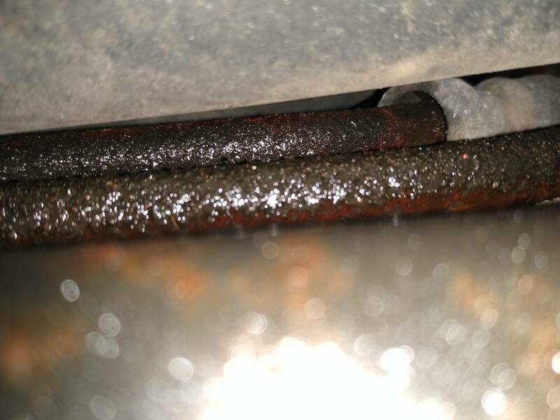

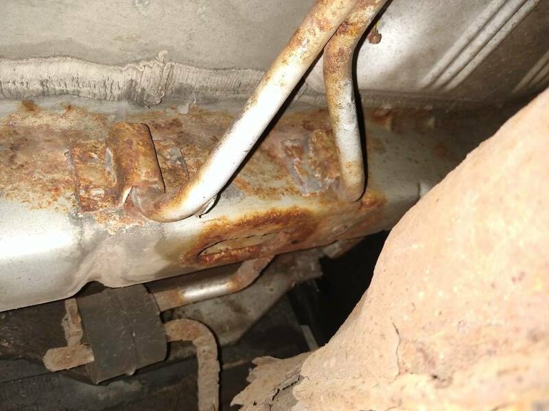

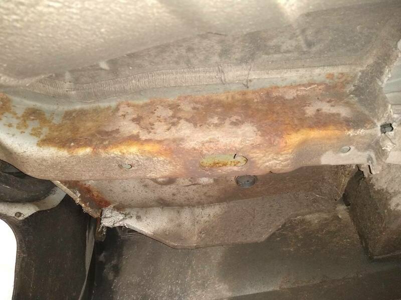

grogee Posted January 29, 2022 Author Share Posted January 29, 2022 Rear brakes bled with the Gunson ezi-bleed thing, which is quite a good idea although not perfect. Still, it enables me to push the old fluid out and put some fresh stuff in. We won't talk about the spillage. Two coats of zinc primer on the chassis rails and one of black goopy chassis paint. My timing was perfect as I finished just as the heavens opened. One more coat of black should do it then I'll strap the zorst back on and put it back on the ground. Best of all it's curry night tonight and I'm celebrating a new job, so I'm expecting a fuzzy head tomorrow morning. rainagain, Cookiesouwest, Wibble and 7 others 10 Link to comment Share on other sites More sharing options...

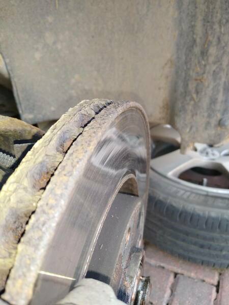

grogee Posted February 3, 2022 Author Share Posted February 3, 2022 Emergency swearing at Grogee Towers this afternoon, @Cluffy on the phone in desperate need of a driveway. Mrs Cluffy's Golf was making a sad clanging noise and once wheel was off, we saw the dust shield was flapping about in the breeze. Getting to it involved getting the caliper carrier bolts off, and they were both tight and nearly inaccessible. This is usually the case in my experience. I threw the full arsenal of breakers, levers, cheater bars etc and, dear reader, I'm sad to report that one 3/8" ratchet died for the cause. But we did eventually free the caliper carrier and found the shield had rusted out all three of its mounting holes. A temporary bodge with penny washers was carried out and everything reassembled in the dark. Mrs Cluffy is now mobile again but we'll need to get those hubs off to get new shields on. Best to do both because the other side will be clinging on for dear life. Cluffy, djoptix, AnnoyingPentium and 1 other 4 Link to comment Share on other sites More sharing options...
djoptix Posted February 4, 2022 Share Posted February 4, 2022 Sir needs a bigger Makita ugga dugga, maybe the dtw1002z iirc? grogee 1 Link to comment Share on other sites More sharing options...
grogee Posted February 4, 2022 Author Share Posted February 4, 2022 1 hour ago, djoptix said: Sir needs a bigger Makita ugga dugga, maybe the dtw1002z iirc? That's as big an ugga-dugga as I need. It's powerful enough for most of what I do. However it is a bit flimsy - the top bit is heavy but the handle bit is a bit wobbly. Anyway there was no way that was getting anywhere near the caliper carrier bolts, as VW have filled that area with something called 'suspension components'. Totally unnecessary in my view. Link to comment Share on other sites More sharing options...
Cluffy Posted February 4, 2022 Share Posted February 4, 2022 15 hours ago, grogee said: Emergency swearing at Grogee Towers this afternoon, @Cluffy on the phone in desperate need of a driveway. Mrs Cluffy's Golf was making a sad clanging noise and once wheel was off, we saw the dust shield was flapping about in the breeze. Getting to it involved getting the caliper carrier bolts off, and they were both tight and nearly inaccessible. This is usually the case in my experience. I threw the full arsenal of breakers, levers, cheater bars etc and, dear reader, I'm sad to report that one 3/8" ratchet died for the cause. But we did eventually free the caliper carrier and found the shield had rusted out all three of its mounting holes. A temporary bodge with penny washers was carried out and everything reassembled in the dark. Mrs Cluffy is now mobile again but we'll need to get those hubs off to get new shields on. Best to do both because the other side will be clinging on for dear life. Can not thank you enough, George. GTi goodness back out hounding the Warwickshire back roads. Project 200k is still on course... grogee and AnnoyingPentium 2 Link to comment Share on other sites More sharing options...
Cluffy Posted February 4, 2022 Share Posted February 4, 2022 6 minutes ago, grogee said: That's as big an ugga-dugga as I need. It's powerful enough for most of what I do. However it is a bit flimsy - the top bit is heavy but the handle bit is a bit wobbly. Anyway there was no way that was getting anywhere near the caliper carrier bolts, as VW have filled that area with something called 'suspension components'. Totally unnecessary in my view. SO many things in the way. I am not looking forward to doing the other side as I've not seen a car that high before without it being on a ramp...! Link to comment Share on other sites More sharing options...

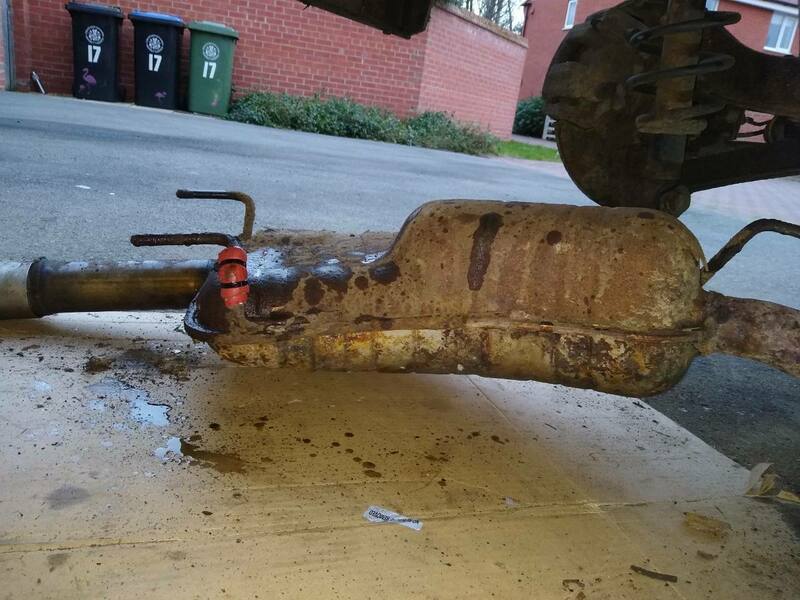

djoptix Posted February 4, 2022 Share Posted February 4, 2022 Also, I've got a niggling feeling I have an Aero back box (used but I think better than that one) in my unit. Yours FOC if it's required for the next mot. grogee 1 Link to comment Share on other sites More sharing options...
Sh'Eds Posted February 5, 2022 Share Posted February 5, 2022 Got 4 now. Will PM regards collection / delivery. grogee and mercedade 2 Link to comment Share on other sites More sharing options...
grogee Posted February 5, 2022 Author Share Posted February 5, 2022 13 hours ago, djoptix said: Also, I've got a niggling feeling I have an Aero back box (used but I think better than that one) in my unit. Yours FOC if it's required for the next mot. Thanks, I've never been one to turn down rusting hulks of metal so I'd be delighted to take it off your hands. We are Devon bound start of April so if it turns up before then, let me know. @Wgl2019 tells me that the silencer (rear) is double skinned so although it looks rusty AF, it does in fact have a second life. djoptix 1 Link to comment Share on other sites More sharing options...
Wgl2019 Posted February 5, 2022 Share Posted February 5, 2022 Checking the MOT history on mine shows an advisory for exhaust corrosion back in 2012, still on the same exhaust 10 years and 65k miles later 😉. Once the outer skin starts to go it can potentially trap crud and moisture so I decided to trim it away, if you drop it down from the rubber hangers and carefully go round with a dremmel where the sections meet in the middle you would never know anything had been there. grogee 1 Link to comment Share on other sites More sharing options...
