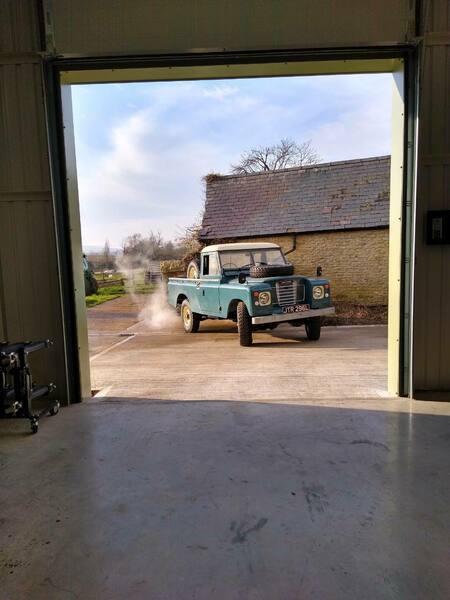

Also been at my rich friend's house helping him move cars around. Have a Series 3 warming up on a January morning.
