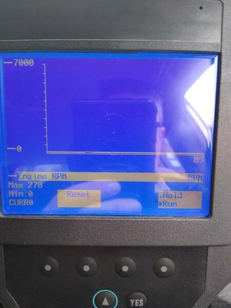

twosmoke300 Posted April 13, 2022 Share Posted April 13, 2022 Need to monitor crank rpm on a scan tool to confirm a crank sensor or it’s just playing parts darts . Link to comment Share on other sites More sharing options...
grogee Posted April 13, 2022 Author Share Posted April 13, 2022 If it pleases the court... I am getting between 260-280 rpm when I turn the starter which sounds about right. Although the stupid tool won't actually display this until after the event because its refresh rate is too slow. Also the tool shows RPM on a 0-7000rpm Y-axis so 300rpm barely registers. And it took a while to get this far because running the tool off car +12v meant the tool died as soon as the starter drew current and dropped voltage. I had to hook up an alternative +12v battery to power the tool. Anyway, you're right @twosmoke300 it's better to check and be sure. twosmoke300 1 Link to comment Share on other sites More sharing options...
twosmoke300 Posted April 13, 2022 Share Posted April 13, 2022 yeh the knock off tech 2 's always reset on cranking Link to comment Share on other sites More sharing options...

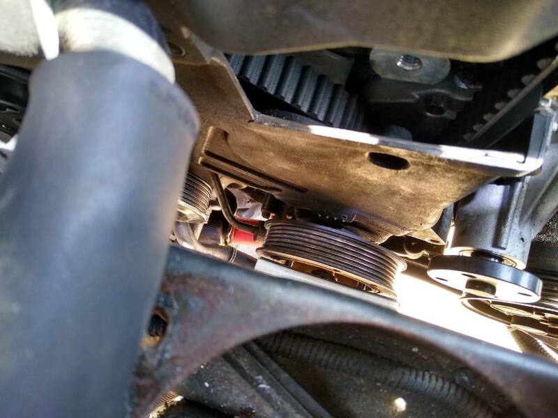

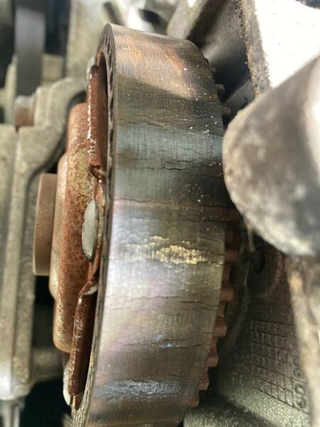

grogee Posted April 15, 2022 Author Share Posted April 15, 2022 After last night's glamour outing at Southam Cricket Club's car gathering, today the Puma is under the knife for timing belt change. I've got man flu so progress is slow but I've got most of the weekend so no point sweating blood over it. Puma forum says there are a couple of ways to lock crank to get pulley off using a 6mm Allen key. The 'proper' way is with the unobtainable special tool. The man on the Puma forum wanted £400 deposit (!) for a borrow of the proper tool. I mean, I know he doesn't want to lose it, but that doesn't feel very friendly, and involves too much risk from my side - how can I be sure I'll get my £400 back? Anyway should be ok especially if the ugga dugga gun gets the bolt out which is apparently done up to eleventy zillion nm according to the forum spods. So far I've just got a few bits and bobs out of the way ready for covers-off. More later if I can be arsed. Sunny Jim, N Dentressangle and AnnoyingPentium 3 Link to comment Share on other sites More sharing options...

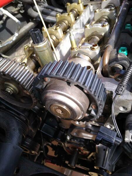

grogee Posted April 16, 2022 Author Share Posted April 16, 2022 Don't get it @twosmoke300 - what's bullseye? Any road, took a brave pill and changed the cam seals (easy) and crank seal (also easy but potential for bork). I think the crank seal was starting to go as there was a thin film of grime in there. All cleaned up now. I've got the crank timing pin in place too. It's all a bit hit and miss because I've bought a generic tool with about three different pins, but found one that fit and the crank web knocks onto it at TDC. Conventional wisdom says you should change the tensioner (£50 part) but I found just the pulley for £20 and I'll re-use the springy bit because the engineer in me says it's working well inside its yield limit and therefore can't wear out. Might give it a squirt of grease for fun. The other job was to 'fix' (glue) the pulley cover because the previous guy screwed into it trying to get pulley off. I definitely* didn't do the same. So next up it's throw it all back together with the new belt. She be reet Rust Collector, Sunny Jim, Shirley Knott and 1 other 4 Link to comment Share on other sites More sharing options...

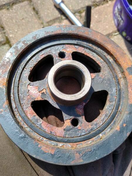

grogee Posted April 17, 2022 Author Share Posted April 17, 2022 Getting there with the Puma. It's all a bit fraught because the cam tool doesn't really lock convincingly (it's too thick) and the TDC timing pin doesn't lock the crank, it only stops it rotating clockwise past TDC. Even then it doesn't 'stop' with enough oomph to do up the crank pulley stretch bolt to 90deg. If I'd tried I would have surely bent the pin and it'd be stuck in the block. So instead I stuffed an Allen key in the flywheel, it wasn't perfect but good enough. I just hope I've not chewed the teeth up. Timing seems good though after a couple of rotations, I'm still showing TDC and correct cam postions so can't really ask for more. Belt tension is ok too. I've started bolting it back up, not a quick job though so I've taken a break and I'll carry on tomorrow morning. Note high tech use of wooden skewer to confirm TDC. rainagain, Back_For_More, Dyslexic Viking and 5 others 8 Link to comment Share on other sites More sharing options...
grogee Posted April 18, 2022 Author Share Posted April 18, 2022 Puma back together. Most of it seemed to go back together without a fight. The PAS pump has to be "asided" for access to belt cover bolts and it's a PITA tucked away at the back of the engine, right near windscreen where the bonnet is very low. Most of it is a PITA due to access really. All I would say is - it didn't really need doing. Belt is fine, no cracks. Tensioner idler was also fine. Last done in 2017 so officially 'due' but probably less than 20,000 miles in that time. Of course you can't know any of this until the parts are off, by which time you might as well change it anyway. But all of the cam belts and tensioners I've changed on all my cars have all been absolutely fine and nowhere near close to failure. Just in case this gives any comfort to those riding the cambelt roulette. Just the rest of the service to finish now - a few filters and check the tyre pressures, that sort of thing. Then probably a blast to Banbury tomorrow. Link to comment Share on other sites More sharing options...
