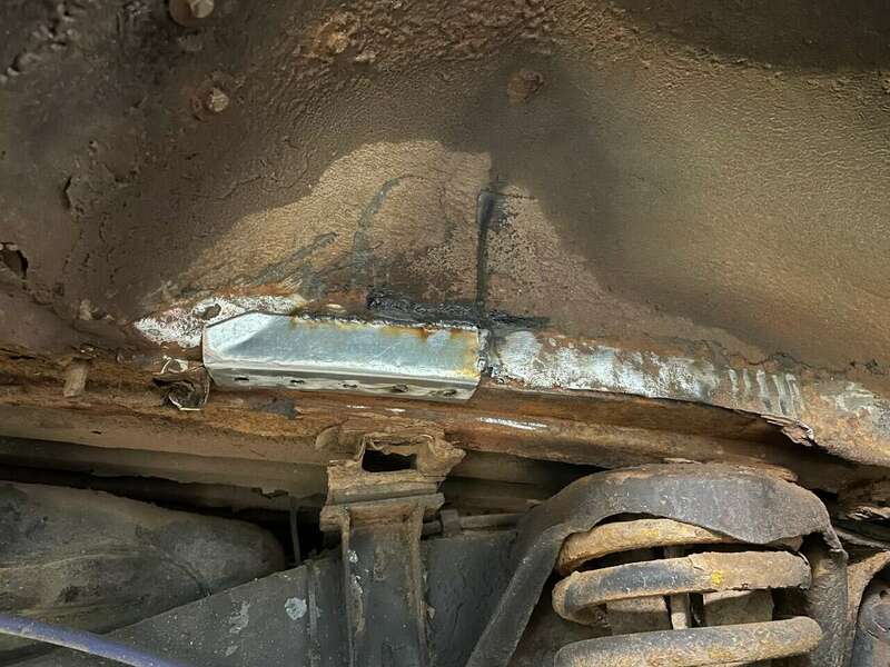

sutty2006 Posted December 11, 2022 Author Share Posted December 11, 2022 It’s that time of year again. MOT next month so thought I’d better get the mig stick and hammer out. first up, body mount offside front that was 3mm thick steel. Had to warm the plate up with the gas axe to get the welder to penetrate. Jenson Velcro, dome, theshadow and 5 others 8 Link to comment Share on other sites More sharing options...

sutty2006 Posted December 11, 2022 Author Share Posted December 11, 2022 3 hours ago, N Dentressangle said: Now that's a garage Luckily it’s not mine. It’s the end bay at work. Proper dump for a Mercedes main dealer. Boss is nice enough to let me use the workshop for the annual weldathon. This needs addressing. Drivers door seal lip. Gone. yep. Floors fucked too. Meh. bringing back the lip… she fits. Coated it in chassis paint before leaving. This was the third pile of rust/mud/crap I swept up. It just kept coming! theshadow, Saabnut, Tickman and 3 others 6 Link to comment Share on other sites More sharing options...
N Dentressangle Posted December 11, 2022 Share Posted December 11, 2022 Nice work. Disco rot is a never ending work in progress, but at least it's all weldable with plenty of repair panels for the trickier bits. A properly sustainable car! 😉 Link to comment Share on other sites More sharing options...
