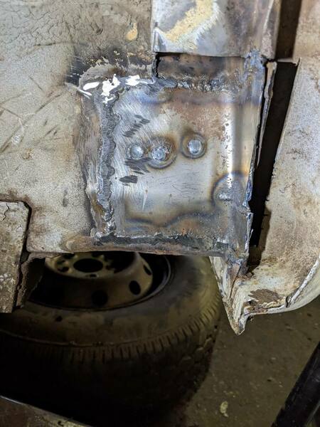

Tepper Posted December 6, 2021 Author Share Posted December 6, 2021 Unfortunately I didn't have any GPO Commer vans, washing machines or other sources of nice flat sheet kicking about, so I had to go all fancy and actually buy some sheet metal. Welding happened, ft. Safety Trainer: The welds somehow look worse in the picture than in real life, they're not actually too bad. Either way, for those expecting #weldporn - sorry to disappoint. Less hole, more metal: It took me bloody ages to shape that panel, I wish I had a roller and/or a folder. It doesn't help that Citroen decided a compound curve was needed on the right, so even after I had the overall curve and folds of the panel right I had to cut and shut it a bit to get it to fit. Probably would've been better off just buying the panel, but where's the fun in that? Just got this piece left to weld in, I was almost ready to weld but I ran out of time. Eagle eyed readers will observe that it's tacked, but I realised I still needed to grind the paint off and fettle it a bit more before it goes on properly: Coming along slowly. I'm hoping the sill will be quicker, but we'll see. I'm also trying to work to a standard, at the end of the day it's an old van - it doesn't have to be perfect. If the rust is properly cut out, all repairs are butt welded and it gets decent rust proofing/paint afterwards that'll do me. Even that takes plenty of time, but it doesn't matter if it's not bang on cosmetically. Fabergé Greggs, iainrcz, juular and 33 others 35 1 Link to comment Share on other sites More sharing options...

Minimad5 Posted December 6, 2021 Share Posted December 6, 2021 Brilliant welding and tin bashing 👍 tooSavvy, Tepper and Dan_ZTT 2 1 Link to comment Share on other sites More sharing options...
