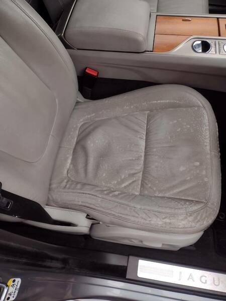

groovylee Posted November 15, 2021 Author Share Posted November 15, 2021 Been busy on this today. There's no spare wheel or tool kit, so ordered one from evilbay. Someone had triggered the misfuelling flap thing, so I dug out YouTube info and reset that, and then gave everything a damn good clean and lube. Sooo much nicer in there now, it really was grim. mk2_craig, DVee8, Sunny Jim and 5 others 8 Link to comment Share on other sites More sharing options...

Cento16v Posted November 15, 2021 Share Posted November 15, 2021 Shouldn't be smoky unless someone has removed the DPF! Make sure cambelt has been done and check the oil dilution if you have a diag computer, if not and you don't know when last oil change was, get it done. Seats have come up well 👍 Before you refurb wheels have a look on ebay, loads of cheap sets seem to come up, with decent tyres as well! groovylee 1 Link to comment Share on other sites More sharing options...
