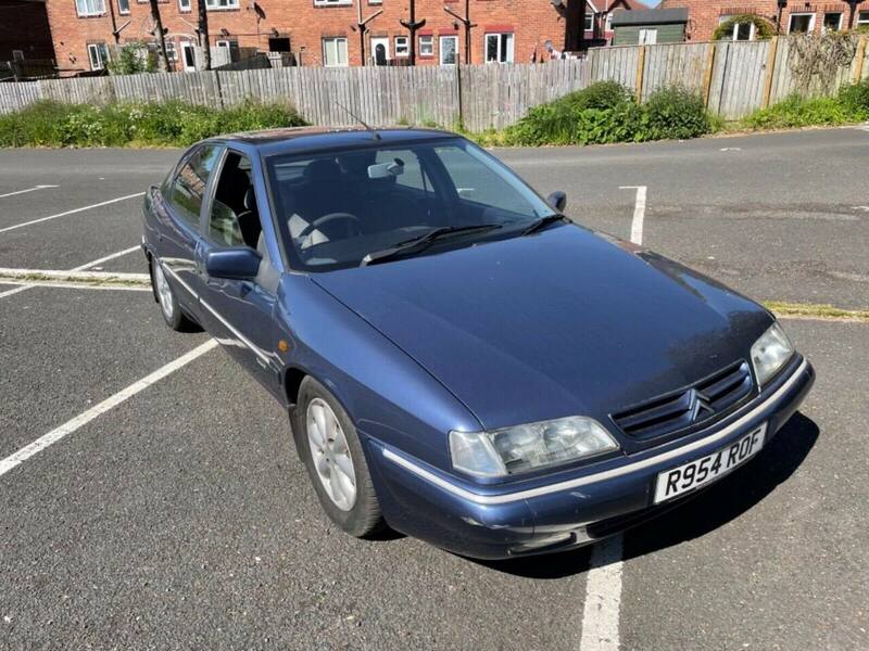

Dr_Slow Posted October 29, 2021 Share Posted October 29, 2021 2 minutes ago, sierraman said: I’d have thought the spec would be immaterial for £800, the fact you’d found one that was still a going concern would be a bonus. I don’t think I’ve seen one on the road for about 10 years. There's an auto for sale in the North East (nothing to do with me, though) for a bag, so maybe within haggling distance of your price @maxxo since it looks a bit rough round the edges? https://www.ebay.co.uk/itm/265357806498?hash=item3dc88ecba2:g:jbsAAOSwGr1gtg1l beko1987 and loserone 2 Link to comment Share on other sites More sharing options...
sierraman Posted October 29, 2021 Share Posted October 29, 2021 I’d be fairly certain if you turned up with £800 cash it would be yours. Fumbler 1 Link to comment Share on other sites More sharing options...

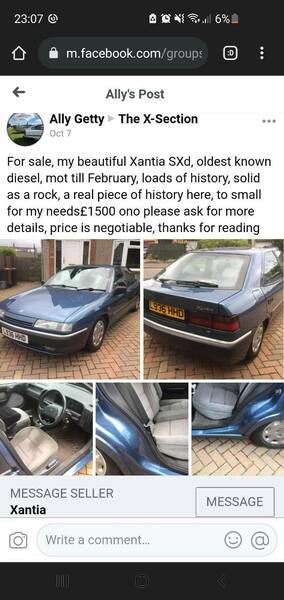

wesacosa Posted October 29, 2021 Share Posted October 29, 2021 bit higher price than you are looking at, but looks good Link to comment Share on other sites More sharing options...

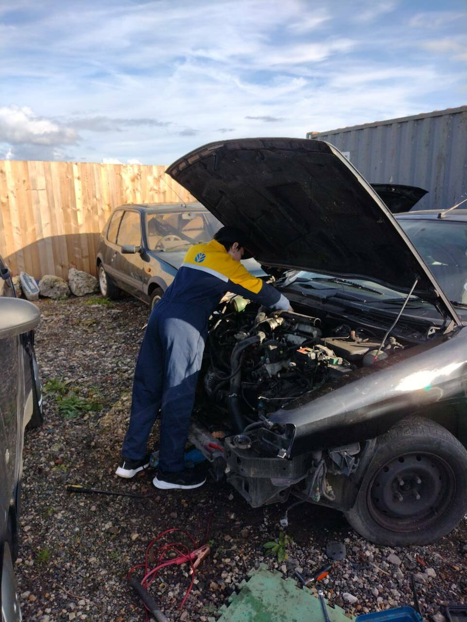

Arthur Foxhake Posted November 1, 2021 Share Posted November 1, 2021 Here's my son, ripping the engine out of one here. beko1987 1 Link to comment Share on other sites More sharing options...
