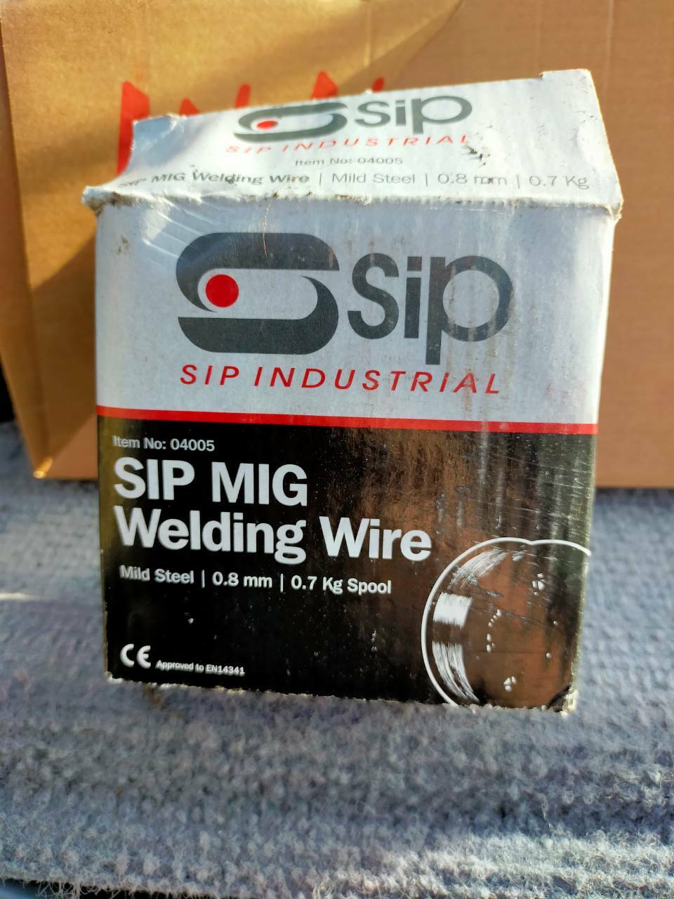

DoctorRetro Posted November 7, 2021 Author Share Posted November 7, 2021 Ok, now I'm confused. Here's the original reel that came with the welder. Here's the box off the new reel. Dobloseven 1 Link to comment Share on other sites More sharing options...
Dobloseven Posted November 7, 2021 Share Posted November 7, 2021 I'm confused as well. I've always used .6 wire for thin stuff like car bodies.I've got.8 wire and tips but keep it for thick stuff. If you're putting. 8 wire down a.9 tip, then that's not good. Whatever you were doing before seemed ok though. DoctorRetro 1 Link to comment Share on other sites More sharing options...
juular Posted November 7, 2021 Share Posted November 7, 2021 Seems like you may have been welding using gas on gasless wire. Turned out well in that case. Good job! Get some 0.8mm tips (they're cheap) and reap the benefits of welding with gas, it's way nicer. If you can return that and get 0.6 wire and tips, even better. DoctorRetro 1 Link to comment Share on other sites More sharing options...
DoctorRetro Posted November 7, 2021 Author Share Posted November 7, 2021 21 minutes ago, juular said: get 0.6 wire and tips Stupid question, but how does the tip come off? Link to comment Share on other sites More sharing options...
Dobloseven Posted November 7, 2021 Share Posted November 7, 2021 17 minutes ago, DoctorRetro said: Stupid question, but how does the tip come off? They unscrew. There seem to be at least two types of tip. The smaller "hobby" size and the larger "professional" type. Both seem to be readily available from the likes of Machine Mart etc.Halfords used to sell them as well. Didn't realise. .9 ones were available though. Link to comment Share on other sites More sharing options...
GingerNuttz Posted November 7, 2021 Share Posted November 7, 2021 Using no gas wire and gas is just like running dual shield so it'll be absolutely fine albeit a waste of gas. 0.8 wire is what I use for everything from 0.8mm to 8mm steel and it's been absolutely fine. Angrydicky, DoctorRetro and LightBulbFun 3 Link to comment Share on other sites More sharing options...
