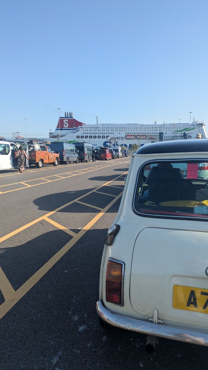

Today begins the prep work for my mighty trip to Poland in my Mini for International Mini Meet 2026.
It's looking nice weather (read: too hot) all week so I've packed plenty of fluids, to go with spares and tools. I've packed the all important headgaskets and everything I need to change one too 😅
Plus it's rammed full of camping gear for the stay at the other end. I even gave her a quick hose down
It's nearly 900 miles to our designation. Easy in something modern. Less so in something old. The intention is to drive over to Harwich tomorrow morning, take the day ferry to Hook, then we're stopping in Amsterdam for two days. On Wednesday we head for Berlin for an overnight stop before heading to Leszno in Poland on Thursday. Then Friday we are planning to enjoy the show and sights. Saturday we will leave around lunch and will be our longest drive at 450 miles in a day heading to Osnabruck in Germany, before getting the afternoon ferry from Hook on Sunday to hopefully arrive home Sunday evening.
Ill keep the road trip updated as we go. I'm sure you'll all be looking forward to me doing a headgasket on the side of the autobahn 😅
