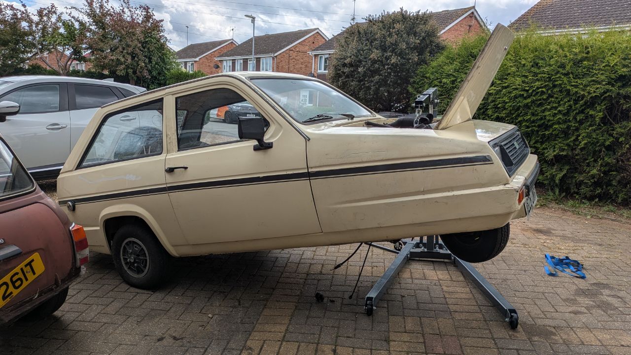

Shame there's no pictures of how I lifted the robin up when removing the engine....
I was too busy scrabbling round trying to drag the engine out before you dropped the car on my head!
I've got 3 approx 14 foot scaffolding poles, clamped together at the top, with a couple of braces across and a chain hoist, ideal for that sort of thing. Lifted the posts for my lift into place no problem, and it took 5 people to get them individually onto my trailer 😱
I just picked it up on my own 😂

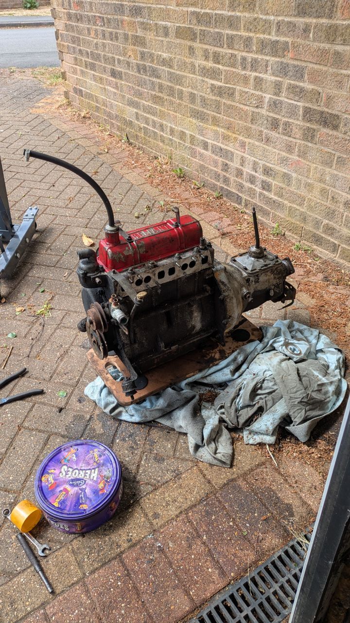

After purchasing my new* engine I spent some time over this weekend prepping and fitting it.
First off I needed to transfer some bit's over from the old engine and reattach the gearbox. I also took the opportunity to set the tappets as it's much easier out the car and then I fitted new engine mounts and also changed the thrust bearing which is carbon and wears away.
The thrust bearing should be raised like the one on the right...

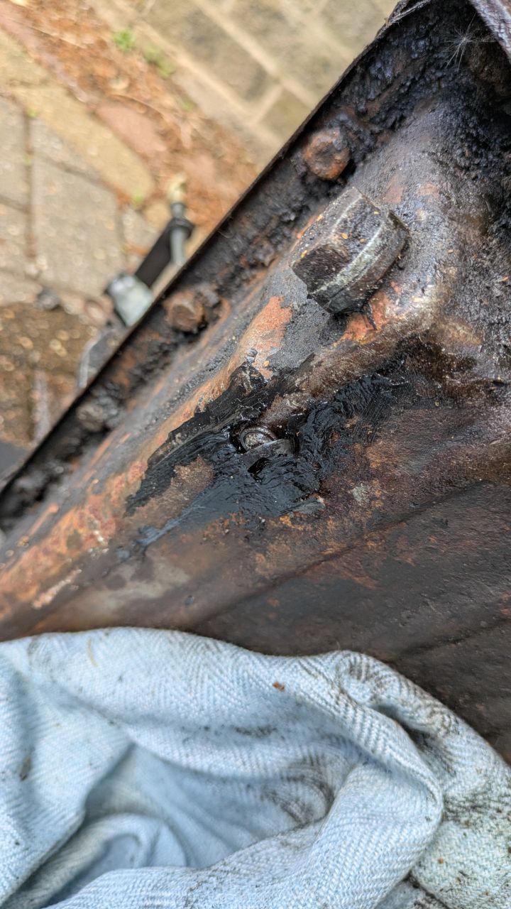

While prepping the engine I found some sealant on the sump. Then I found a screw... I will be liberally applying some JB weld to this. I'm not interested in changing a sump at the moment. I drained the oil when I found it as I planned to change it anyway and now I can repair this a bit more permanently

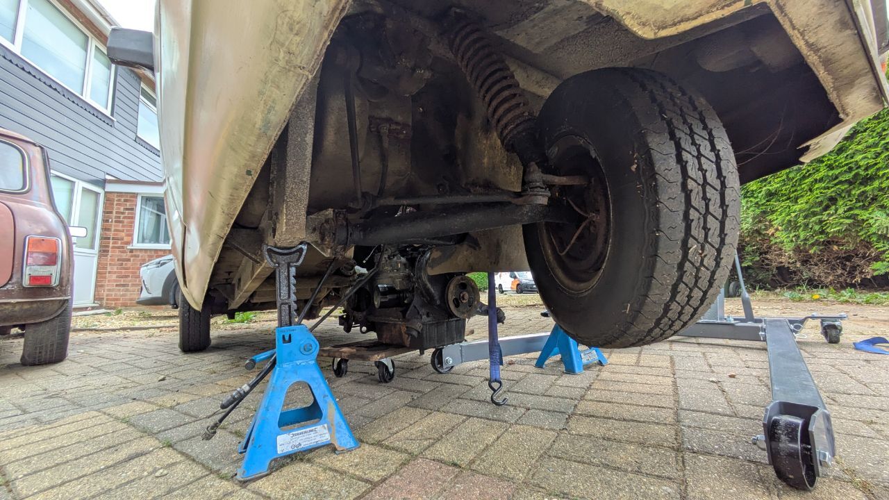

With the engine prepped on the ground it was time to get the thing back in.

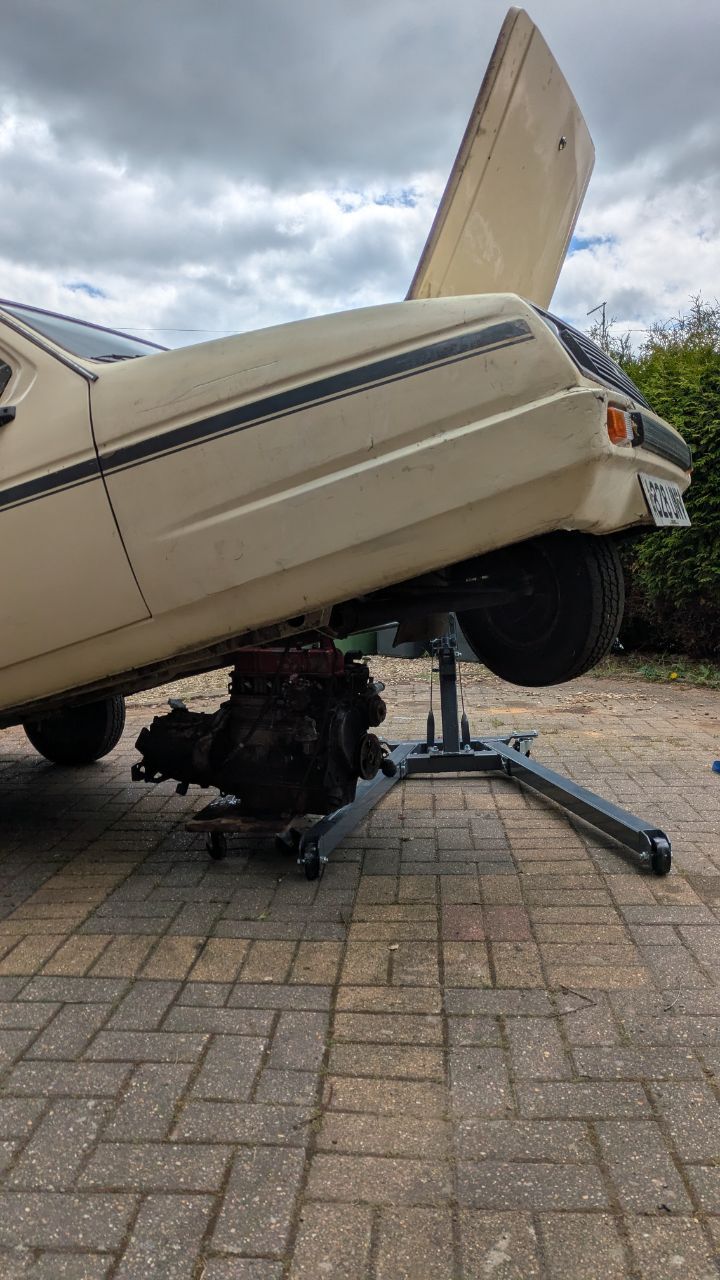

Firstly lift the car 4ft in the air using an engine crane and a lifting strap round the chassis. This definitely* wasn't* dangerous...
Then slide an engine underneath..
Drop the car back down onto axle stands then strap the engine to the crane
Safely* lift the engine from the front and then the rear so you can slot the engine mounts in place
Finally bolt the engine down! I also reinstalled the prop shaft bolts. Nothing quite makes you question your life choices like doing up fiddly bolts you can only turn a flat at a time while dirt rains into your eyes...
There's a lot left to do but the engine is now back in!
I've got to install a new clutch cable, the starter, alternator, radiator, exhaust manifold and downpipe, inlet and carb, and the dizzy. Then the fuel lines and wiring and then hope it starts!

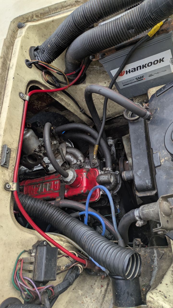

I also started to reassemble my engine in the Reliant. Radiator, alternator, manifolds and carb are back on. I still need to do the starter, clutch cable, hoses and then sort the sump.

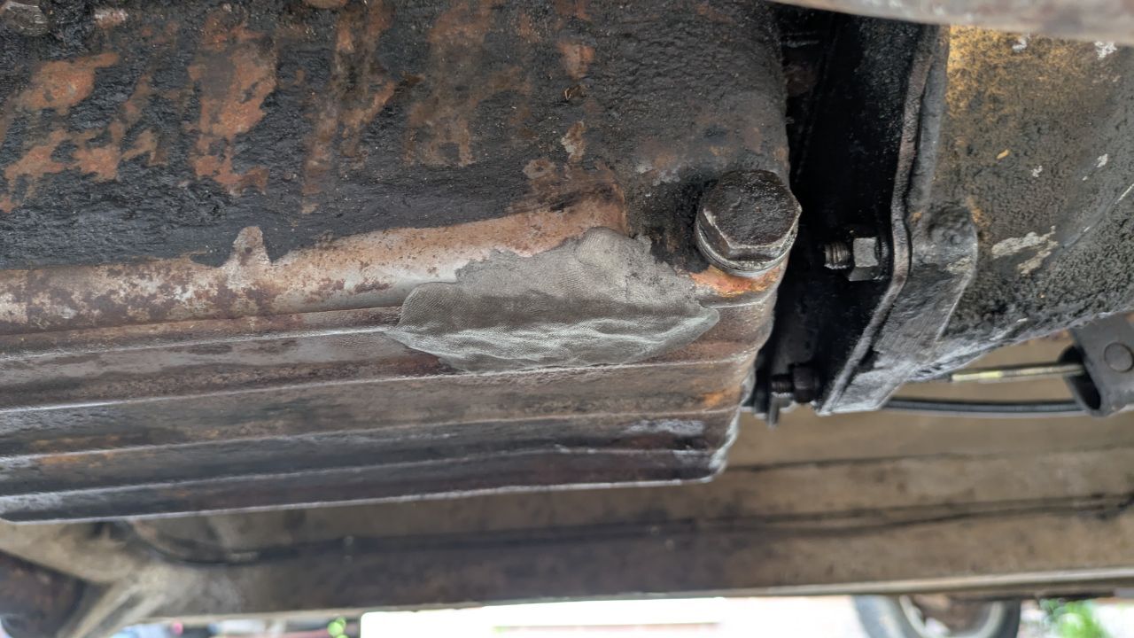

Speaking of my new sump* arrived too...
Nearly there with my Reliant. The engine is back together and full of coolant. No leaks which is a good start.
I had to fit my new clutch cable which involved drilling out the old one. Never had to drill out a clutch cable before but they're riveted into the fibreglass.
Rather than rivet it back in I chose to bolt it. Partially because I don't have any rivets long enough to go through the body but also maybe because I accidentally ovaled the holes removing the old one...
Prufeschonal job installing the clutch arm. Apparently these have a return spring to stop the carbon washer wearing down. Mine didn't have that which might explain the wear. Temporarily* fitted a Mini return spring with some expertly* fitted cable ties. I will buy a proper spring as they're only a few pounds.
I also fitted my new* sump

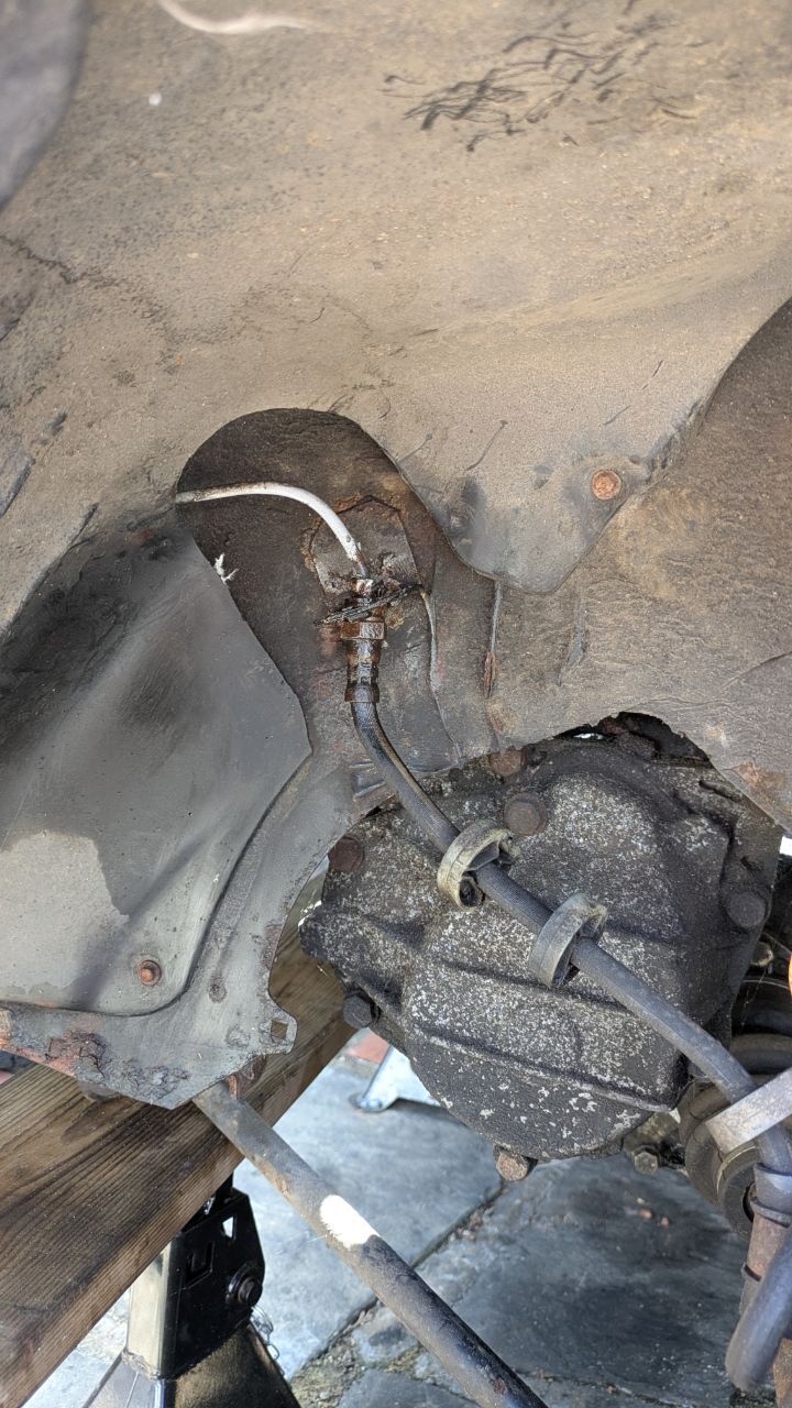

I will be changing brake lines upon arrival like all good collection capers involve.

Currently sorting brakes out with a new line
Shiny new line
Apologies for being a terrible seller. Not only did you have to come down and fix the brake pipe in this bloody heat but I didn't get a chance to stick some petrol in it, and for some reason it was running rough when we eventually started it up despite running fine when I put it on the drive 2 weeks ago to "sort out" the brakes

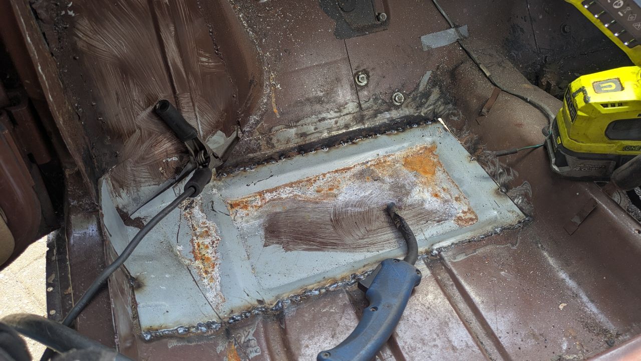

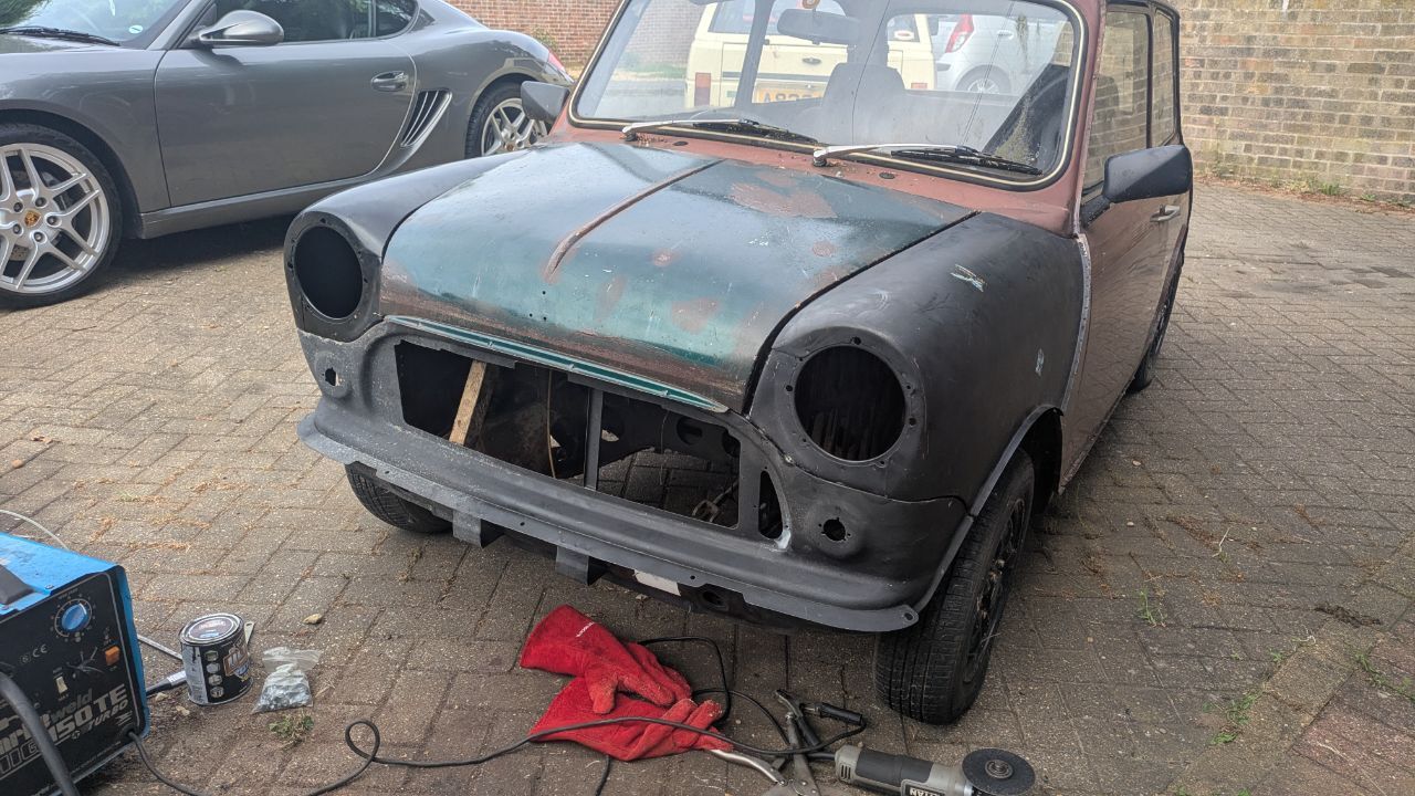

With a new car on the drive it seemed only right I completely ignore it and get back to work on my brown Mini. Today I fitted it's face. Wings and front panel welded on.
Decent closing gaps all round. I will use a bit of seam putty on these to just ensure I don't get any water trapped.
I also finished off the passenger floor that I started way too long ago...
And finished it off in a lovely coat of more brown hammerite
And lastly welded up the aerial hole in the roof
Next up I have to tackle the rear floors and butchered seat base and companion bin. I have a large off cut from another Mini to help repair most of that
