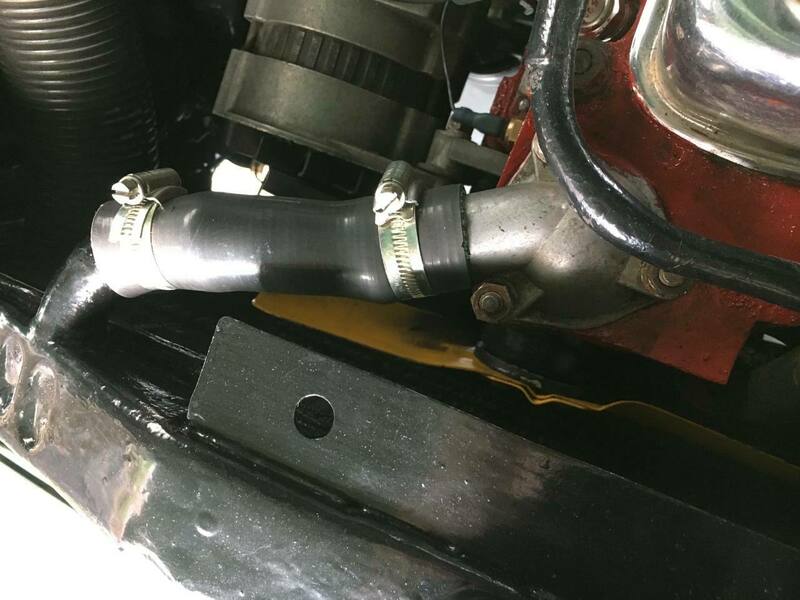

mrbenn Posted July 26, 2021 Share Posted July 26, 2021 You'll need the more curved housing for the 1275 with standard Minor radiator. Pictured is my Minor 1000 with 1275 engine and curved thermostat housing, but standard 1098 top hose and radiator. Apologies if a thousand other people have already mentioned it but it looks to me like your oil pressure and ignition lights are swapped. The ignition light looks to go out roughly as the pressure gauge wakes up, while the oil pressure light matches ammeter behaviour (with possibly slightly lazy alternator). mercedade, GMcD, Joey spud and 3 others 6 Link to comment Share on other sites More sharing options...
