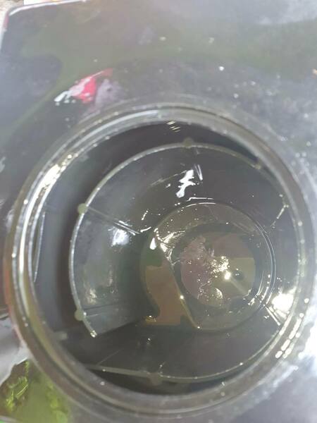

wesacosa Posted May 16, 2021 Author Share Posted May 16, 2021 The Jam may have had a pocket full of Pretty Green, but the XM had a tank full of not so Pretty Green  As most of the LHM had leaked out through the Doseur valve seal the stuff I syringed out before removing the tank looked ok, but the stuff in the bottom of the tank did not. Nor did the white filter or this little disc (which I think is for the level float  The Haynes suggests cleaning the tank out with rags but its pretty heavily baffled so I suspect I will just have to swill it out with Petrol I did manage to get the tank out without having to disturb the hoses thankfully rob88h and The Moog 2 Link to comment Share on other sites More sharing options...

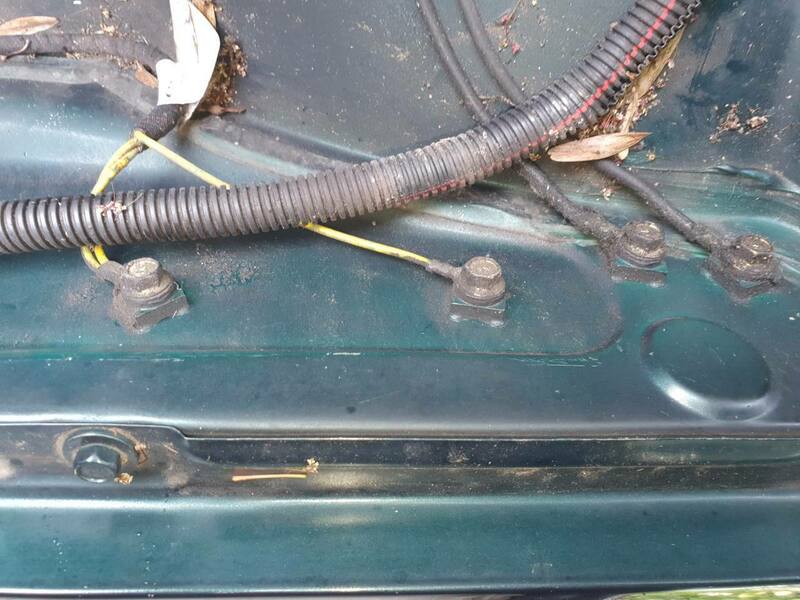

wesacosa Posted May 16, 2021 Author Share Posted May 16, 2021 There is supposed to be a second filter but I think thats clipped into the centre unit currently sat in that Vimto bottle so I will have to investigate EDIT: The second cone shaped filter located and its even more grim Whilst the Airbox is out I will take a look at that little green ABS relay and clean up those earths, and hope they are the cause of my ABS light not going out Link to comment Share on other sites More sharing options...
jonathan_dyane Posted May 16, 2021 Share Posted May 16, 2021 Ugh it’s a long time since she’s had a LHM change! If possible probably worth bleeding it through the brakes too Link to comment Share on other sites More sharing options...
wesacosa Posted May 16, 2021 Author Share Posted May 16, 2021 5 minutes ago, jonathan_dyane said: Ugh it’s a long time since she’s had a LHM change! If possible probably worth bleeding it through the brakes too yeah looks like it. Annoyingly the little clip which hold the filter in seems to be missing. hoping it might be stuck in the sludge in the tank. think I will have to try bleeding the brakes given the state of the fluid but I read they can be a bit of a pain Link to comment Share on other sites More sharing options...
jonathan_dyane Posted May 16, 2021 Share Posted May 16, 2021 Bleeding the brakes is easier than any other car (engine running wedge down brake pedal with suspension on high and crack open each nipple in turn) as long as the nipples undo wesacosa 1 Link to comment Share on other sites More sharing options...
wesacosa Posted May 16, 2021 Author Share Posted May 16, 2021 40 minutes ago, jonathan_dyane said: Bleeding the brakes is easier than any other car (engine running wedge down brake pedal with suspension on high and crack open each nipple in turn) as long as the nipples undo yeah that was my worry. I am guessing they may not have been opened for a while! Link to comment Share on other sites More sharing options...

beko1987 Posted May 19, 2021 Share Posted May 19, 2021 I remember bleeding my brakes through on my old XM. The satisfaction was off the scale as muddy shit came out, then some air then fresh green blood. Made zero difference to the braking but it felt good to do! The whole back end of the hydro cars is a dead end so pull a good bit of fresh fluid through. Keep the front window open to hear the low level beep then top up and carry on wesacosa 1 Link to comment Share on other sites More sharing options...
