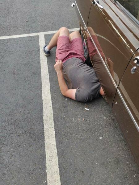

A bloke has just turned up in a Healey who happened to have some fuel line with him. He is currently seeing if there's anything he can do with it. I was quite happy to wait for the big yellow bus to be fair as I didn't bring much in the way of tools or kit.
  • Sad 1
Home safe and sound. The legend in the picture above had some spare fuel hose (in his rather beastly modified Healy 3000) and managed to seal up the leak for now.

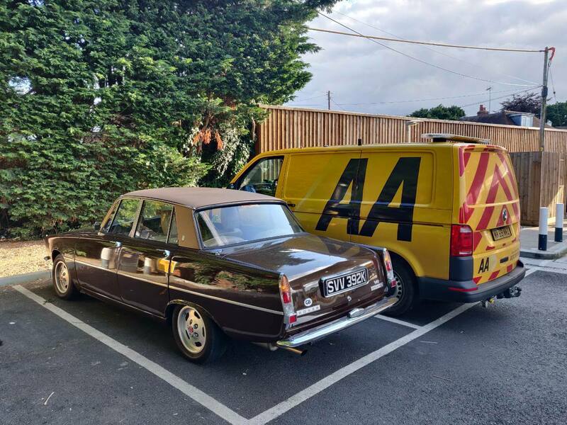

For posterity, have this picture of the AA van I coincidentally parked next to after limping it to a petrol station. Not impressed with the AA (who I am now breakdown covered with) tonight, the van man just had a look, said he can't do anything unless I log a job, which I duly did, then he drove off. AA app then throws a hissy fit because the MOT is expired (yes, I know this problem would probably have been caught on an MOT), so I ring them instead. 25 minutes on hold then their end drops the call.

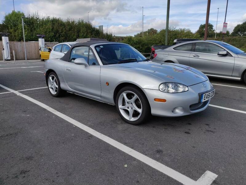

Dad and I are off to somewhere near Skegvegas today to look at a new handbagcar. If it comes home with me I will update later.
I've bought a car.
The BBMF gave me a flypast to celebrate!
3 hours ago, Crackers said:
Y'ever wake up and think to yourself, "I fancy another car?"
Most days M9
 Wishing you the best of British with the collection run home!
Amazingly, the petrol station up the road from the sellers house had no queue. Result!
Where lieth this miraculous wonder of a fuel vendor? Tiddler looks good, low milez and a pretty good MOT history too, but I wonder where the corrosion went?
Excellent choice! MX5s are awesome.
