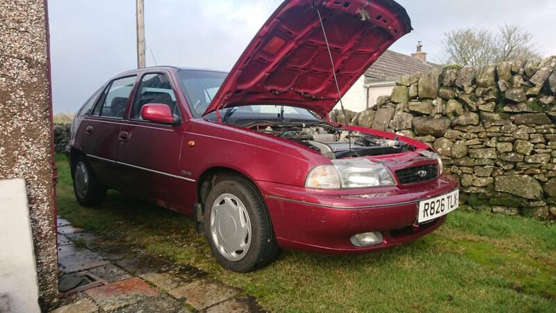

Daewoo must of realised I was paid yesterday.
Alternator helpfully decided to not make electricity. It's also way different to the Vauxhall ones I have in stock.
Fudge!
So this evenings fun will be trawling eBay for the cheapest new one I can find.
I've said it elsewhere, but might be worth calling Mike at Just alternators and starter motors? www.jasm.co.uk
£45-£65 for full refurb
Oh.
I'd actually given that fella a shout if I had checked in sooner. But it's handy to know that there is someone still refurbing stuff yet.
Found one on eBay for £69 delivered for a new unit.
I now have a new alternator for the Nexia. Arrived a day early too!
Branded as  bosch exchange job too. But no need to send a unit back though. Ideal!

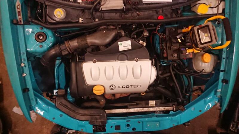

Sometimes just sticking in another 1.0 is the way to go. Gets the car up and running again and quickly. Engine swaps, can end up being a massive pain, that sometimes isn't worth it.
That said. The 1800 swap was very straightforward in terms of physically fitting. The original mounts, shafts and rad were swapped straight over from the 1.2 8v and anything else was easily available from other Vauxhalls. I side stepped the wiring by going to Gremlin Motorsport on FB and reused the start and charge loom from the original engine. Biggest pain was the fuel system. The X18XE1 uses a returnless fuel system I got around that by using a EFi Bypass fuel regulator.
nice job on the corsa, as a fellow vaux licker, ive done my fare share of engine cnversions. best one i did was a 23k mile sport with a c20xe and wide ratio box, used the stock airbox, a/c and pas etc and it looked factory.   i also did a c18xe for a lad with a daewoo box that seemed to have close ratios for 1,2,3 and a wide 5th. that was a fun car.
currently have a rio verde  gsi rep c14se auto sat here awaiting a b204 conversion.

Threw said new alternator at Nexia.
It now provides electricity again.
I did the yay!
Crap thumbs up pic.
*I'll be keeping an eye on the voltage too.*
