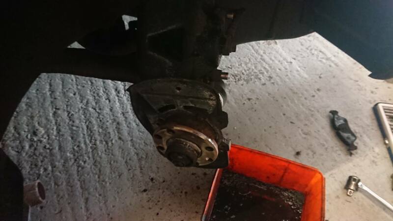

JMotor Posted April 17, 2021 Author Share Posted April 17, 2021 Did purchases. Because I was overthinking an issue. Was about ready to replace the wheels on the 306 due to an wobble at speed. Dawned on me. Had I actually bothered to properly look to see if it was just the wheels? Straight away found the drivers rear wheel bearing was actually knackered. Well that won't help the job. Also good opportunity to fit a pair of new dustshields too. Ended up getting full rear hub kits and genuine dustshields. 406 is coming along nicely too. Just need to replace the dry rotted tyres and we are hopefully ready to chance a test on it. Gave it a wash too! loserone, Split_Pin, DVee8 and 1 other 4 Link to comment Share on other sites More sharing options...

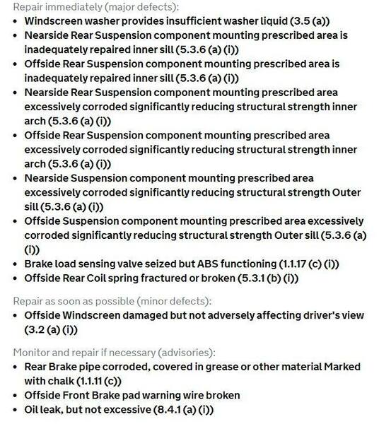

JMotor Posted April 30, 2021 Author Share Posted April 30, 2021 Results are in on the 406... Aw, you durty bastid! I'll have a proper look later. Most of the issues seem to be some grot on the sills (typical 406 issue) and wonder how seized that valve is? Bridging the thing should of been the smart choice. Isopon 1 Link to comment Share on other sites More sharing options...
JMotor Posted May 1, 2021 Author Share Posted May 1, 2021 Right! Whip the 406 into the workshop. Tackle the jobs with aplomb! So tackle the hardest job first. Then everything else is easy! Right!? WRONG! As you can see. It's never a just a small hole. Then the extent of the grot didn't stop there. It's had your typical MOT welding repairs. Slap tin over the shit and tack on and cover with industry standard underseal. Even the near 2mm thick plate for the Jacking point was but a memory now. Gad damn it! Didn't even bother investigating the passenger side. As its the exact same. Soundwave, crad and Split_Pin 3 Link to comment Share on other sites More sharing options...

JMotor Posted May 4, 2021 Author Share Posted May 4, 2021 Back onto the 306. Discovered the front passenger wheel bearing was buggered. I had previously checked this a while back, due to my earlier mentioned wheel wobble issue. Couldn't find any play in it. So left it at that. Until I spun the wheel when checking again. It was very grumbly. To save immobilising the car. I got another hub and changed the bearing in it. Changed the hub over and much better now. A quick test drive later reminded me how much fun they were to drive. Still a couple of niggles and the mismatched painted wheels needs sorting out. But that'll come in time. Twiggy 1 Link to comment Share on other sites More sharing options...

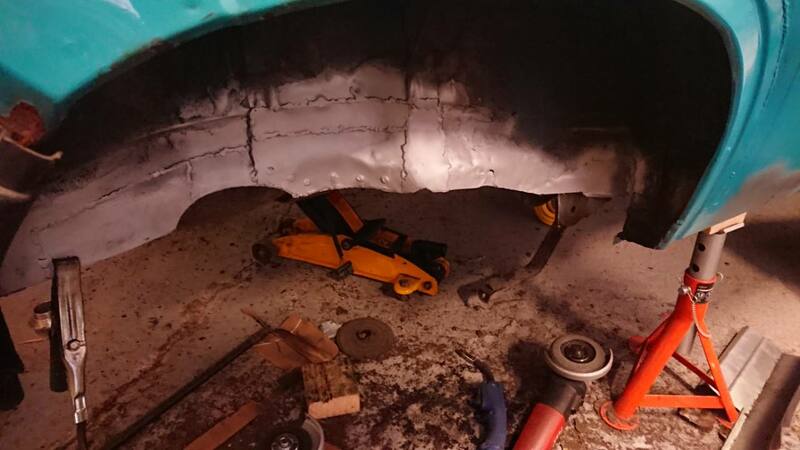

JMotor Posted May 16, 2021 Author Share Posted May 16, 2021 Och! Having more than one project is a ballache!! Spotted a small hole, behind the rear shocker on the Corsa. Ugh! It's never "just" a small hole is it!? Rear axle, fuel tank and filler neck out. Brake pipes? Tin snips through the whoores! Spinny wire wheel of pure bastard put to work. Then the Spinny discy pile of bastard afterwards. Hmmm.... OK, that's not totally horrible. So. One new piece of steel let in. Bashed fuck out of the steel to make it. Now! Let's sort out that flange on the chassis leg! Due to the shapes. I went for small patches. Then cut more of the strut tower out. Then left it at that. With a splash of weld thru just to give the fresh steel a coat of something. I'll have another go at it next weekend. Split_Pin, Ian_Fearn, Fumbler and 2 others 5 Link to comment Share on other sites More sharing options...

JMotor Posted May 16, 2021 Author Share Posted May 16, 2021 Thanks 🙂. Yeah, it's best left alone if you can. But it's no wonder to why it rots out when you get dug into it. That area is about two to three layers of steel in places. With those plates only being spot welded. Twenty years of mud and moisture just makes a mess. Split_Pin 1 Link to comment Share on other sites More sharing options...
Split_Pin Posted May 16, 2021 Share Posted May 16, 2021 Never thought I'd say it, but its a shitty Vauxhall trait, as you know. Double or triple seams just fatten up and self destruct. All mine did this at some point. Although there's some surface rust under the 75, the seams have remained watertight so a quick rub down and vactan saw it good. I'm well tired of it! JMotor 1 Link to comment Share on other sites More sharing options...
JMotor Posted June 10, 2021 Author Share Posted June 10, 2021 Hadn't been at the Corsa for a little while. Typical finding other things to do. But when I felt like it, I just did a little bit at a time. Yes, it's not pretty. But I wanted strength over some weld pRon. Quick tickle with the flappy disc and it looks more presentable. Then a quick dust of weld thru just to give the lot a coat over. I still have to finish this. Then put another layer over to get it back to what GM had done. Split_Pin 1 Link to comment Share on other sites More sharing options...

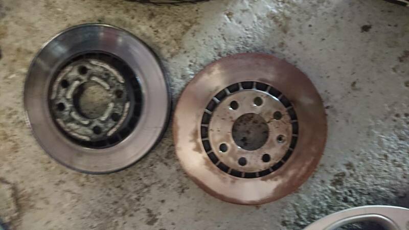

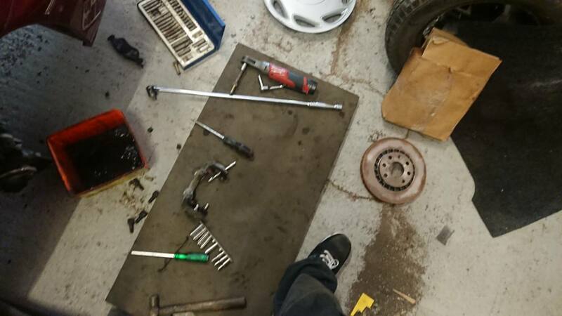

JMotor Posted June 12, 2021 Author Share Posted June 12, 2021 Holy moly! I actually got some jobs done on the Woo. New rotor arm and dizzy cap has actually returned some useful get up and go. It was the original parts I pulled off! So not bad for being on since 1997! Then on with some front brakes. Even think they were the original ones too. Reason the new disc is rusty, it's due to me buying new old stock GM/Vauxhall gear. Bit of roost ain't gonna bother me. Was surprised to find out these Twin cam Nexias run the same brakes as the bigger engined Vauxhalls. Or as known in the Vauxhall modifying circles as 'Valver' brakes. The standard choice for upgrading your Corsa or Nova. Back in the day it was near impossible to not find a set in the scrappies. They still give some decent pedal feel, will still stop you quite quickly and mostly..... They're cheap for pads and discs! Brand new GM brand pads and discs came in about £35 delivered. Handy when three of your fleet has them. Light work was made of the job. Done that many of them it's near muscle memory now. I couldn't get over how clean this wee car was too! It's still got fucking brake dustshelds for fucks sake!! It even came apart like a much younger car too. Such a joy. Still need to replace some stuff yet. Just service stuff like spark plugs, which after pulling one out. I was more than happy with its light brown colour. Derek at Vice grip was right! You can tell a lot from your engine from how the plugs are. LightBulbFun, DSdriver, Split_Pin and 3 others 6 Link to comment Share on other sites More sharing options...
JMotor Posted June 20, 2021 Author Share Posted June 20, 2021 Back on with the Corsa. The whole length of the arch tub to chassis flange is now soild. Tackling each section one by one has helped. Because I've done a lot of work just in this corner alone. Learned a lot by doing it too. Split_Pin, Sunny Jim, Cord Fourteener and 3 others 6 Link to comment Share on other sites More sharing options...

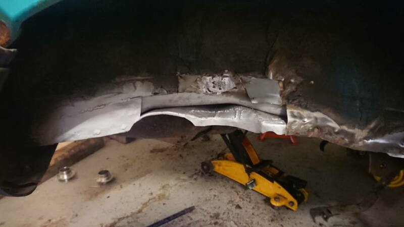

JMotor Posted July 10, 2021 Author Share Posted July 10, 2021 22 hours ago, Split_Pin said: Not enough of these being saved. Funny reading that again after today... I started on the most notorious rust spot on Corsas and Novas. The chassis rail that goes to the TCA (Borrowed a photo of the net to show where I mean and that's mint compared to mine!). It's very crispy on both sides. Ah shit! Also a tricky section to pick out and repair properly. So can see why a lot were squished instead. Or have a really crappy patches thrown on. Have found a repair section. Which is conveniently about the right amount I need to replace. As the rust has pretty much eaten into it all. German eBay saves the day again. Oh a shout to @sutty2006and @domenot sure if it's any use to you guys. But Leidinger tuning on German eBay do some reparaturblech for Mantas. Might already know of them, but I thought it was a mention anyway? Ian_Fearn, Fumbler and dome 3 Link to comment Share on other sites More sharing options...

JMotor Posted July 11, 2021 Author Share Posted July 11, 2021 No problem. Suppose that's the problem. The stuff that is available isn't great. I've had the same issue with my stuff too. Had a sill panel which looked like what I needed. But the quality was horrible. Klokkerholm stuff is like that too, some really good quality stuff and some utter garbage. The Astra I've bought genuine panels for it. Because of those reasons. Link to comment Share on other sites More sharing options...

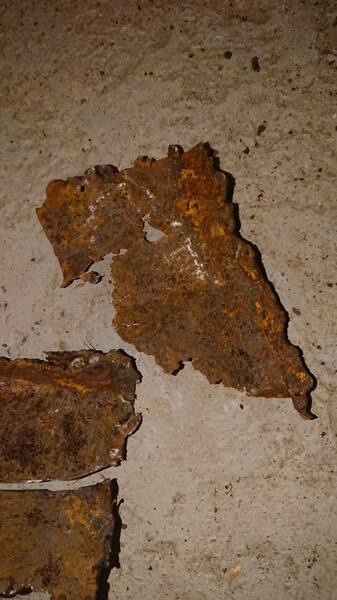

JMotor Posted July 11, 2021 Author Share Posted July 11, 2021 Got photos of what that section looked like. 😰 I *love* rust! This had some crap patches slapped over. Hmmmmm, crispy! Also those welds hadn't stuck at all. Two minutes with an air chisel had it off. Still don't mind continuing on. As it's all time with the welder. Link to comment Share on other sites More sharing options...
