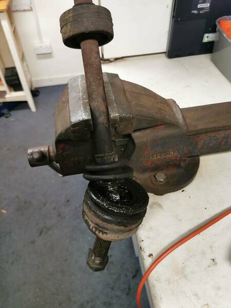

Whilst it was in bits, and I had the free spares, it made sense to do the nearside shaft too - this turned out to be a wise move, as the boot was held on with tywraps instead of the standard metal clip, which had allowed dirt to get in underneath the boot and contaminate the grease!

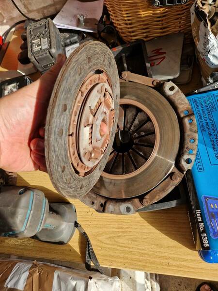

Once removed, there was clear evidence of overheating - probably from the Silverstone fiasco!
IMG_20231017_113424.thumb.jpg.ba22b98608b2c0f326e8b1cd212071e6.jpgIMG_20231017_113428.thumb.jpg.eefed18c0edd7f2beb90fecc768e27d8.jpg
The friction plate itself seemed to have plenty of meat - Vernier calipers deployted and confirmed 7mm of plate thickness - the replacement one only has 1mm more on it! Clearly, this wasn't slipping for a lack of friction plate thickness.
The flywheel itself was removed for a check - there were signs of crazing on the surface, but on the whole, it seemed fine, so it was cleaned up with IPA and popped on the pile of bits to refit,

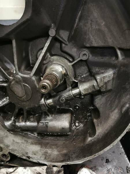

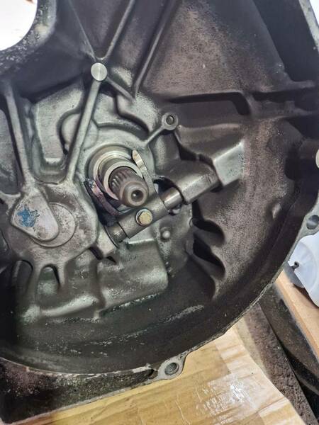

The inside of the gearbox was cleaned up and the release bearing removed. When removing it, I noticed the clutch arm was really stiff. Think I've found another contributory factor to the whole thing not working.
Took it out, and wouldn't you know? The shaft was heavily corroded:
IMG_20231017_151851.thumb.jpg.ec0ce5f5531d12551e664ff3b2673795.jpgIMG_20231017_152108.thumb.jpg.e90a180af473709ef2acf9bdf9f97f0d.jpg
Further inspection highlighted an elongated hole for the clevis pin - yet another factor in the poor clutch operation:

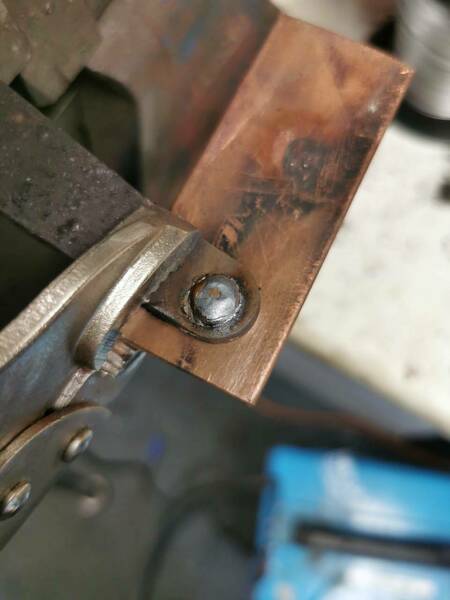

Knowing that I'll never find one of these for sale, it was time to fire up the welder again. I'd measured the diameter of the clevis pin on an unworn section - 7.9mm. I filled the hole with weld, and re-drilled it to 8mm.
IMG_20231017_154352.thumb.jpg.8fa961f2f565ea964f62f88542afe45a.jpgIMG_20231017_155856.thumb.jpg.a56b83035fcd33dd81ddfa832e785bd7.jpg
Quick test with the clevis pin confirmed the fitment was spot on.
The clutch arm was then thoroughly de-corroded, lubricated and refitted - now it operates very smoothly! The release bearing was fitted at the same time.

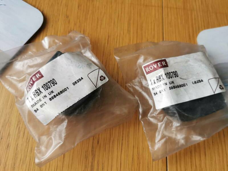

We pick up over a week later - the postie starts bringing treats, such as my Powerflex bushes, and the lower engine mount (not pictured):

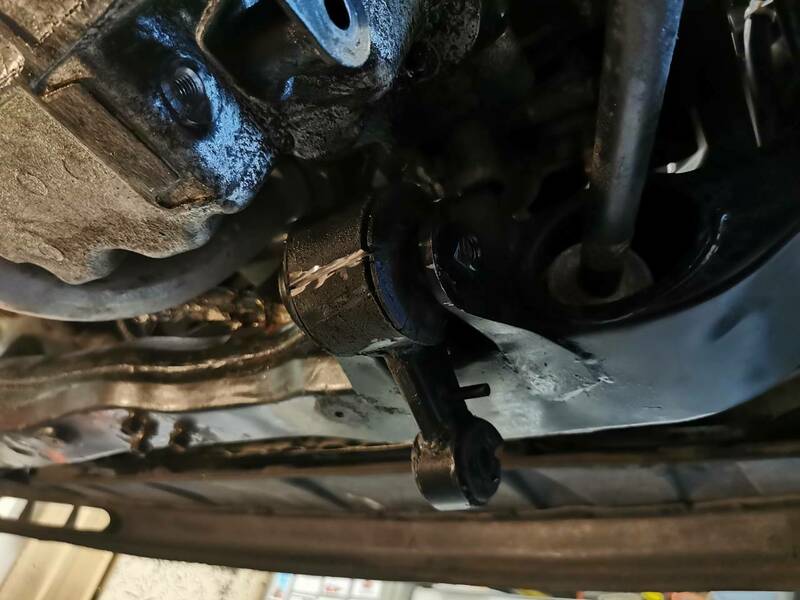

The lower engine steady had the new bushes fitted, and was fitted to the engine, which was now jacked back level and the gearbox mount re-fitted. The gearbox earth lead was cleaned up prior to refitment as well.
The upper engine steady was next - the big bush just popped out, but the bottom one needed a bit more persuasion:

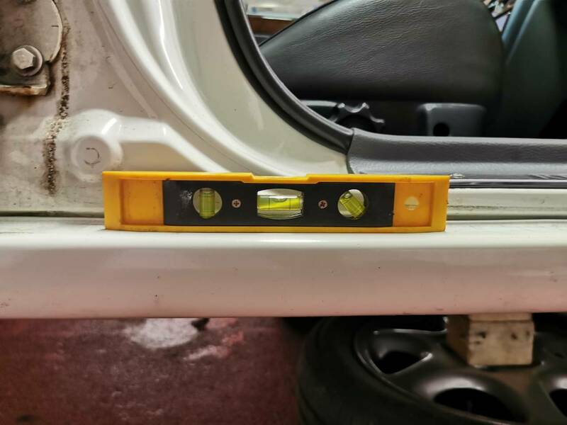

With 2.2 litres in and everything bolted back up, it was time to turn the key and try the gears whilst still on stands. Success! The clutch engaged correctly, and all gears were selectable. Onto another secondary job, namely the washer jets being weak as piss. This was narrowed down to a kinked washer pipe, which was subsequently replaced and the jets re-aligned.
Next, in a move considered pretty silly, I took off the plastic sill covers and inspected the metalwork for grot - always a daft move on a 20+ year old cheap car. However, with the exception of two jacking points showing a bit of surface rust, it was in really good condition! Whilst underneath, I took the opportunity to rustproof some more exposed areas with Dynax corrosion preventative.
The following day, the wheels were bolted back on, and the car reversed out in the pissing rain, so far, so good!

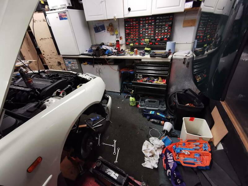

So with that waiting, it was onto the Laguna. The garage was emptied of the Beat and Mazda now all the stormy weather had passed.
I photocopied the Haynes wiring diagram and got my head wrapped around it. Never seen a heater resistor unit contain two relays. One is to send power ultimately to the fan speed switch/to the second relay contacts, and the second relay is energised when the fan speed is set to max.
All fuses and power supply lines were checked - no issues were found. Not surprising, as it had suddenly decided to start working properly the day before.
The fan itself was removed and checked for obstructions etc - no issues found, and bearings lubricated and exercised whilst I was there.
Eventually, some overheating had been observed on line A3 of the heater resistor unit - this is one of the main power supply lines.
image.thumb.jpeg.dc2baf88912c25aebbe65920d3e336dc.jpegimage.thumb.jpeg.ce65c2c38ba4ffbbc7c15874b110112f.jpeg
Em mentioned that just prior to the fan coming back to life, there was an extended period of clicking coming from that area before a thump brought it back to life.
Suspecting the relays, I then knocked up some flyleads to manually change it over and check for continuity - the old MX5 battery may not be good enough to start an engine now, but it worked fine for this!
Unfortunately, the wiring diagram differed massively from what results I was getting - I could get both relays to change over, but I still wasn't content with the pin out locations or the wire colours to aid the diagnosis. Found out there were at least three different types of heater resistor fitted and the diagrams were just typical ones.
Eventually, I refitted the system, and started mucking about with the fan speeds and ignition switch to try and make it fail.
Once again, it was working fine at all speeds and all modes initially, Eventually, the fault came back when it went back to 4 and you can hear a relay chattering in the video, which went away and the fan resumed when clicking back down to 3. Earth returns etc were all checked with no fault found, so the heater resistor itself was deemed suspect and I've started the hunt for one - tricky, but I think I've got a good lead on one. In the interim, I've left a rubber mallet in the footwell for MrsH, along with instructions on where to 'tap' it back into life effectively.
When it comes back into the garage to get fitted, I'll be removing and lubricating the bonnet cable at the same time, as it's very stiff and I don't want it to snap! Will investigate the cable routing and popping the wing dent out whilst I'm at it.

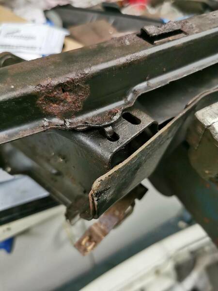

First off, the Honda was occupying the garage again so it made sense to get underneath and give it a bit of a clean and checking over prior to the MOT on Monday. Getting underneath it found nothing too shocking thankfully, a couple of small scabs here and there, which was quickly coated in Dynax UC. Despite being parked in a dry garage for a few days, there were signs of dampness on the underside of the rear sill pockets.
Assuming that rainwater had gotten into the rear quarter cavities again via the side grilles and was struggling to get out, a small gap between the rear quarter skin and the sill was found and 'percussively enlarged' with the help of a small hammer and a flat point screwdriver.

First job - fit the OE replacement ARB D bushes - very lucky to find these, and at a great price too! Despite replacing the bottom balljoint last month, there was still a clonking occasionally heard over speed bumps.
I'd already loosened and tightened all the bolts when I did the clutch change, so I knew they weren't seized, making this job a piece of cake :mrgreen:
This part of the vehicle was very corrosion-free - a testament to the T-series sweating oil from every pore!
Look at the difference in size between the left and right bushes - the constant exposure to oil has caused it to swell and go spongy, whereas the other one has gone dry, hard and crack/split in several places.
The new bushes and contacting surfaces were given a light coat of rubber grease, to hopefully prevent any annoying squeaking. Whilst underneath, I applied more Dynax UC to exposed metal areas - when in Rome.
