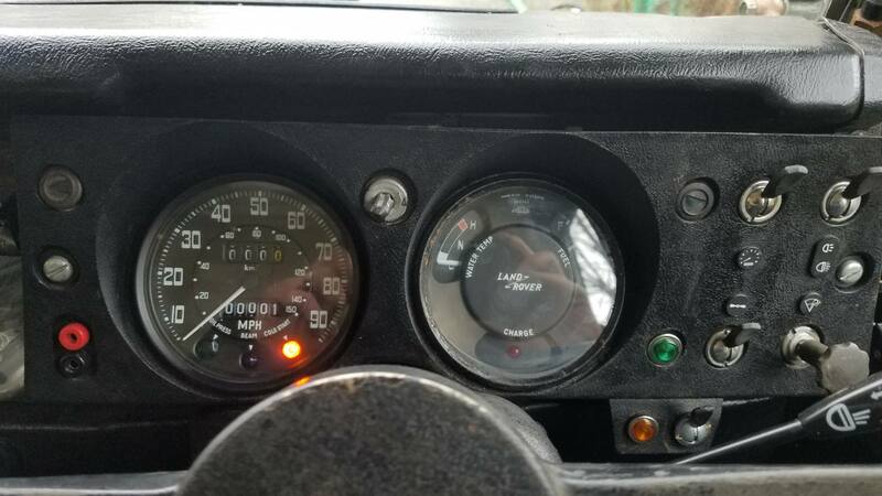

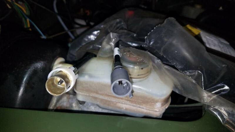

I can't remember if I mentioned, but the speedo was not working when I bought this. The cable was obviously damaged, so I bought a cheap Britpart item to replace it a few weeks ago. I did wonder about splashing out on genuine, but figured that surely a speedo cable can't be that difficult to manufacture correctly.
I was wrong. The speedo head has a groove in it, where a plastic tab on the cable end engages to lock it in position, but the pattern cable was just a plain steel ferrule, with nothing to hold it in place!
Anyway, it worked for a while but soon shifted and lost engagement. It functioned for long enough to realise that I had the wrong speedo for the tyre size however, so there was no rush in replacing the cable until I'd sorted that out!
Fast forwards to now, and I got a new speedo in my stocking yesterday :-)
So it was time to replace the cable and hopefully get it all working correctly.
You can see the clear difference between the cable ends here:
At this point I'd like to claim that it was all plain sailing, but I'd be lying! Unfortunately I have no photos from the next bit, as my mood was fairly dark. First problem was sliding the new cable onto the speedo - it just would not go. Measurement revealed that the cable end had a 16.2mm ID, but the speedo had a 16.4mm OD. For what should be a genuine Smiths part this is a bit disappointing, and it looks as though the mould tool has worn over the years to result in an oversized part (the finish has all the hallmarks of a tired mould). Note that with the Britpart cable, this would probably have worked in its favour, and actually held it on more securely. Why I never thought of this at the time is a mystery!
What I decided to do is file down the speedo to suit. Once tidied up with some emery cloth I pushed the speedo cable on to test the fit. It was still tight but filing was so slow I reckoned I could get away with it. I pushed, and twisted until eventually it seated, and the tab snapped into the groove. At this point the 1990 plastic of the clip had enough, and shattered into 3 pieces :-( Fuck!
 Superglue, and a fuel pipe clip saved the day, and finally the cable was in place! Then I looked at the dial, and saw that the needle was now pointing just above 90mph! I figured that my twisting had actually rotated the male part of the speedo that the cable slides over, altering the rest position. There was no way I wanted to risk pulling the cable off again, so what I did was remove the bezel and glass, and pull off the needle. Resetting this at 0mph seems to have done the trick, and I've even seen the heady heights of 50mph on the test drive!
You may also notice from the last photo I've added a rear fog switch and warning lamp. I wanted to ensure it was still in keeping with the rest of the dash, and didn't want to drill the panel for an irreversible mod.

Excellent!  These things are very difficult to get looking tidy inside, yours looks great!
I've been there with the speedo cable 😒 We had a 2A that needed a new one and the blue box suppliers just couldn't provide anything that would come close to working for more than a mile or so...
We're lucky to get hold of parts for 50yo cars so easily, but it's not much use when they're so unfit for purpose!

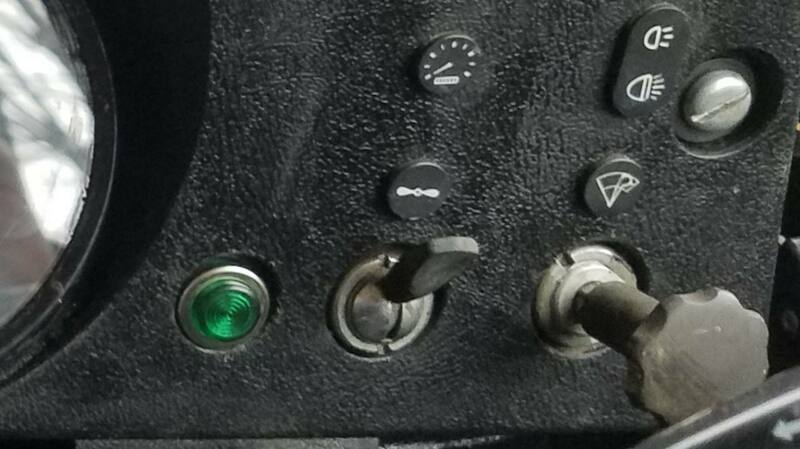

Moving onto the next improvement, given the weather around here it's unsurprisingly to do with the wipers. At present they are either off or on with the twist of a rotary knob, with a push to operate the washer pump.
I want to fit a variable intermittent wipe to cope with the Welsh rain, but without any additional switches or controls. Found plenty of people who've done similar with an extra switch, but that'd be too easy...

A lot of older Yanks have a setup whereby when you switch the wipers on they come on intermittent with a long delay, then as you turn the switch further the delay decreases and then eventually you get to constant wipe and then, with another click, to high speed.  Unfortunately they tend to be on a stalk rather than a knob but you might be able to use the guts out of one of those.
Link to comment
Share on other sites
It seems to lend itself to a rotary knob, so worth investigating. TBH I'm not that bothered about two speeds - I wouldn't want to go any slower than the ON position in continuous rain anyway. It's just that so much of the year is taken up by annoying drizzle where an intermittent setting would be invaluable!
Link to comment
How about this; you can get pull switches with multiple positions, 2 would be enough (off, 1, 2) which also twist on a resistor. Pull out and twist for variable intermittent, and pull again for on.
Reminds me of my headlight switch, which does dash dimmer on the twist and side/head lights on the pull.
Intermittent wiper relay boards are available cheap. Depends how handy you are with a soldering iron, I guess.
Phil
Link to comment
You might be able to adapt this:
https://www.s-v-c.co.uk/product/retronics-intermittent-wiper-system/
They seem to sell all sorts of useful bits n bobs!
But actually this is exactly what you're after:
https://www.revolutionelectronics.com/Products/vw-int-wiper/
Must be a version available in the UK
Link to comment
That's actually what I'm leaning towards now, as I found out that late Series 3s had a two speed motor, with a switch visually identical to mine. I like the functionality of the VW 99 relay (basically you set the interval by the delay between flicking it on initially, and turning it on a second time - effectively what you'd be doing anyway). So I should be able to use the first position as variable intermittent, and the second as the fully on position as they are now 😎
Link to comment
Yep, my late 3 has a two speed motor, so could be rigged to work exactly as that VW switch doodah does.
