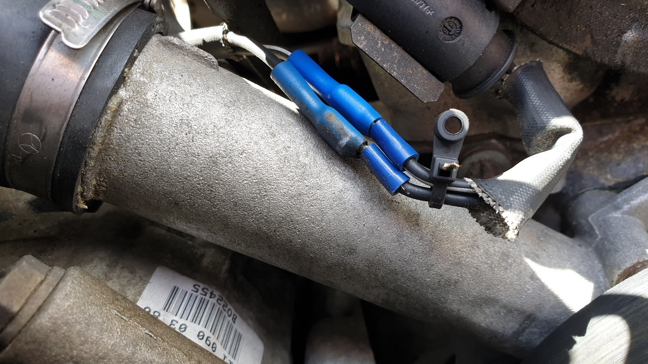

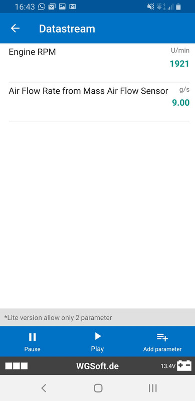

mercedade Posted September 15, 2020 Author Share Posted September 15, 2020 1 hour ago, B4lljoints said: https://forums.mbclub.co.uk/threads/supercharger-not-working.118814/ Don't know if this link might help? It's a CLK they're talking about but the same engine. Thanks for that. That was my attempt over the weekend, funnily enough. What I'm discovering as I work through it, is that all the common elements have been tackled before, so this is clearly a longstanding issue. When I got the ECU apart, I shit myself at the terrifying number of sensitive electronic components, I could see that the MOSFET had already been replaced. I had mine new one to hand anyway, so I replaced it anyway. The 'old' one had lost most of the plastic backing that insulates it from the casing, so I figured it might have shorted. Since replacing it, it definitely runs differently, but still no supercharger. It now hangs on to the revs for slightly longer and is keener to change down, so perhaps that was knackered and now it's not. Same goes for the K40. The one in there is an aftermarket one - it's in waaay too good condition to be 23 years old, but it's got no MB branding on it. I've reflowed some of the joints, but I'm not super confident I've made the best job of it. I am tempted to get a new one, but it's a £100 gamble. Barry Cade 1 Link to comment Share on other sites More sharing options...
mercedade Posted September 15, 2020 Author Share Posted September 15, 2020 1 hour ago, 95 quid Peugeot said: Blimey, that really demonstrates what an old giffer i am, i thought it sprightly Thing is, it is - in the first two gears. It actually drives very much like my old 260e, which is why it took me nearly 200 miles to work out something wasn't quite right. It's just the way of it - I'm still driving it every day because it is such an easy drive around town, so I'm not surprised you wouldn't have picked it up. It just makes motorway/A road overtakes more of a struggle than it should be It's a nice puzzle for me to get stuck into Link to comment Share on other sites More sharing options...

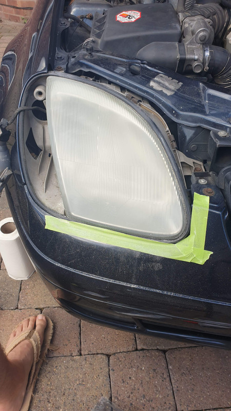

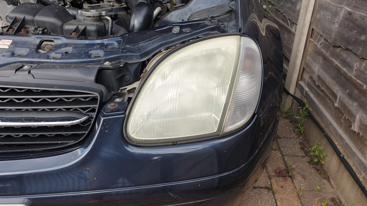

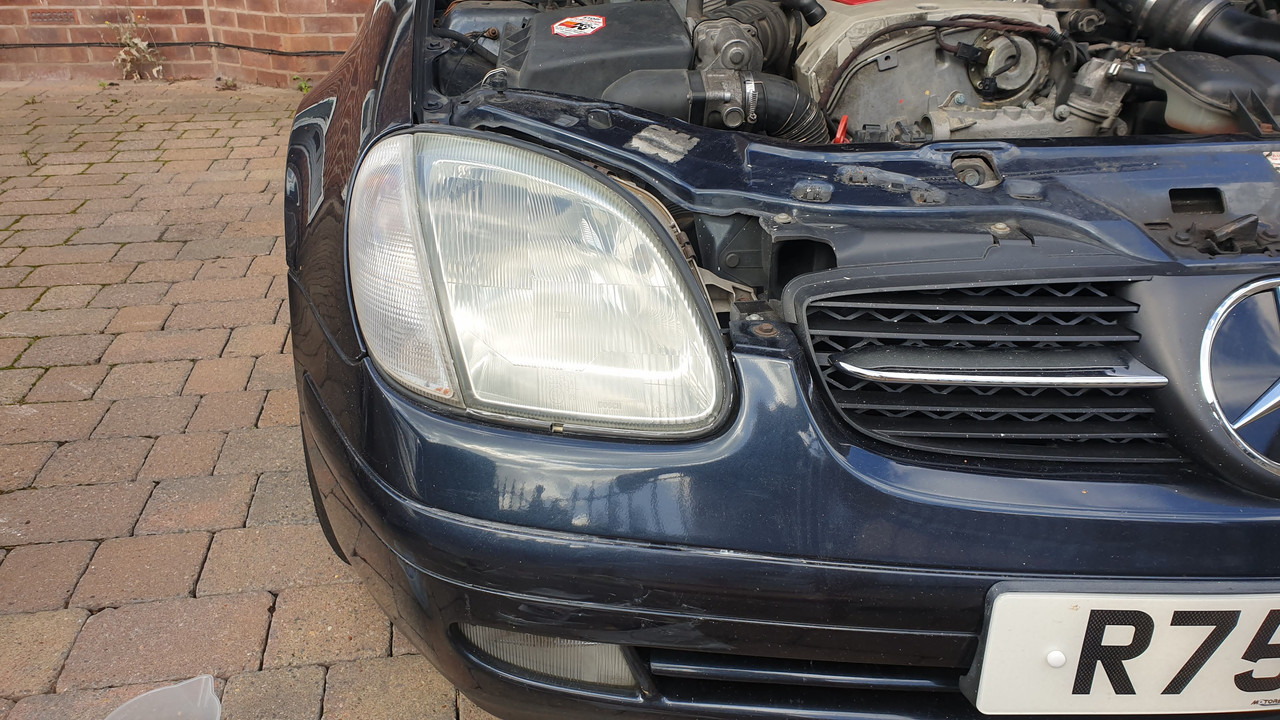

mercedade Posted September 16, 2020 Author Share Posted September 16, 2020 Whilst the supercharger issue rumbles on I really wanted to tidy up those yellowing lenses. This was using an old 3M kit, and a drill attachment. The nearside one shows the before, then drivers side shows the midway point and the end. Much fresher scdan4, Tickman, HMC and 1 other 4 Link to comment Share on other sites More sharing options...

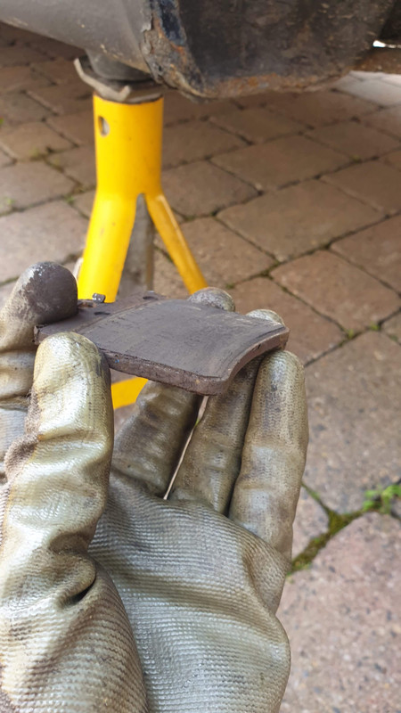

mercedade Posted September 16, 2020 Author Share Posted September 16, 2020 I also decided to resolve the appalling handbrake - totally non-existent. Thankfully, the parking brake is a drum/shoe arrangement, and they just needed adjusting. Take a wheel off, rotate until you can see the adjuster wheel through one of the wheel bolt holes. Could I find the adjuster? Could. I. Fuck. In the end, I was struck by inspiration and used a cheap boroscope camera and my phone to look through a bolt hole into the drum. Turn the adjuster until the drum can't be turned by hand, then back off the wheel 4/5 clicks. Whilst I was there, I discovered the pads for the rear foot brake had braked their last... Pads are cheap, and they're fixed calipers, so no bolts to undo, just a couple of taps to move the retaining pin - I love this easy work! HMC and scdan4 2 Link to comment Share on other sites More sharing options...

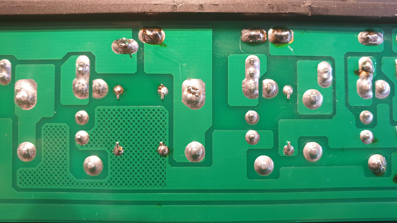

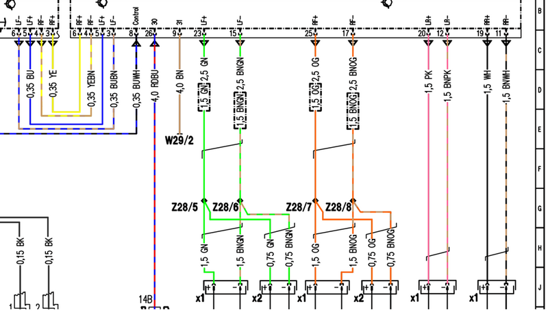

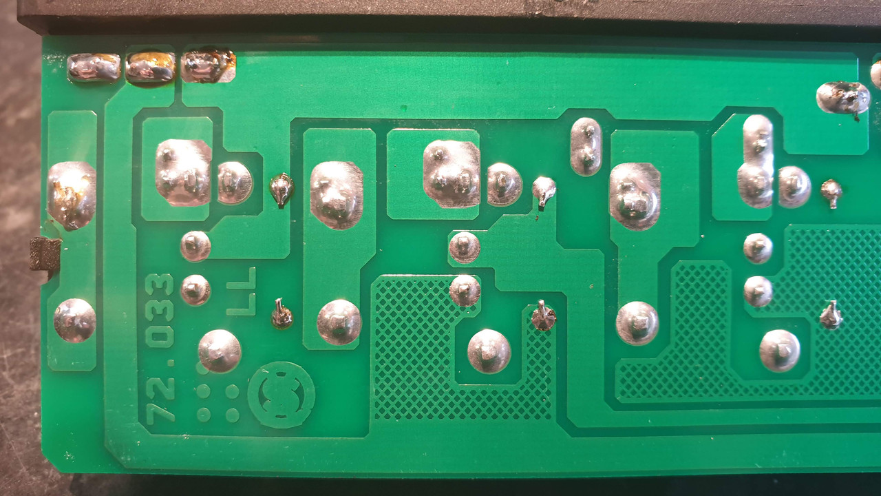

mercedade Posted September 16, 2020 Author Share Posted September 16, 2020 When I picked up the car, Keith mentioned it had a dodgy front left speaker which had been cutting in and out. These have a fancy Bose amp set up, so it takes the signals from whatever headunit is installed and pulls it through a Bose staging amp. Then, using only the front channels, it powers a mid-range and tweeter in each door, plus two miniature woofers, one behind each seat mounted in the bulkhead. Neither the mid nor the tweeter in the left door work, so I did wonder if perhaps some dodgy cabling had got snagged/broken. However, no amount of wiggling and wobbling could get a signal up and running. I suspect the amp, which lives on a cool little board under the passenger's feet I can see one on ebay for £30 so, once I've done a final shake and wobble, I'll probably just replace it. scdan4 1 Link to comment Share on other sites More sharing options...

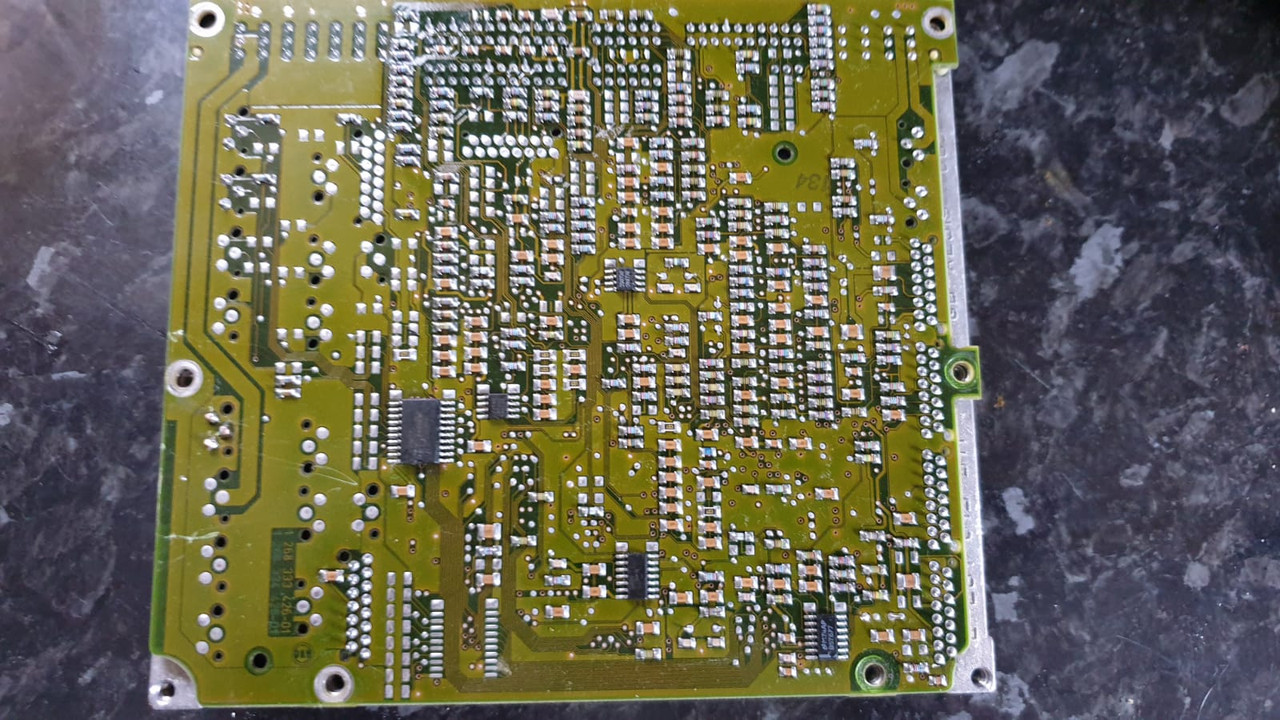

mercedade Posted September 16, 2020 Author Share Posted September 16, 2020 Here's what I found when I opened up the ECU MOSFET already replaced in the distant past by another intrepid fault finder... scdan4 and Cento16v 2 Link to comment Share on other sites More sharing options...

tul66 Posted September 17, 2020 Share Posted September 17, 2020 Stick a 9v battery on the wires from the amp to the speakers. If the speakers pop, then they & the wiring are ok, if not, that's where your problem is. mercedade and DSdriver 2 Link to comment Share on other sites More sharing options...
