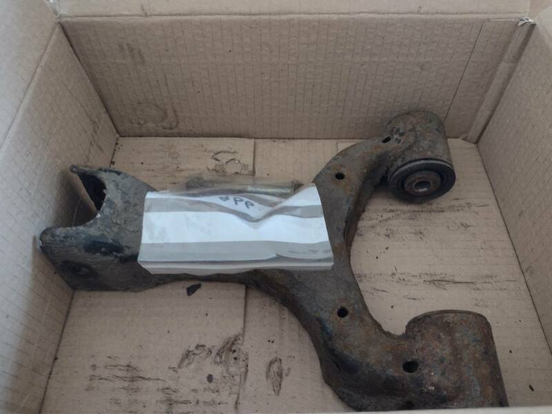

hairnet Posted June 5, 2021 Author Share Posted June 5, 2021 so it started rattling (underneath - yeah like theres engine trouble on a japanese car ) so its either a heat shield or pipe issue also clonk on rear (shock or bush) took it to friendly garage and the arm bush is borked on one side it looks off to one side not central so thats fucked just looking to see if its easier just to replace the arm that fcck about pressing bushes - probably as i dont have a vice to help so would have to give to someone exhaust and rattle are the same thing - where the pipe goes into backbox from the side (on these) thump it and rattle and its blowing from that so replace and should be ok but arch (es) are a possible problem meh fuck fix these llittle issues and deal with the rust later @The Moog can i steal your knowledge re bushes The Moog 1 Link to comment Share on other sites More sharing options...
hairnet Posted June 5, 2021 Author Share Posted June 5, 2021 exhaust bort gasket bort just looking at refurbed arm from mx5 place for the price of just bushes............. Link to comment Share on other sites More sharing options...
Andyrew Posted June 5, 2021 Share Posted June 5, 2021 Is it the upper arm bush on the rear in the middle? On the wheel end? 1 hour ago, hairnet said: just looking at refurbed arm from mx5 place for the price of just bushes............. Link to comment Share on other sites More sharing options...
hairnet Posted June 5, 2021 Author Share Posted June 5, 2021 one of ones attached to the body not the hub end Link to comment Share on other sites More sharing options...
gm Posted June 5, 2021 Share Posted June 5, 2021 https://www.autolinkmx5.com/wishbone-mazda-mx-5-mk2-rear-upper-nc1028c10-used-6178-p.asp or https://www.facebook.com/search/top?q=mazdadudes either will sort you out. no alignment worries on the upper wishbone, just bolt off and on. Link to comment Share on other sites More sharing options...
hairnet Posted June 5, 2021 Author Share Posted June 5, 2021 bort the autolink one nice one marra @gm although it might need a paint :D Link to comment Share on other sites More sharing options...
hairnet Posted June 8, 2021 Author Share Posted June 8, 2021 got johnny wishbone did a doh when i realised the bolt doesnt go all the way through the two bushes - its a bolt each too long messing with swingarm bolts that are 3 foot long for the same type of thing ffs Six-cylinder 1 Link to comment Share on other sites More sharing options...
gm Posted June 8, 2021 Share Posted June 8, 2021 Are you missing a bolt ? Which one - I’ll have a rake around in das garage Link to comment Share on other sites More sharing options...
hairnet Posted June 8, 2021 Author Share Posted June 8, 2021 the ones that hold it on - i only bought one need 3 Link to comment Share on other sites More sharing options...
