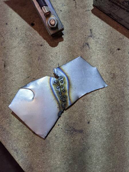

juular Posted November 21, 2020 Author Share Posted November 21, 2020 Awful weekend, doing my best in between the squalls. Started rebuilding the inside of the A-pillar. I can haz garridge? Chop Sill fruit machine jackpot, payout in iron Started making new parts based on rusty offcuts. Metal bender got some use. Test fitting On to the part above that. I have to do a bit of extrapolation from a small rusted fragment here. Pretty damn close! A little touch up and holes for the plug welds. Tacked in. Earlier lower bit added in Pillar starting to look right again. Next big job is to replicate that rusty hinge reinforcement bracket above the new bit. Wee chunk of inner sill replaced as a spot weld had rusted here and eaten right through. There was a funny little bracket /plate layered in here that had rotted away entirely. I had to guess what shape it was as there's literally nothing left but the flanges.. I guess as long as it performs the same function then it will be fine. That's all for now. I have a question though.. Does anyone know if BOR-8 is any good to stop flash rusting? I'm always going to have this problem as I don't want to paint anything until I'm closer to completion of a section. https://www.rust.co.uk/product/bor-8-rust-inhibitor-29 Tepper, scdan4, Split_Pin and 16 others 19 Link to comment Share on other sites More sharing options...
KitKat Posted November 21, 2020 Share Posted November 21, 2020 This is progressing at a rate of knots and looking fab!! Big respect for doing this outside in November in East Scotland too I’d suggest weld-through primer on any of those overlapping seams where you’re plug welding. It’s also good in the short term to stop flash rusting too, with the advantage that you won’t have to grind it off later on before welding a bit more 🙂 Shite Ron, Split_Pin and juular 3 Link to comment Share on other sites More sharing options...

juular Posted November 22, 2020 Author Share Posted November 22, 2020 New hinge reinforcing bracket. In situ. Old one above, new one below. Chopped out. Not too bad a match. Last bit of new inner pillar. Took ages to get a tight fit but got there in the end. I'd be stuck without the power file. Also, neodymium magnets out of old hard drives are brilliant. Cleaned a little bit of surface ginge off a bit of pillar I really didn't want to get stuck into. The metal is sound but pitted. Treated with hydrate 80 just to be sure. Goes nice and blue. Another bit made from a rusty cutout. In situ. Managed to pigeon shit it all together before the darkness and wind killed progress. Thankfully done in time for a quick bit of primer as well. So that's the inner pillar done. Didn't have time to finish this. But it's starting to take shape. Next job.. If all goes to plan I'll be able to start gluing on the outer panels I made earlier and if really lucky I might be able to test fit the door. theshadow, KitKat, Tepper and 12 others 15 Link to comment Share on other sites More sharing options...
juular Posted November 29, 2020 Author Share Posted November 29, 2020 A wee bit fresh this morning. Finished last week's welding off and started on the hinge panel. Missed a bit of grot and had to make an extra bit. Tidied up a couple of bad welds on the inner pillar. Strengthening bracket in place so I could drill bolt holes in it. Had to get a more manly drill to open those up. Couple of strengthening plates too. Bit of bird shit. Making sure this bit still fits. It's slow going. I don't mind the cold at all but the darkness at 3pm can FRO. Need a unit. BlankFrank, Tickman, Amishtat and 18 others 21 Link to comment Share on other sites More sharing options...
