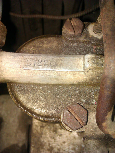

A little more progress today on the Lanchester, trying to clear off some of the busy work items.  Yesterday, I did a little research on what carburettor kit was required, I knew the manual listed the car as having a Zenith 30 VIG-3, I also know from owning French cars that what the manual says might not be the whole truth, so I checked the model number which is C1226.  This told me the car is fitted with a Zenith 30 VIG-5 so an appropriate service kit was ordered from www.Burlen.co.uk since they have always provided decent parts at sensible prices before so seemed a good bet here.

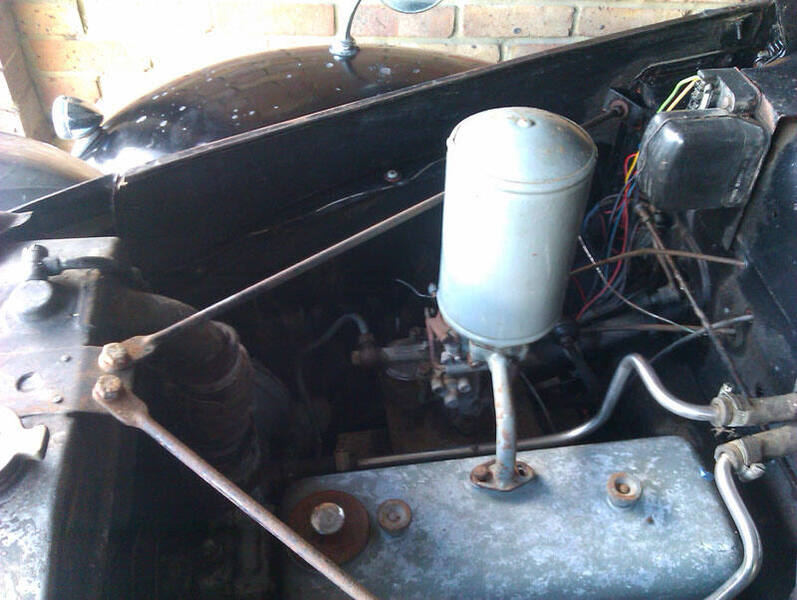

That's one of the most annoying items on the car now dealt with.  It probably should be a stud and not a bolt but since we're not aiming for concourse here, and what I've done isn't a bodge, it'll suffice.  Next was to deal with the wobbly engine side panels, for which we have no fixings since they didn't come with the car.  I worked out what size the floating captive nuts were and found size suitable cross-head bolts and washers to go in.  What I didn't do was check both sides were the same and learned on the passenger side (which has that newer looking wing), the captive nuts are an entirely different thread so I had to use entirely different bolts.  I'll likely paint these bolt heads black just so they're less obvious. There's also two nuts and bolts required at the front, and one at the rear, on both panels.  They're now much more rigid and the body lines look just a little better.  There is a wing piping style seal on the vertical rear seam on the passenger side panel, I don't know if that's correct or if there should be any sort of seals at all on this panel.

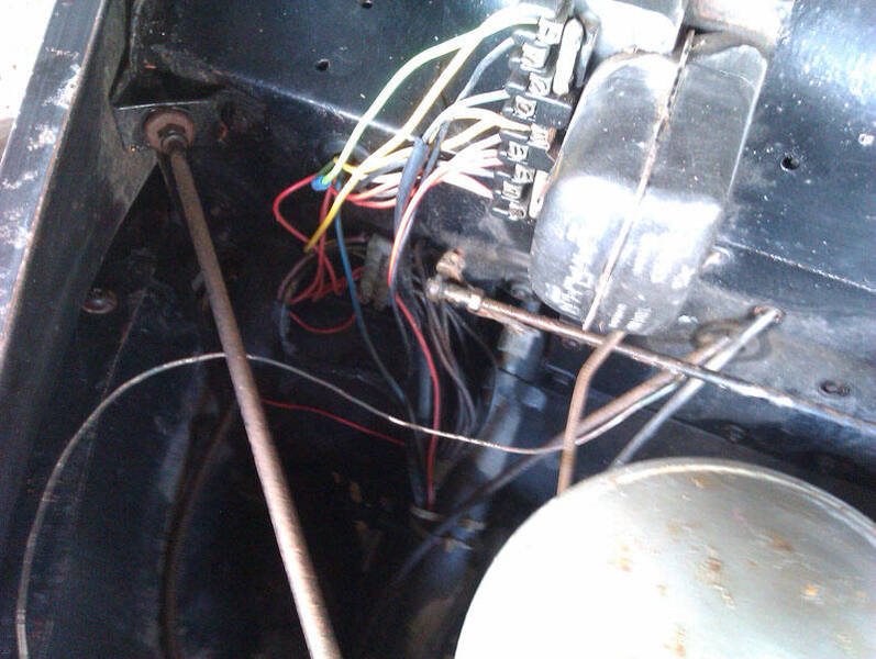

I also rerouted the water temperature guage wire which had been flopping about in the engine bay and being a little annoying.  I did what seemed correct, again I'm not sure of the proper routing with this, so I just tried to run it in a way that matched its general shape and didn't put it under stress.  There was a P clip that lined up with the middle bolt on the side panel so I used that as an anchor point for the wire.  I also checked the wire didn't foul any moving parts.
It took quite a while to do those jobs, as these sorts of jobs often do.  Actually lining up the bolt holes for the side panels was particularly annoying since the panel seemed to want to sit in just the wrong place for lining up one bolt as you were trying to get everything in.  I was left with enough time to do some tidying up in the engine bay at least, the goal is to degrease and generally make the engine bay a nicer place to be.  We've also noticed the car is now leaking oil onto the garage floor underneath the gearbox and fluid flywheel, so that explains why the levels in those was low, it may need new seals.  the water pump was quite greasy, especially around the grease nipple.  I suppose that bodes well since it means someone has been keeping it greased.  Cleaning this off will allow us to see any leaks.  A friend in America wondered if the weird smell of the coolant is due to methanol being added, apparently something that people used over there before coolant as we know it was introduced.

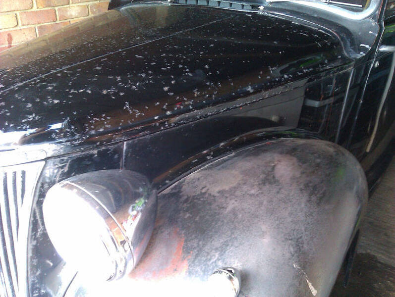

The rest of the engine bay got a very light clean with first some kitchen degreaser on the bodywork to get the bulk of the grime off quickly, I do this by spraying it on, agitating it with a soft brush and then rinsing almost immediately so you don't end up damaging the paint.  After that I wiped down the surfaces with glass cleaner, which I've also found very effective in engine bays particularly.  The inner wings and bulkhead have all got brush strokes in the black paint so I expect it's all been repainted at some point in the past.  When the carburettor is cleaned and rebuilt and the bottom half of the engine bay is degreased it should be quite a nice space to work in.

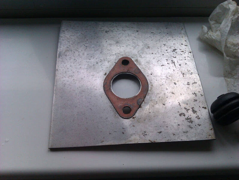

Had a little free time at lunch to do some more tinkering, encouraged by some new parts arriving, namely the sidelight medallions, replacement washer bottle, and the new carburettor service kit.  It took a while to find out what the medallions were actually called.  The Lanchester uses Lucas LD109A sidelights and on our car at least, comes equipped with the little red transparent insert so that you can see when the sidelights are on from inside the car.  There's no dashboard telltale as you'd get in a modern car so this is quite a neat solution in theory.  One side is present and dull, the other side was missing.  New ones are available again from https://www.s-v-c.co.uk/ for not very much.  We ordered a pair but the old one that's still in the lamp is quite firmly attached so we opted not to replace it.  A little WD40 helped fit the new lens, they're a very tight fit and you have to push down on opposing sides equally to get them to snap into place.

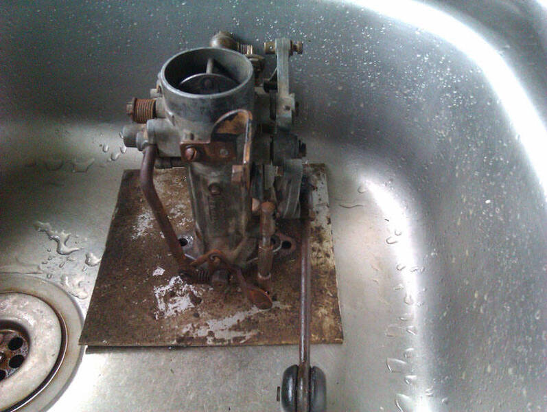

The other item, from http://burlen.co.uk/ was the carburettor service kit which contains all the parts we should need to clean up our carburettor.  Removal was a little tricky without being too frustrating.  I opted to undo the bolt for the throttle linkage rather than unclipping the ball and socket since I was less likely to lose the small clip.  Then there's two nuts that hold the carburettor to the manifold, the choke cable locking screw, and a fitting for what I believe is the vacuum advance line.  I had to be very careful with the latter, I opted to unscrew the carburettor from the line because the two pieces on the end of the line were quite firmly attached to one another and the pipe was trying to twist.  Some heat and penetrating fluid may get these components undone properly.  The fittings look to be brass while the pipe is copper, so it's all very soft and easy to damage.
The carburettor itself isn't too dirty, all things considered.  The heatshield is the dirtiest item due to being covered in barn dust more than anything, and while the carburettor does have some oily deposits, it's far from the worst I've ever encountered and should clean up very well.  I shall be taking lots of reference pictures as I go along with this carburettor, I'm only really familiar with SU types and while this one does look very simple, I don't want to make a silly mistake by not taking care.
The heat shield isn't the original, someone has crafted a sheet of aluminium into a suitable sized square, folding two edges over so there's no sharp bits.  I can't see any reason to replace this shield so I've just cleaned it and will reinstate it.

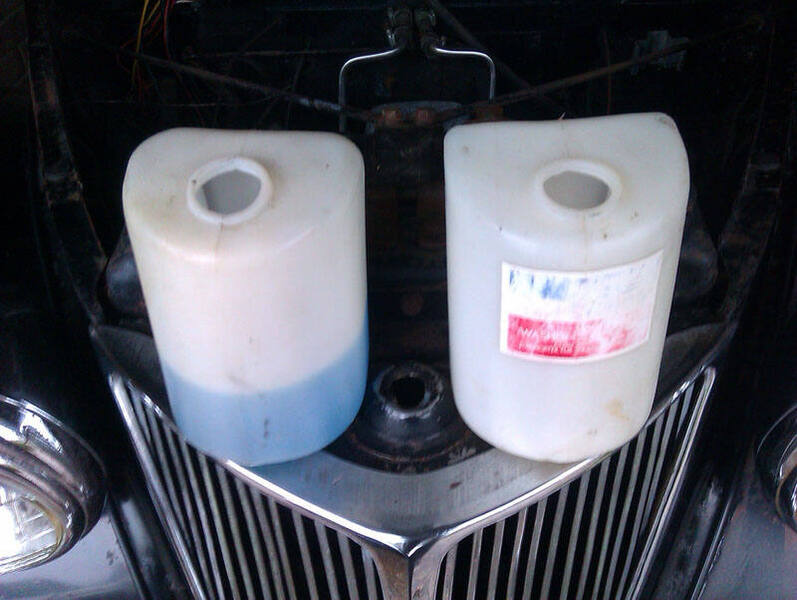

Our last item of note today is the NOS (or so I thought) washer bottle.  It is a direct replacement for the one in the car, though I question the NOS credentials as it has clearly been fitted to a car previously.  I gave it a rudimentary clean and compared it to the original, aside from a slightly squarer profile to the top of the bottle, all of the other dimensions are the same.
I was most disappointed by the angle grinder gouge out of the top corner.  This wasn't shown in the listing.  Had the bottle not been so cheap I would have kicked up a fuss, as it is it was very cheap and doesn't leak, so it'll have to do.
Aside from not having a massive crack, the new bottle has the added advantage that the cap actually clicks into place properly.  I didn't bother removing what's left of the original sticker, there wasn't really much point, and it looks fine in the engine bay as is.

I'm sure you already know, but make sure when you're looking to unscrew the jets in the carb to use the largest screwdriver that you can get into the slot properly.  The last thing you want to do is round one of them out and end up in a world of pain.  If it won't shift with reasonable force, stop and take a step back and have a look for advice.
When you're looking to remove the adjustment screws, count how many turns it takes to screw them all the way in before you remove them...that way you can make sure things are set to roughly the same point when you put them back together.
Link to comment
Share on other sites
All sound advice right there.  I'll also be taking lots of pictures and notes as I go so I know where everything actually came from so it can all go back together.  There don't seem to be that many parts, at least, so it shouldn't be too bad.
