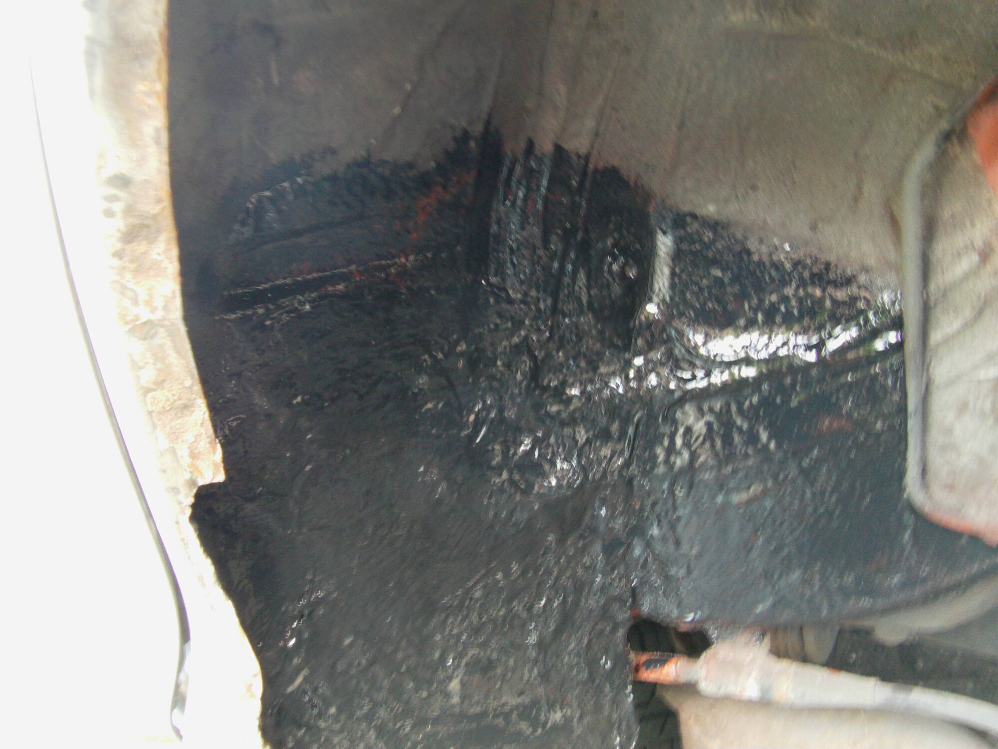

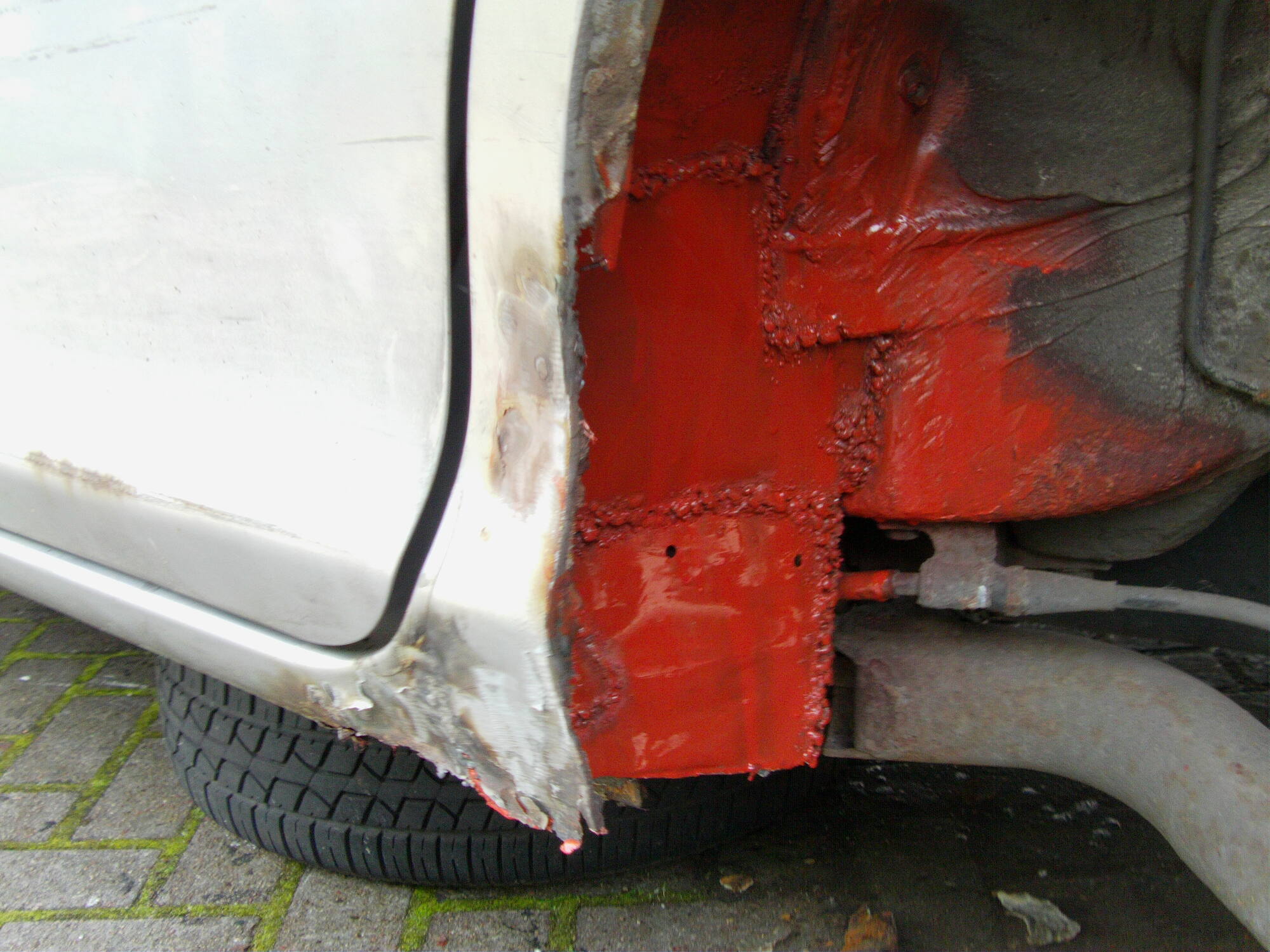

tom tom satnav,got it free,maps out of date,it was simple tidy wheelarch oh dear,see pictures,denty lives again,ran out of metal,outer sill another day,sprayed with lidl anti rust primer,than lidl black metal paint,looks ok,solid,hope to get cover sill for outer,or will have to make up,needs just front shock at passenger side,at the just drop link rear,...IMAG0035.thumb.JPG.cd491cbb92a957ea1941091b9e691381.JPGIMAG0042.thumb.JPG.8d1b14bc0fa6bb39fbab8c91f571743a.JPGIMAG0041.thumb.JPG.ef2e130219590448d015593a26b4ee37.JPGIMAG0040.thumb.JPG.441a07357557de6644464d777c417bf9.JPGIMAG0039.thumb.JPG.420e3d9b297f41e34ddb29c730871c6c.JPGIMAG0037.thumb.JPG.f35ab88f387a5afc29864b527d00ccd7.JPGIMAG0036.thumb.JPG.6c8af976cc3f4bbcd676f59d71016c70.JPG

rest of the sill finished,red ant irust sprayed on,painted on some polish black underseal,picture of a porsche on tin,good enough for honda than,☺️ time for pollen filter change,bosch new ones fitted,well overdue,will let off cv1shot coronvirus neutraliser in it tomorrow,also got cheapie air filter fram £3.41.rear pads,drop link to do,

more update,its balls are no more,new ball joint getting fitted this morning if it stops raining,rear drop link done,pass front balljoint rubber no good,universal boots bought,may still need new joint,pass side shocker fubard,bought one of 3bay £15, spring,top mount inc,makes easier to swap out,rear wheelarch fibreglassed out,no jagged edges,as previous thread oil leak sorted,so will do oil filter change soon.
