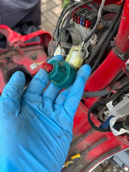

Fabergé Greggs Posted January 21, 2022 Author Share Posted January 21, 2022 Well now, some fiddling happened. All the fuses checked out ok, so took the ignition switch off and soaked it in a little bath of alcohol, whilst operating it with pliers. Success! Well, kind of. it's still very iffy but at least I can get the ignition on now if I hold the pliers in the right place. That let me get the ignition on for long enough to get a flashing immobiliser light with a specific sequence, translated as: Can't see the antenna/key. I'm kinda worried that if the ECU is fucked or it's lost the keys it's gonna be really expensive. I had heard that they can be fussy, after I'd just about given up taping keys to the antenna I tried one more time.. No immobiliser light! Yay! Turning the starter over told me that the battery is fucked though, booo. Enlisting a colleague's car got us this... She runs! As a bonus I gave it some juice and it managed to free off the back brake under it's own RAW power. 250cc's for the win! So now I just need a battery and I can ride it around the car park! This bit of a project is pure joy before you have to tackle all the annoying jobs. Lacquer Peel, Zelandeth, catsinthewelder and 12 others 15 Link to comment Share on other sites More sharing options...

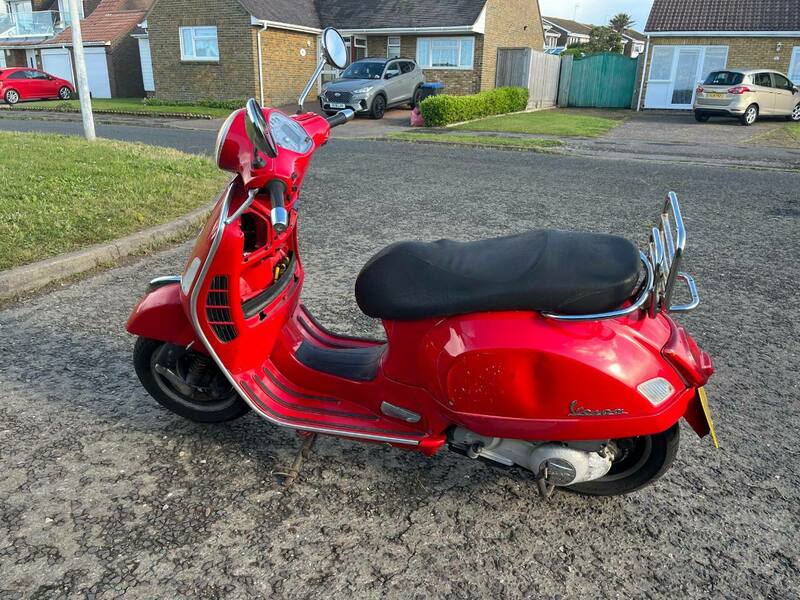

Fabergé Greggs Posted January 25, 2022 Author Share Posted January 25, 2022 New ignition switch @ £11.75 and a new battery @£35.95 means this "free" Vespa is sailing perilously close to having cost £50 goddamit. Look at where we're at: Tell you what, being used to a manual 2 stroke with 8hp or whatnot, the way this thing takes off with 21hp and 20Nm with a flick of the wrist is IMPRESSIVE! Can't wait to get it out and about for the traffic light grand prix! AnnoyingPentium, Tickman, Angrydicky and 7 others 10 Link to comment Share on other sites More sharing options...
schonker Posted January 25, 2022 Share Posted January 25, 2022 Great work so far, you'll be well chuffed how quick they are especially from the lights! I had one for abut 8 years and loved it, until I looked underneath It. Rotten as a pear! Fabergé Greggs 1 Link to comment Share on other sites More sharing options...
Dave_Q Posted January 25, 2022 Share Posted January 25, 2022 At 20p per cc that is still strong value. I think it's only really rust that kills them off. Top brummage. Fabergé Greggs 1 Link to comment Share on other sites More sharing options...
Fabergé Greggs Posted January 25, 2022 Author Share Posted January 25, 2022 28 minutes ago, Dave_Q said: At 20p per cc that is still strong value. I think it's only really rust that kills them off. Top brummage. Aye, value is still strong so far! Now I know it fundamentally works, next step is to get it all cleaned up underneath, hopefully without having to crack out the sparkly stick. I can’t get it roadworthy too quickly mind, it needs to be carefully choreographed with getting a license. Link to comment Share on other sites More sharing options...

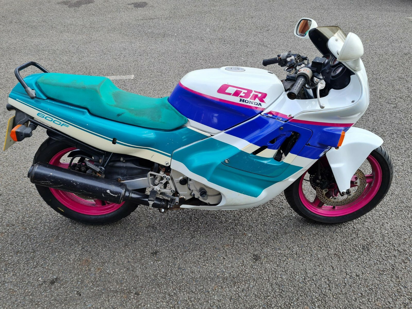

Matty Posted April 8, 2022 Share Posted April 8, 2022 1 hour ago, Fabergé Greggs said: Pretty pleased to say that I passed my big bike test today after about 15 years of really wanting to get round to it. Obviously, instead of getting something roadworthy to do my new big commute on, the Friday night me is saying "buy this fucked version of the bike that you really really want" Have a few good drinks. Then buy it. Fabergé Greggs 1 Link to comment Share on other sites More sharing options...
Schaefft Posted April 9, 2022 Share Posted April 9, 2022 11 hours ago, Fabergé Greggs said: Pretty pleased to say that I passed my big bike test today after about 15 years of really wanting to get round to it. Obviously, instead of getting something roadworthy to do my new big commute on, the Friday night me is saying "buy this fucked version of the bike that you really really want" Worth the purchase for the color scheme alone, top rad! Fabergé Greggs, LightBulbFun and D.E 3 Link to comment Share on other sites More sharing options...
barrett Posted April 9, 2022 Share Posted April 9, 2022 I know nothing of motorcycles, but that one has a turquoise saddle and looks like every 1980s graphic representation of 'an superbike' and therefore you'd be silly not to buy it, right? Who cares about things like parts availability, performance or anything else when you have TURQUOISE AND PINK? Please be carefuly though M8 and don't kill yourself now you've got yr big boy licence, thx LightBulbFun, Fabergé Greggs and Dave_Q 3 Link to comment Share on other sites More sharing options...

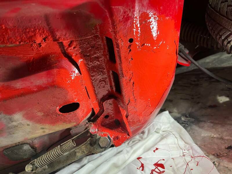

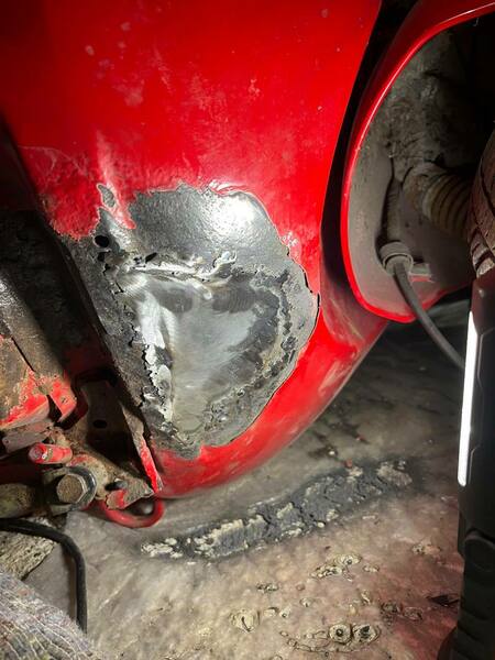

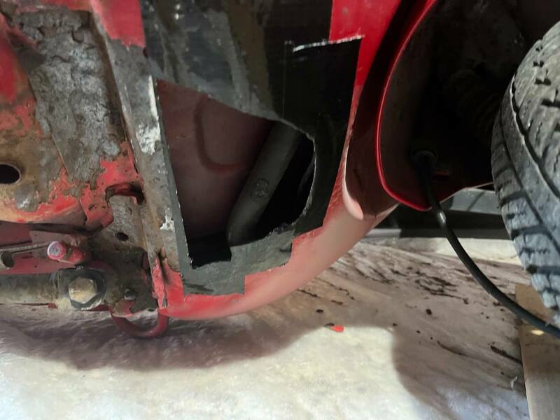

Fabergé Greggs Posted April 17, 2022 Author Share Posted April 17, 2022 Remember that free Vespa that didn’t look too rusty underneath? oh… I was really hoping not to have to crack out the sparkly stick on this. UltraWomble and Lacquer Peel 1 1 Link to comment Share on other sites More sharing options...
Dave_Q Posted April 17, 2022 Share Posted April 17, 2022 It's a shitter but not a massive surprise, the good news is that until the concourse judges lie on the floor to look underneath it nobody can tell what it looks like as long as it's solid. There is also a chap on the GTS FB page by the name of GTS Parts who sometimes has frame cuts to sell, think I have seen floors for £75 or so which could save some fabrication? Or just crudely hammer a bit of fridge side over and MIG it on, the MOT man careth not either way Saabnut, Matty and Fabergé Greggs 3 Link to comment Share on other sites More sharing options...
