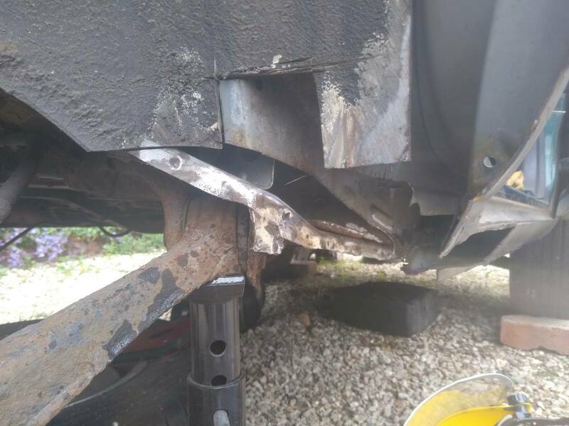

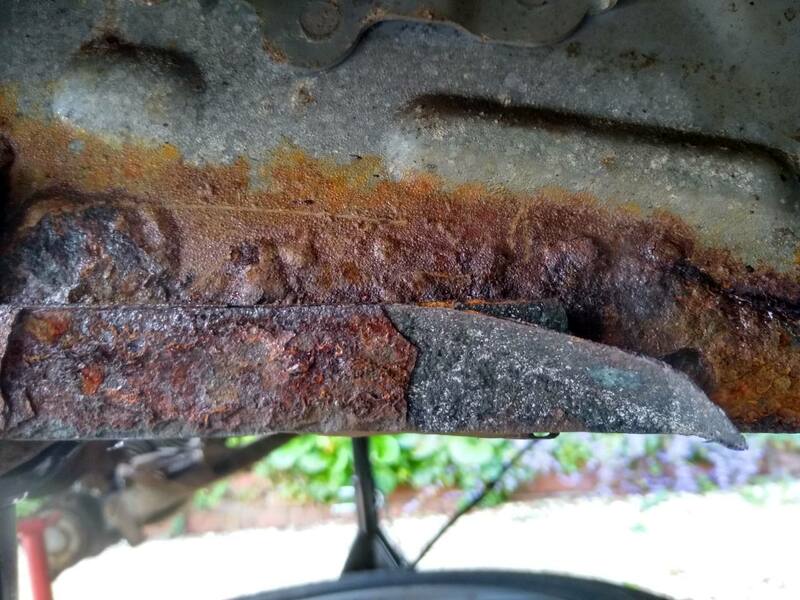

St.Jude Posted June 23, 2021 Author Share Posted June 23, 2021 1 hour ago, rickvw72 said: I’d cut a good chunk of the outer sill off, and if needed weld it back on again after repairing it. Try and do as much as you can without being on your back welding, coz that’s just not fun. Try to lop it off where you can easily weld it on, and grind back the welds after. Looks like the inner sill is spanked. De ja vu Is this the same car? I fucking hate welding upside down, on my back. I thought I cheated it by making the sill repair panel on the bench and did very little welding on my back. Don't have that luxury now. 1 hour ago, Mally said: Providing the gusset is substantial I have no misgivings about your ability to repair safely as you suggest. It's quite meaty. I'd hazard it's at least 3mm thick. 1 hour ago, Dick Longbridge said: That's a massive pain in the arse for you. Well done on keeping the positivity going! I'd have found a cliff to push it over by this point I think. A cliff is being looked for! Might not be looked for by me, but there's a member of the household who's considering £5 of petrol and a lighter to it. Dick Longbridge and juular 2 Link to comment Share on other sites More sharing options...

bunglebus Posted June 24, 2021 Share Posted June 24, 2021 Either chop out enough so you can access it from the inside, or walk away for a few days then chop out enough so you can access it from the inside. Lots of stuff gets fragged due to corrosion, then 20 years later everyone's going on about how they regret doing so - see MK1/2 Escorts. Once it's done you'll know it's safe and strong, and because you made it so St.Jude 1 Link to comment Share on other sites More sharing options...
St.Jude Posted June 25, 2021 Author Share Posted June 25, 2021 19 hours ago, bunglebus said: Either chop out enough so you can access it from the inside, or walk away for a few days then chop out enough so you can access it from the inside. Lots of stuff gets fragged due to corrosion, then 20 years later everyone's going on about how they regret doing so - see MK1/2 Escorts. Once it's done you'll know it's safe and strong, and because you made it so Had intended to do this last night, but I got held up at work so by the time I got home I had a very hungry and irate pregnant wife demanding dinner. So I thought no bother, I'll do it tomorrow (Friday, today). I'm at work, and just checked the BBC. It's going to be raining from 4pm. The BBC are full of shit, so now I've gone to the Met Office. And they have it pissing down with rain from 6pm. So I'll be doing nothing tonight either, which is highly annoying. Link to comment Share on other sites More sharing options...

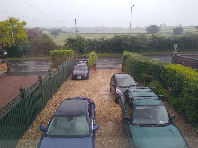

St.Jude Posted June 25, 2021 Author Share Posted June 25, 2021 How do they weld boats in the wet? The fucking state of the weather. theshadow 1 Link to comment Share on other sites More sharing options...

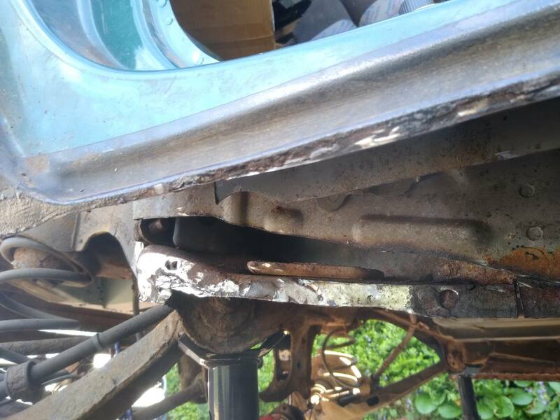

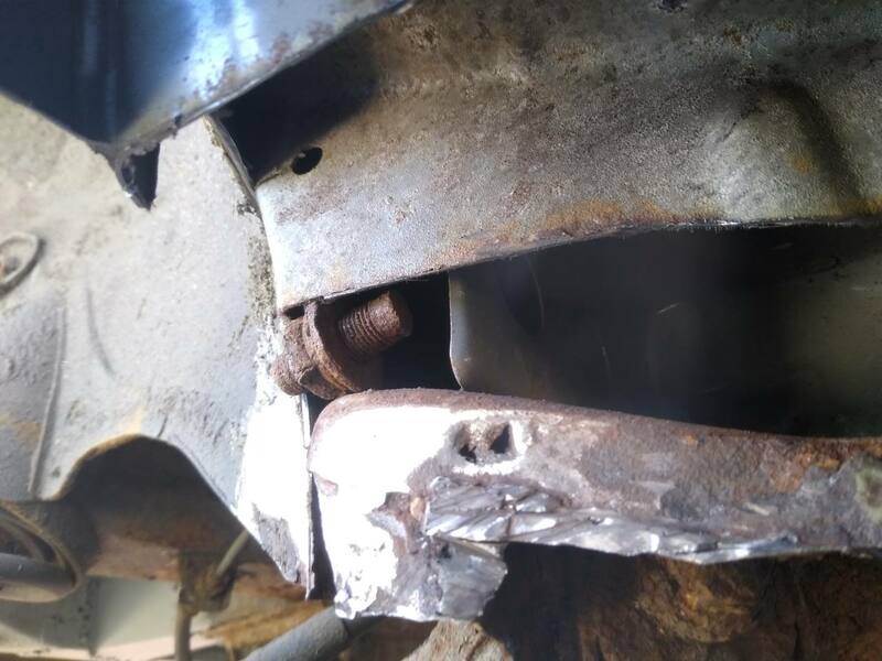

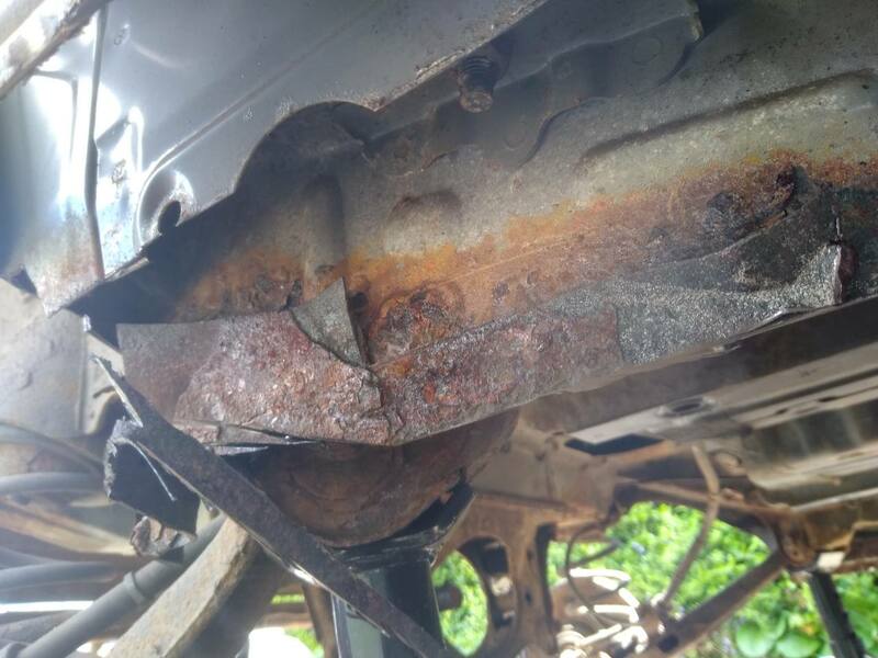

St.Jude Posted June 26, 2021 Author Share Posted June 26, 2021 Dried up nicely! Today I will be mostly cutting steel in a homage to a high vis Mother Teresa. Bless you my child. The piece of the previous repair that's welded in deep seems to be laminated? Anyone got any idea about that? Also managed to smash the camera glass on my phone as I filmed myself grinding away. So that was good. juular, Minimad5 and theshadow 3 Link to comment Share on other sites More sharing options...
St.Jude Posted June 26, 2021 Author Share Posted June 26, 2021 The truth shall set you free and all that: Remnants of the inboard sill are still there along the edge of this gusset. I've put a hole in the side of it with a screwdriver as I was trying to prise off the old repair. I've attacked it with the screwdriver again and I'm not able to penetrate the other areas. So I think I can patch that hole and it will be ok. Found a bolt though which has been there for a long time, but I can't seem to find where it used to live - I don't know what to make of that. Had to cut more of the arch off to cut the inboard sill off. Not bad, but not great either. I'm going to opt for thicker steel here I think, I've got some 1.2mm for the Lada which I'll have to use. theshadow, Fumbler, Rusty_Rocket and 4 others 7 Link to comment Share on other sites More sharing options...
St.Jude Posted June 27, 2021 Author Share Posted June 27, 2021 Short day today, as it's a Sunday and if I'm treating rust inside this part it's not going to be fit for welding. Drilled out the spot weld and cut more of the arch (like I did on the passenger side), and was greeted with no rust. Which was good. Attacked it with the flap disc, removed the old sill so all of that "polished" surface you see is that gusset. Tickled it with the angry pixies, so there's no hole there now. Smothered as much Vactan as I could, and I'm left with this. I'm going out later tonight to spray it with weld through primer. Not on the surfaces to be welded, but just on everything else so that it stands up to the heat. Weather isn't looking promising tomorrow, or Tuesday, and I'm at a funeral Wednesday so I won't be at this now until Thursday at the earliest. I'm booking a week off (hopefully) for next week, so I can just smash this solid for 10 days. Ian_Fearn, Six-cylinder, Fumbler and 2 others 5 Link to comment Share on other sites More sharing options...
St.Jude Posted June 27, 2021 Author Share Posted June 27, 2021 Etchweld applied while I film a video about rust removal with salt. Six-cylinder, theshadow, Ian_Fearn and 1 other 4 Link to comment Share on other sites More sharing options...

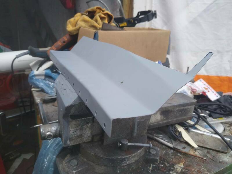

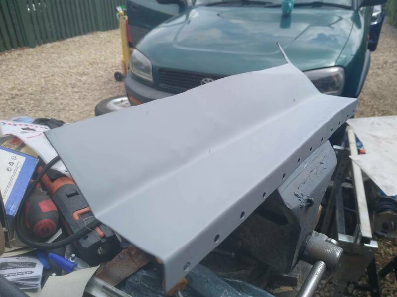

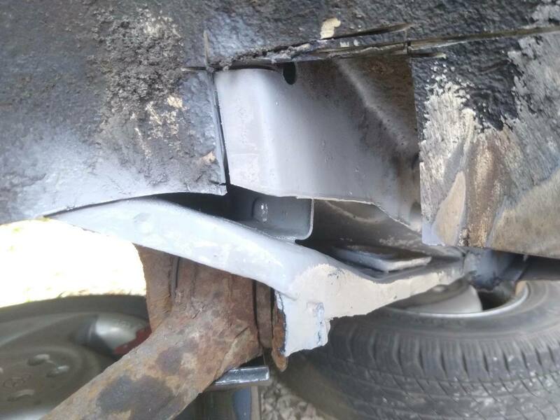

St.Jude Posted July 10, 2021 Author Share Posted July 10, 2021 End of day 1. Knee is still sore. I cut my finger. But I've the inboard and inner sill thing done and on the car. That's the middle reinforcement bit, welded to what was left as well as the new sill. Waiting for it to cool down so I can throw some etch primer on it. I need to flap down the spot welds for the outer sill, and trim a bit of it off as it's too long protruding on to the rear arch. The spots have penetration, and I've welded the inboard sill both inside the sill (behind that middle bit) and welded it from behind as well. Nice, strong welds - skipped the bit between the sill and rear trailing arm mount, as given that a trailing arm is £840 I'm going to take them both off to clean the rust off, treat them, and protect them. So I thought while they're off I'll have more room to get at it. Had an email from Parcel force about the rear arch panel, should be here Monday! Weather tomorrow looks alright, with rain expected at 5pm. So should have a good day at this. Monday weather is looking ropey but I will get the gazebo out and tarp to help things along hopefully. JMotor, Fumbler, dave j and 4 others 7 Link to comment Share on other sites More sharing options...

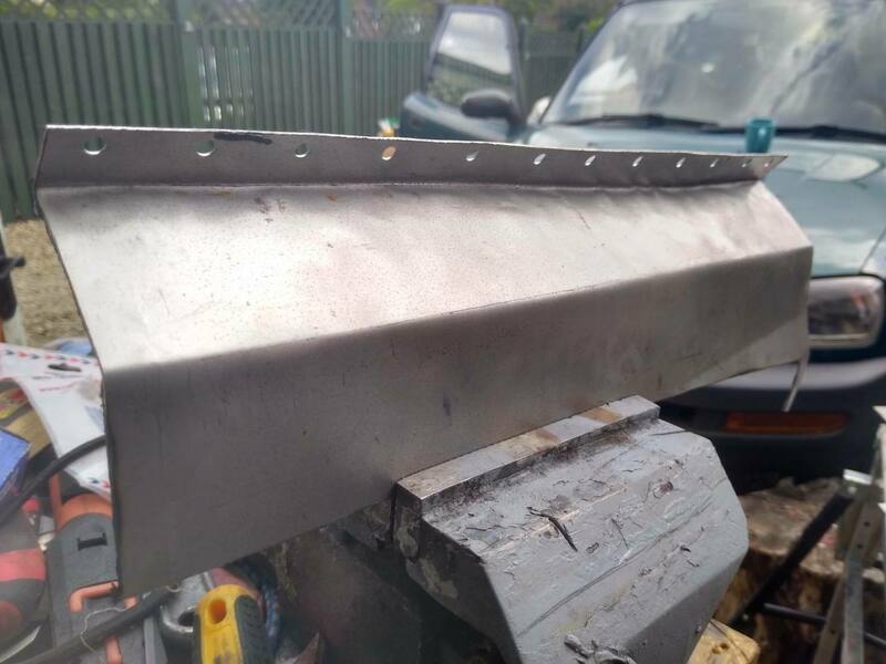

St.Jude Posted July 11, 2021 Author Share Posted July 11, 2021 Day 2 complete. Bit of a miscommunication I think. Had a notification that rain was expected at 4pm, so I finished it to a point where it would be easy to start from tomorrow. But it's now nearly 5pm and there wasn't a sodding bit of rain. So I could've at least welded the lower arch today. Oh well, that's tomorrow's job. I sorted out two duff welds on the inner reinforcement panel, made up the outer sill and welded it all together. I kept blowing holes in the top part of the sill, hence the welds looking fatter. Sprayed in etch weld given the rain tonight. Ian_Fearn, bunglebus, Isopon and 5 others 8 Link to comment Share on other sites More sharing options...
Ian_Fearn Posted July 11, 2021 Share Posted July 11, 2021 These sill panels are so thin. Without joggling the panel, blow through is inevitable. overall mark: A+ St.Jude 1 Link to comment Share on other sites More sharing options...
