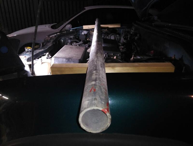

St.Jude Posted February 25, 2021 Author Share Posted February 25, 2021 So I've the next two days off, and I've spent about 5 hours today sorting this bolt shit out. Tried the heat a few times. Bolt didn't move. Tried welding a nut to the bolt, plenty of heat (it was actually glowing) - didn't move and actually broke more when I took the breaker bar to it. I ended up cutting the bastard out. Now I've welded a new patch in, welded a nut to it and it's so far looking good. I'm waiting for the primer to dry before I throw the stone chip on it, as I don't have a body top coat for it. Feel more positive today about it. The subframe should be on tonight! 500tops, Rusty_Rocket, Dick Longbridge and 13 others 16 Link to comment Share on other sites More sharing options...

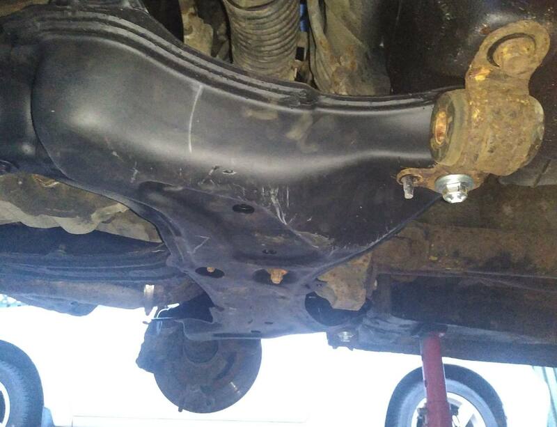

St.Jude Posted February 25, 2021 Author Share Posted February 25, 2021 And with the high, comes the stall, and the plane starts creeping back down to earth. The subframe is back on. Joy! Great replacement I think. Putting the bushes back on (the bolts go through the chassis and the subframe) and I realise I haven't ordered bolts for them! There's a short stubby one which I didn't need, then there's two long bolts which, well here they are. One looks like it's from the ark, the other's thread is mangled and my tap 'n' die set don't go as big as this. So I was on the phone to Big T. That was fun. He reckons I'm wrong, or he can only see stubby bolts. I hate COVID because I'm stuck using my local Stourbridge garage instead of the guys at Fort Dunlop in Birmingham. The difference between the two is that Fort Dunlop let you see the screen, as the Stourbridge lot go away in to a room and come out with print outs etc. Anyway, he's ordered the bolts, so I will rock up there with the bolts I've got, and I'll take the ones that fit. That should be tomorrow he said, until he called me back and said they won't be here until the 2nd March. So I'm stuck now waiting for more bolts 😂, so happy. Although as I have tomorrow off, if the bolts don't turn up I can carry on with the Lada. I'll leave you with a photo of how I've held my engine and gearbox. Length of scaffolding pole and a ratchet strap. BeEP, theshadow, Low Horatio gearbox and 3 others 6 Link to comment Share on other sites More sharing options...

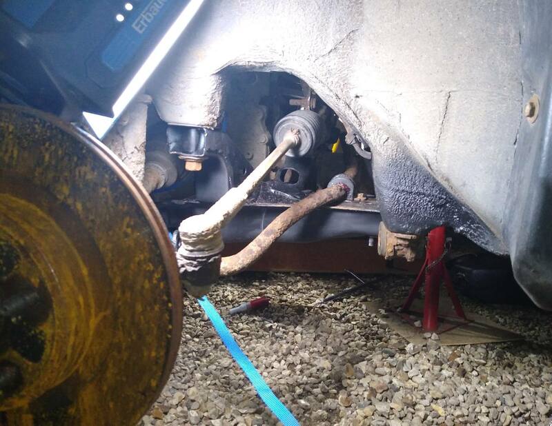

St.Jude Posted February 26, 2021 Author Share Posted February 26, 2021 No call from Toyota, so no subframe bolts. Decided I would inspect the rear of the car for the rust spots I noticed when I dropped the diff before. They do need doing, although the MOT man never noticed them. They're screwed on and also bolted on, but I need to take the wheels off to actually get a screwdriver in there. Can't do that right now, so I didn't do much else. However, I did set up a little shrine to St.Jude who is the patron saint of lost causes. Genuinely would love to change my forum name to that right now! Sigmund Fraud, crad, Low Horatio gearbox and 8 others 1 10 Link to comment Share on other sites More sharing options...

St.Jude Posted March 2, 2021 Author Share Posted March 2, 2021 I'VE ONLY GONE AND FITTED THE MOTHERF**KING SUBFRAME ON TO THE MOTHERF**KING CAR! New bolts tightened, thread locked, feck the next one who has to take it off. warch, gm, dave j and 18 others 21 Link to comment Share on other sites More sharing options...
