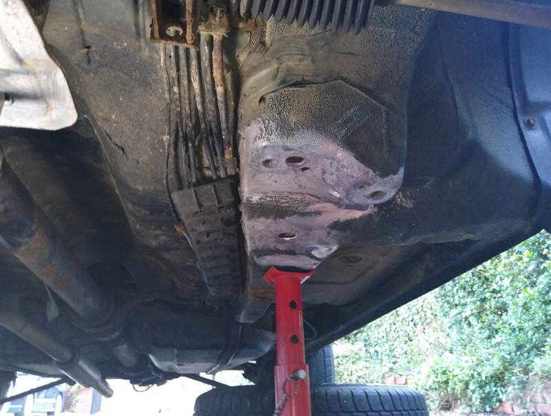

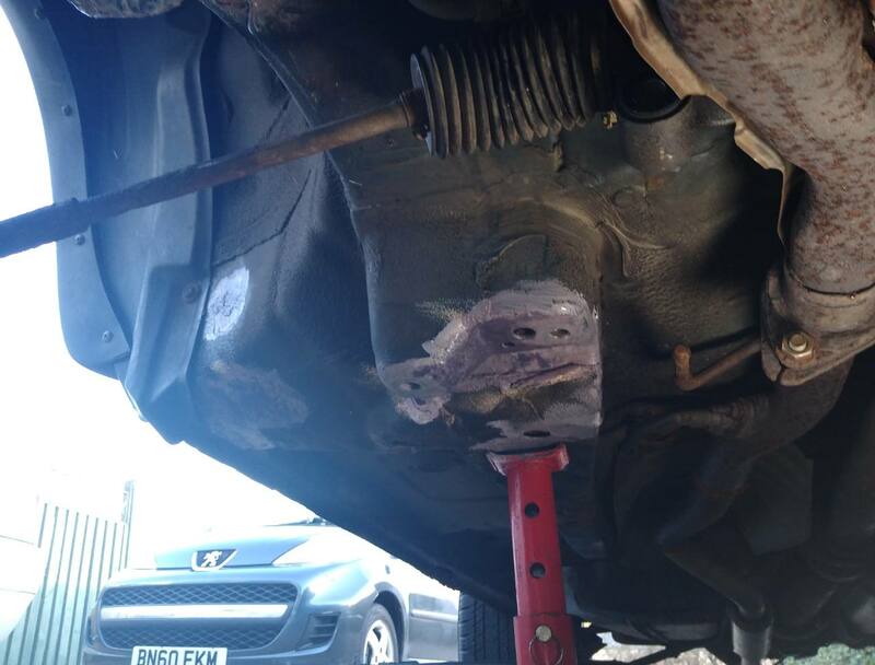

St.Jude Posted January 30, 2021 Author Share Posted January 30, 2021 Quick update, in lieu of access to a laptop and plus I'm frozen with the f**king cold. Jack's on axle stands now, I've taken the new subframe and put it underneath, looking to see if it fits. It's looking good! I've removed one bolt, attaching the wishbone to the subframe on the passenger side. My brand new DeWalt 950nm unga dunga got that off no bother, but has stopped dead with the driver side. It's too cold and wet to do any more tonight, so I will be at it tomorrow. Very happy so far though. Autodoc parts turned up Thursday (as can be seen on the Autodoc delivery thread), need to buy two bushes for the wishbones though as I'd like to change them given I'll have it all apart. Huzzar! colino, 666jjp, louiepj and 2 others 5 Link to comment Share on other sites More sharing options...

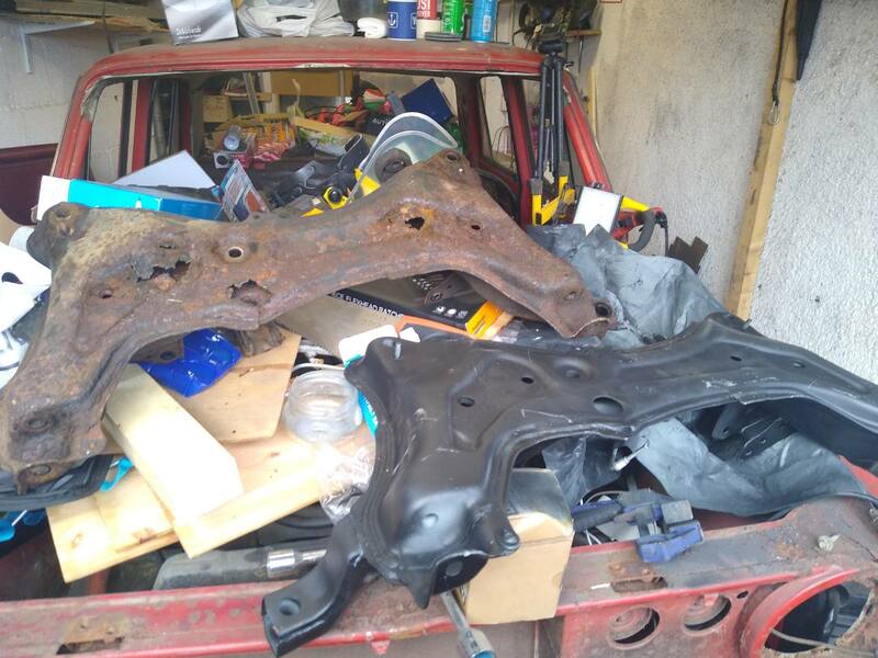

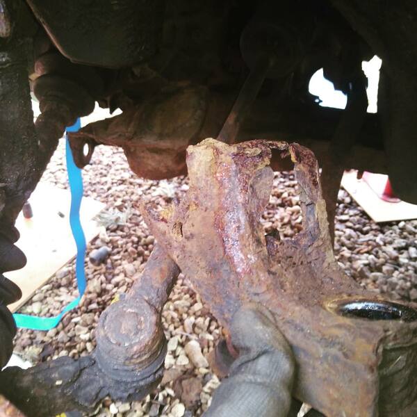

St.Jude Posted February 6, 2021 Author Share Posted February 6, 2021 It's just as well the subframe I bought looks to be the right one, because I don't think the current one is salvageable! I took the bolt off that holds this to the chassis, and that arm just fell off. I didn't even need to tap it. I have a leaky oil sump pan to contend with now while I've got the subframe off. Might as well do the timing belt too. Although at the same time, I've torn my jumper on the door, I've broken a rounded nut extractor, I've hurt my shoulder because the DeWalt gun I've got won't shift half of the bolts there so I'm having to use manual labour, and it's not even 1pm yet. So I'm not even sure if I should attempt those today given the absolute shithousery of a day I'm having already! Still, could be worse. I could've hit a pot hole and had the whole subframe torn off from under me. Low Horatio gearbox, 666jjp, Lacquer Peel and 3 others 2 1 3 Link to comment Share on other sites More sharing options...
warch Posted February 6, 2021 Share Posted February 6, 2021 Bloody Nora! That's some pretty crusty shit going on under there. Is the shell bad too or it is 'just' the subframe and running gear. Link to comment Share on other sites More sharing options...
St.Jude Posted February 6, 2021 Author Share Posted February 6, 2021 1 minute ago, warch said: Bloody Nora! That's some pretty crusty shit going on under there. Is the shell bad too or it is 'just' the subframe and running gear. The subframe is mostly rust, it makes a good shaker too. Where the frame bolts on to the car is alright though. The wishbones aren't that far behind the subframe but I've got replacements. The rusty thing behind the thing I'm holding is the subframe by the way. Running gear is grand. New one on the right, old one is on the left. Tickman, warch, Jim Bell and 2 others 4 1 Link to comment Share on other sites More sharing options...
warch Posted February 6, 2021 Share Posted February 6, 2021 Bloody road salt, I start to wonder if it'd be better if they didn't bother. In all fairness many cars with those pressed steel subframes suffer similar corrosion problems. My brother's 13 year old X type has some rust holes in the front subframe. As long as you have some good car to get bolt things back to you'll be ok. Good luck, I expect to see gratuitous photographs of the new metal getting bolted into place. Link to comment Share on other sites More sharing options...

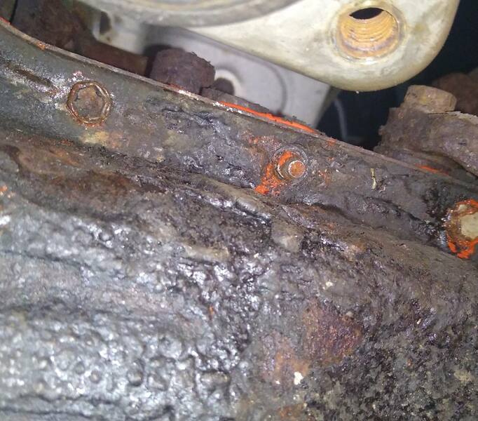

St.Jude Posted February 6, 2021 Author Share Posted February 6, 2021 Well fucking everything that could go wrong went wrong. I eventually got the sump off, managed to Nick it a little which I think I sorted out, to then putting the RTV on, and one nut wouldn't go back on to the car. The nut then decided to separate, as in the collar of the nut stayed on the stud, and the hexagonal bit stayed on the socket. So I've all the nuts and bolts back on the sump to the engine bar that one, and the RTV has gone off. Literally never had a day like this before, not even when I was depressed and trying to work on the Corolla. I have never known a day to just keep putting obstacles and fucking everything up as much as today. The only thing that went right was spraying the treated rusty parts of the car. And even then the can was playing up. I'm praying for snow tomorrow so I don't have to find another excuse to go out and fix that fucking car. rainagain and crad 2 Link to comment Share on other sites More sharing options...
St.Jude Posted February 6, 2021 Author Share Posted February 6, 2021 2 hours ago, Wgl2019 said: As a UK based Autodoc alternative has anyone used Parts In Motion? https://www.partsinmotion.co.uk/ Seem reasonable price and stock..... I have for the Corolla, but only through eBay. I didn't know they had a website so I'll check it out. Also here are gratuitous photos of the shithousery from today. Low Horatio gearbox, Ian_Fearn, Tickman and 2 others 5 Link to comment Share on other sites More sharing options...
Agila Posted February 6, 2021 Share Posted February 6, 2021 I certainly feel your pain on this one. It reminds me I also did the sump on my Mr2. A properly messy crap job. I think the sump should be OK despite that single nut problem. The rtv stuff does a proper job and the rest of the nuts should hold it. Hopefully no leaks. Cheering you on with this as I know how hard it is. At least I did mine in Summer, haha. Link to comment Share on other sites More sharing options...

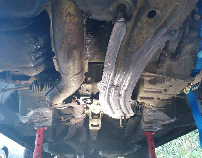

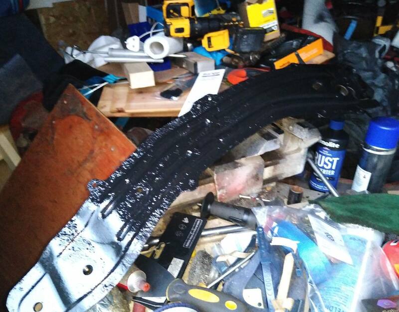

St.Jude Posted February 7, 2021 Author Share Posted February 7, 2021 I gathered myself up, got my glad rags on, stepped out the door, did a bit to camera while I saw it start to snow. And the wind blew, and as I spoke about what happened, the will to actually do anything wilted with it. So I put some stone chip on the parts of the underside that I zinc sprayed last night, swamped the stud on the sump pan with some RTV, went back inside and watched The Simpsons instead. As the day went on though, guilt started to hit me. So I took the cross member, put some rust converter on it, then sprayed stone chip on that. I'm now going in to the week where I can only spend week nights on it, so I may ask my gaffer for a day off Friday just to spend the day smashing this so I can move on to the rotten sill. Then it'll be MOT ready. Coprolalia and spartacus 2 Link to comment Share on other sites More sharing options...

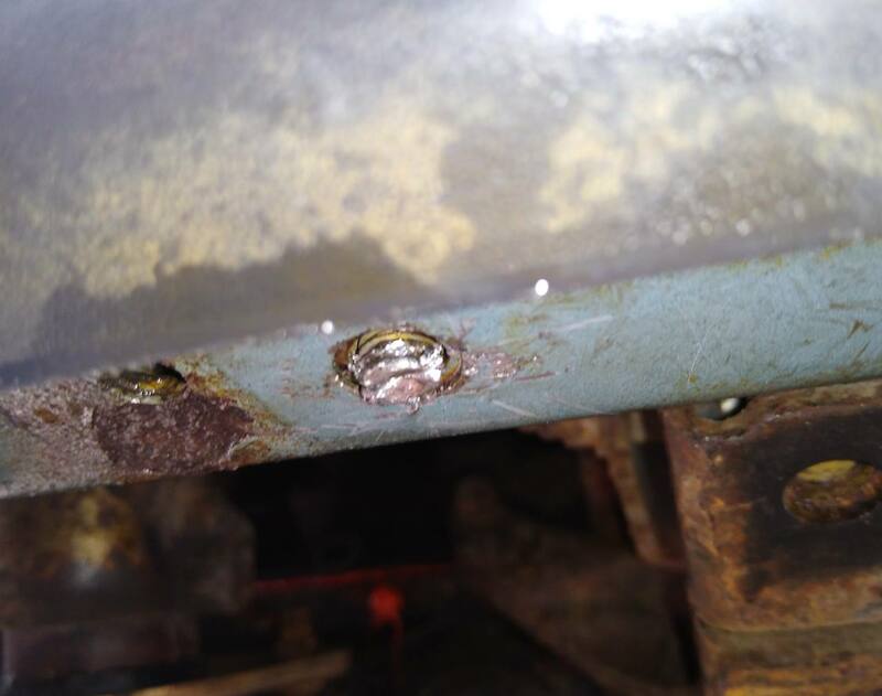

St.Jude Posted February 13, 2021 Author Share Posted February 13, 2021 So while today is dry, it's freezing. I don't have a thermometer, but the met office reckons it's -1c here feeling more like -7c. And I can believe that. I was out here for 2 1/2 hours, 2 hours spent trying to extract the broken cross member bolt. I started drilling it, for an hour, and got absolutely no where with that. These are Grade 10 bolts after all. I took my multi tool and used it with the smallest blade I had, which was a perfect fit, and cut a slot in the bolt. I've got a screwdriver with a ratchet, wasn't having it at all. The wife is out in the car so I couldn't get to B&Q to get hold of a blow torch, or various nuts to weld on to that thing. Short of cutting that section of the frame out, what's everyone's thoughts on just leaving it as it is and using one bolt to hold the cross member at the front? I'm tempted. But that's because I've frozen myself solid for two hours on this and my famous enthusiasm for lost causes is starting to book holidays for a week of banging my head against a wall instead. Link to comment Share on other sites More sharing options...
primeradoner Posted February 13, 2021 Share Posted February 13, 2021 Given that it will be rusted above the captive nut have you nor tried to tighten it so it goes right through and drops into the chassis rail. This worked for me on a sierra anti roll bar bolt. spartacus and Tickman 2 Link to comment Share on other sites More sharing options...
St.Jude Posted February 13, 2021 Author Share Posted February 13, 2021 4 minutes ago, primeradoner said: Given that it will be rusted above the captive nut have you nor tried to tighten it so it goes right through and drops into the chassis rail. This worked for me on a sierra anti roll bar bolt. I gave it a half arsed try, as the screwdriver kept slipping out as it didn't break clean. When I go back to it I'll keep cutting the slot deeper to give the screwdriver more purchase, and try screwing it the other way. The length of the bolt is ridiculous given that the captive nut itself isn't that tall. Link to comment Share on other sites More sharing options...
Agila Posted February 13, 2021 Share Posted February 13, 2021 20 minutes ago, sgtberbatov said: The length of the bolt is ridiculous given that the captive nut itself isn't that tall. In that case. Does it protrude through the top and maybe get some locking mole grips on it. Or drill out and use a proper nut on the other size. Or offer the subframe up and just splatter it with weld because hopefully it will never need to come off again. Link to comment Share on other sites More sharing options...
St.Jude Posted February 13, 2021 Author Share Posted February 13, 2021 7 minutes ago, Agila said: In that case. Does it protrude through the top and maybe get some locking mole grips on it. Or drill out and use a proper nut on the other size. Or offer the subframe up and just splatter it with weld because hopefully it will never need to come off again. It probably does, but it goes in to an enclosed space. So I would have to cut around the nut to get access to the bolt on the other side. This is for the cross member, which goes north to south and goes between the rear engine mount and the subframe. The thought crossed my mind to just weld it on, but then I thought that's a bit of a dick move to the next person who owns this and has to have it. Low Horatio gearbox 1 Link to comment Share on other sites More sharing options...
