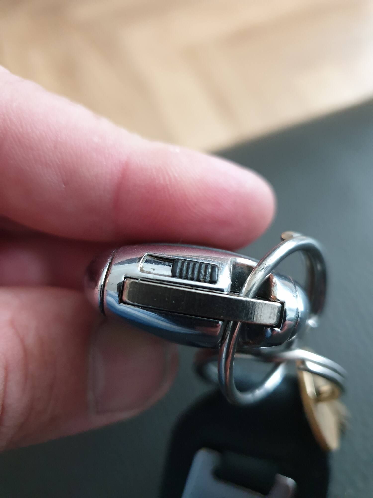

Wack Posted September 4, 2020 Author Share Posted September 4, 2020 Next question how does this bloody key open It could be a key problem as mine is working fine but hers still has problems I've found tutorials to get into the battery compartment but both my keys are different They say remove the mechanical key and press it into the hole opposite the slot only typically my keys are different, there is no hole opposite the slot , just the sprung plastic clip that holds the mechanical key in Also they appear to be different to the keys in the youtube video in that the lever to remove the mechanical key is on the bottom not the top I'm starting to wonder if I've got some sort of prototype as the michelin wiper blades didn't fit the arms without modification despite their insistence they did , I had to cut 2 lugs off Link to comment Share on other sites More sharing options...

RoadworkUK Posted September 12, 2020 Share Posted September 12, 2020 If you're still trying to open the key fob, try removing the mechanical key and sliding the spring-loaded nub (that holds it in place) towards the hole, in the direction of the arrow visible in your pic. You should then be able to slide the whole core of the key out from its metal sleeve. Your car was right on the cusp of the facelift; it has some of the later exterior updates but the pre-facelift interior. That stereo was replaced with a version with a colour screen and bluetooth. Amusingly, when I was selling these, two brothers came in and bought a pair of E-Classes at the same time, and when they turned up one was a facelift and one wasn't. I thought the shit would hit the fan but fortunately the brother who got the pre-facelift said he preferred it. Wack and Pete-M 2 Link to comment Share on other sites More sharing options...
Wack Posted September 13, 2020 Author Share Posted September 13, 2020 On 9/12/2020 at 12:15 PM, RoadworkUK said: If you're still trying to open the key fob, try removing the mechanical key and sliding the spring-loaded nub (that holds it in place) towards the hole, in the direction of the arrow visible in your pic. You should then be able to slide the whole core of the key out from its metal sleeve. Your car was right on the cusp of the facelift; it has some of the later exterior updates but the pre-facelift interior. That stereo was replaced with a version with a colour screen and bluetooth. Amusingly, when I was selling these, two brothers came in and bought a pair of E-Classes at the same time, and when they turned up one was a facelift and one wasn't. I thought the shit would hit the fan but fortunately the brother who got the pre-facelift said he preferred it. Thanks i'll try that with the key It does seem odd it's mid facelift , it was a demonstrator before the guy I bought it from had it , You'd think there would be a cutoff point on the production line, 99 pre facelift ,100 facelift not a combination of both It seems to have a lot of tech for a 2007 car Auto lights Auto wipers Dual climate 2 electric heated seats Electric folding mirrors Front & rear parking sensors Xenon lights Cruise control with speed limiter Ambient lighting RoadworkUK and paulplom 2 Link to comment Share on other sites More sharing options...
