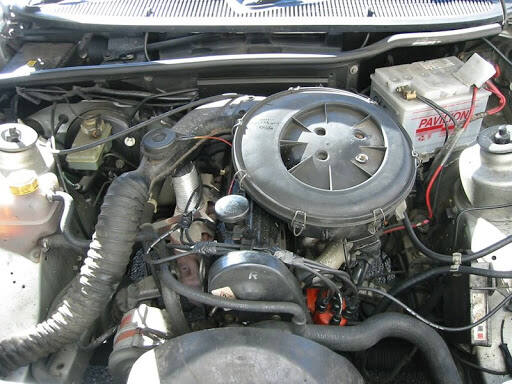

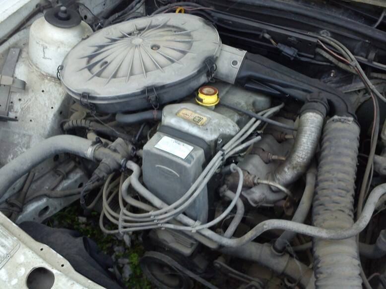

BorniteIdentity Posted June 1, 2020 Share Posted June 1, 2020 Run out Sierras could have either CVH or Pinto in 1.6 flavour. They’re totally different to look at - the Pinto’s look as old as Father Time himself whereas the CVH has a giveaway silver top. That’s a CVH. Pinto is also distinctive I’m really keen to see how this turns out - mainly because the obsession with Cosworth replicas has been done to death and I’d love to see one done well with a V8. Link to comment Share on other sites More sharing options...
