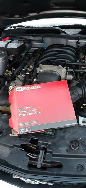

cort1977 Posted January 7, 2021 Author Share Posted January 7, 2021 Made some minor progress with this, new mirror from ebay, not too ruinous. Found some suitable oil in the shed, and a filter from a ford falcon. Like a lot of 'enthusiast' cars there is a load of tosh out there about oil for these. My feeling is that the same engine is used in millions of trucks and police cars, it's not a Ferrari, so Tesco's 5w/30 will be fine. My cheap skate glow of satisfaction wore off however because although the filter is the correct thread and would attach it's too long and wont fit on. So currently waiting on an oil filter after my local factor just sucked his teeth. Did change the air filter, gen you wine motorcraft no less. Also got the wheels off to be refurbished. Not very autoshite but they looked terrible. Makes my yard look more American though, all the best houses have a dented mustang on blocks. Edit - forgot to say - a new battery cured almost all electrical maladies. 69 quid from Tayna for a type 075 that fitted perfectly wasn't bad I thought. A new button battery also restored the central locking so gradually fixing issues from the car being laid up. eddyramrod, Dan302, chaseracer and 9 others 12 Link to comment Share on other sites More sharing options...
