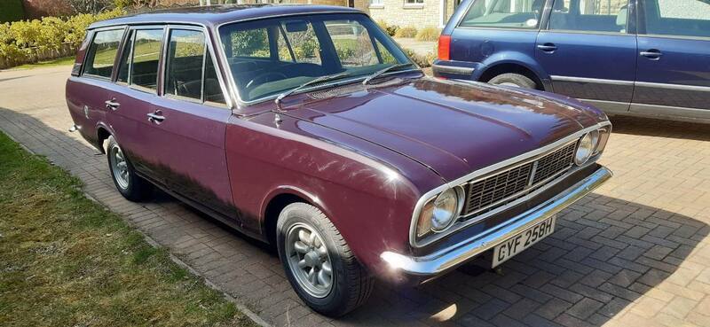

cort1977 Posted April 16, 2021 Author Share Posted April 16, 2021 Now Aberdeenshire council have stopped salting the roads I dragged the cortina in to the light yesterday. I have owned this since 2003 but hardly ever driven it. It's a 1970 Super that had a home restoration in the late 90s by the previous but one owner. At this time it was painted Aubergine and had the interior from a 1600E fitted. It was then sold to someone with too many projects and then put on ebay where i bought it. It's been sitting in various lockups and storage until last October when i collected it from my in-laws garage where it had been since 2012. Trailer borrowed from the very kind @Saabnut. Slightly epic collection from Co. Kerry went smoothly. Once at home I stashed it away in the garage out of the salt. It ran when parked but I wasn't sure what state it would be in after such a long lay up. I re-joined the Mk2 owners club who have a very good spares scheme, still run by a lovely bloke in Essex, and ordered a few parts. A new fuel pump diaphragm, coil, condensor and points had it making hopeful noises. A new battery, jump leads and some easy start had it coughing in to life. Brakes and clutch (hydraulic on these) seemed OK so I took it for a very gentle test drive. Amazingly, everything seems to be functioning more or less correctly. The alternator was making a racket but replacing a missing bolt sorted that. Plans are new tyres, tracking, number plates, service and then drive it and see what else needs doing. The front wings are starting to rust a little but hopefully savable. I will get an MOT done for peace of mind although it's exempt now. I have some black and silver plates I got made years ago but now I'm thinking a set of period correct white and yellow would be better. As a short term goal I'm planning on a day trip with the family on 'drive it day' later this month. crad, NorfolkNWeigh, Sh'Eds and 37 others 40 Link to comment Share on other sites More sharing options...
Tickman Posted April 16, 2021 Share Posted April 16, 2021 That looks lovely cort1977, LightBulbFun and Shite Ron 3 Link to comment Share on other sites More sharing options...
Dick Longbridge Posted April 16, 2021 Share Posted April 16, 2021 2 hours ago, cort1977 said: Now Aberdeenshire council have stopped salting the roads I dragged the cortina in to the light yesterday. I have owned this since 2003 but hardly ever driven it. It's a 1970 Super that had a home restoration in the late 90s by the previous but one owner. At this time it was painted Aubergine and had the interior from a 1600E fitted. It was then sold to someone with too many projects and then put on ebay where i bought it. It's been sitting in various lockups and storage until last October when i collected it from my in-laws garage where it had been since 2012. Trailer borrowed from the very kind @Saabnut. Slightly epic collection from Co. Kerry went smoothly. Once at home I stashed it away in the garage out of the salt. It ran when parked but I wasn't sure what state it would be in after such a long lay up. I re-joined the Mk2 owners club who have a very good spares scheme, still run by a lovely bloke in Essex, and ordered a few parts. A new fuel pump diaphragm, coil, condensor and points had it making hopeful noises. A new battery, jump leads and some easy start had it coughing in to life. Brakes and clutch (hydraulic on these) seemed OK so I took it for a very gentle test drive. Amazingly, everything seems to be functioning more or less correctly. The alternator was making a racket but replacing a missing bolt sorted that. Plans are new tyres, tracking, number plates, service and then drive it and see what else needs doing. The front wings are starting to rust a little but hopefully savable. I will get an MOT done for peace of mind although it's exempt now. I have some black and silver plates I got made years ago but now I'm thinking a set of period correct white and yellow would be better. As a short term goal I'm planning on a day trip with the family on 'drive it day' later this month. I'm looking at your driveway and have come to the conclusion I'm doing life all wrong! 😂 'Tina looks lovely and has clearly been well stored considering it's been sat for almost two decades. Where's the video of the first start though?! cort1977 1 Link to comment Share on other sites More sharing options...
Supernaut Posted April 16, 2021 Share Posted April 16, 2021 1 hour ago, Dick Longbridge said: I'm looking at your driveway and have come to the conclusion I'm doing life all wrong! 😂 Can confirm, have visited said driveway on several occasions now. I didn't even realise the Cortina was so purple! It just looked black when it was hiding in the garage. cort1977 1 Link to comment Share on other sites More sharing options...

cort1977 Posted April 16, 2021 Author Share Posted April 16, 2021 4 hours ago, Dick Longbridge said: I'm looking at your driveway and have come to the conclusion I'm doing life all wrong! 😂 'Tina looks lovely and has clearly been well stored considering it's been sat for almost two decades. Where's the video of the first start though?! Thanks. It's not bad considering but definitely has some dodgy spots if you look closely. Video of first start would have required more hands than i have to spray the easy start, turn the key and hold the camera. My potential assistants were more interested in Minecraft sadly. 1 hour ago, cort16 said: Friggin nora how did I miss you'd got this Mustang, looks great. I guess parts availability for these is pretty decent given there's zillions of them in the states? Have you thought of fitting a Rover 75 badge in opposition of how Rover 75 v8 owners stick Mustang badges on their cars? Parts are easy with Rockauto etc. it's the delivery that stings a bit. Also, a lot of parts are shared with Mazda and Volvo but something like a new bumper would be expensive. Saying that, there's one or two mustangs breaking in the UK at the moment, I got a door mirror for about 20 quid, can't find one for the Sierra at that price. Good point about the Rover link, would they let me in to the Pride of Longbridge as it has a Rover engine? 2 hours ago, Supernaut said: Can confirm, have visited said driveway on several occasions now. I didn't even realise the Cortina was so purple! It just looked black when it was hiding in the garage. We should do that again soon. Burnside, Supernaut, Dick Longbridge and 1 other 4 Link to comment Share on other sites More sharing options...

cort1977 Posted April 23, 2021 Author Share Posted April 23, 2021 Little bit of progress with the Cortina this week, getting ready for drive it day this weekend. First up, insurance. Was very cheap but I really should investigate multi-car for the fleet. Next was some new tyres. The old ones were fine but they had been on it since 2003 and were 60 profile so didn't look that great. I went for 175/70 replacements and chose Pirellis on the grounds they were reasonably priced and looked vaguely appropriate without being actual classic tyres. Filled up on the way back and found the fuel filler pipe leaks but not the tank at least. It's been a while since I have siphoned petrol and it hasn't got any better than I remember. It was good to drive a few miles though even if it highlighted some other issues. Most importantly the tailgate seal is cracked and not functioning very well. It may be the shape of the car or some other factor but fumes get drawn in to the cabin which is not great obviously. New seals don't seem easy to come by but I suspect something for a mk 3 estate won't be far off so will give that a try. Other things were various squeaks and rattles, possible leaking fuel pump, throttle linkage is a bit ropey and the driver's window doesn't work. Also, the passenger doors are painted the wrong colour, looks like a BL shade. On the plus side it gets up to sixty with no problems and throwing it in to corners is quite fun once you get used to the slightly unnerving oversteer. Changed the oil yesterday afternoon and put in some new plugs. Tickman, Scruffy Bodger, tooSavvy and 18 others 21 Link to comment Share on other sites More sharing options...
Shite Ron Posted April 23, 2021 Share Posted April 23, 2021 That looks great, nice colour too and I love estates. A mk2 is the only one missing from my fleet, I need to put this right. That would be great for the Cortina’s to Cortina trip next year. cort1977 1 Link to comment Share on other sites More sharing options...

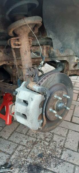

cort1977 Posted October 30, 2021 Author Share Posted October 30, 2021 Not much fleet action here lately but did some work on the mustang brakes yesterday. Although this car hasn't done many miles it does suffer from ford's lackadaisical attitude to rust proofing and living in Scotland most of its life. A juddering from the front at speed and hot brakes was diagnosed as a binding caliper. Sure enough the lower slider was solid and a sweary hour involving progressively bigger hammers and heat was required to get it off. All greased up and the pads looked to be wearing evenly so hopefully all OK. A test drive went well until it started again, I think from the brake on the other side. Not as bad though and went away by the time I got home. Will do the passenger side if it ever stops raining. Car is off for a tidy up and paint soon and planning on a few road trips next year. LightBulbFun, Saabnut and Tickman 3 Link to comment Share on other sites More sharing options...

cort1977 Posted February 7, 2022 Author Share Posted February 7, 2022 Mustang is off for some bodywork love imminently which meant I had to fix the binding brake so it could be moved. I did the other side a few weeks ago so I knew what to expect and sure enough the lower slider was seized. A bit of heat and some percussion with a lump hammer soon had it coming round to my way of thinking. Test drive was still showing a slight judder but some hard stops seemed to get the pistons freed off and everything working smoothly. Should really strip the calipers down but they're working for now and i have to drop the car off this week. Success was confirmed by average fuel consumption creeping up from 12.8 to the dizzy heights of 15.1 MPG. That's freedom MPGs so even better in imperial units - 18.1 MPG. I can live with that and will be interesting to see what it does on a longer run. Picture to show how this car has been parked at the bottom of the sea for most of its life - a summer of hot wire wheel action beckons. Low Horatio gearbox, Dyslexic Viking, paulplom and 6 others 9 Link to comment Share on other sites More sharing options...
