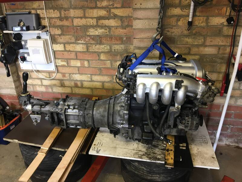

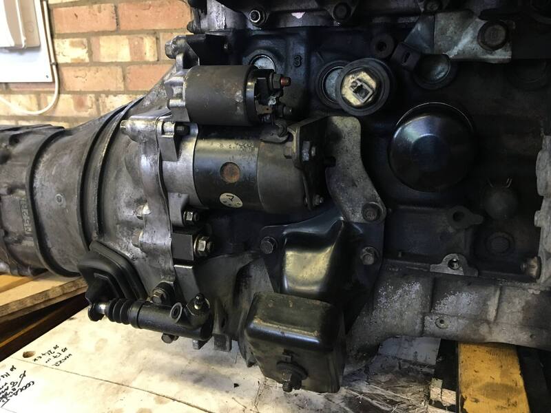

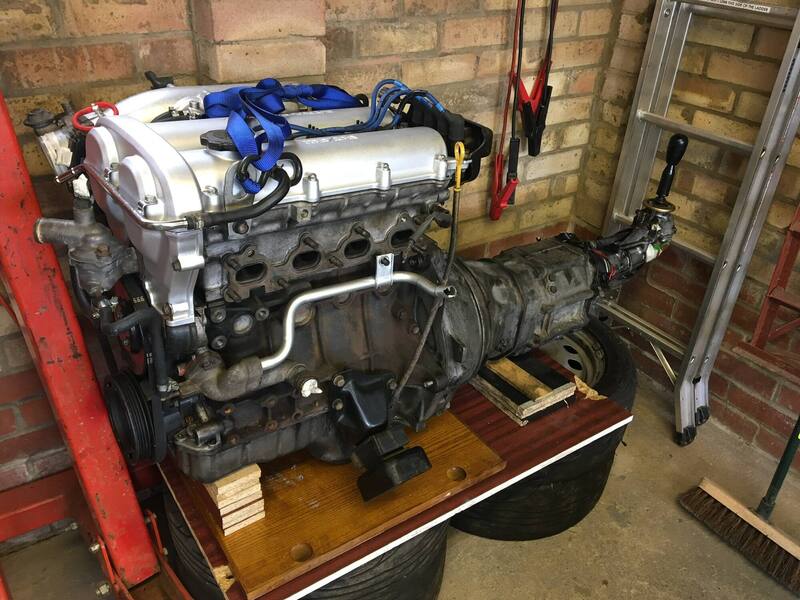

gm Posted May 31, 2020 Author Share Posted May 31, 2020 todays task was to change the leaky gearbox seals perhaps it would have been easier to drain the oil before taking it off the car ? the oil that came out was lovely and clean, must have been done recently although the magnetic plug was a bit swarfy I spent far too long puzzling out why the new seal didn't appear to be the right size for either of these then I realised I was looking at totally the wrong seal and the one I needed to replace was in the cover plate - d'oh ! the old seal looks like it was fitted back to front so a bit of research was needed to verify that back to front is indeed correct. job done, I moved onto the diff seals, ice of piss, had that ticked off in five minutes. so took the mx5 for a quick blast round the back roads - much fun Shirley Knott, Tickman, Jim Bell and 4 others 7 Link to comment Share on other sites More sharing options...

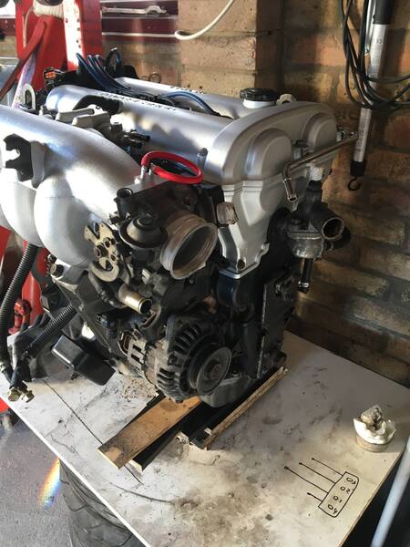

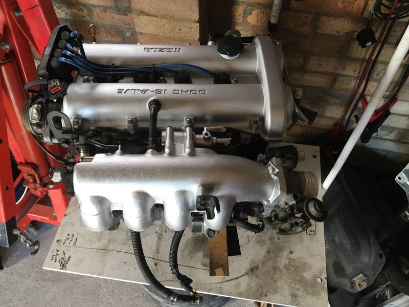

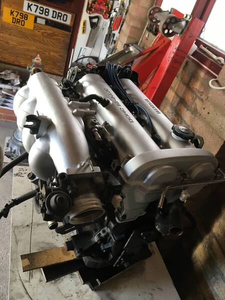

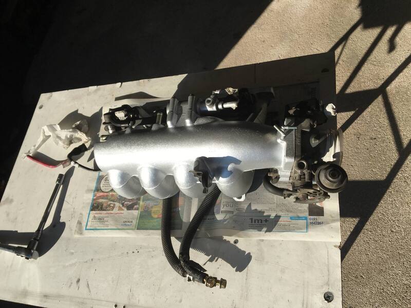

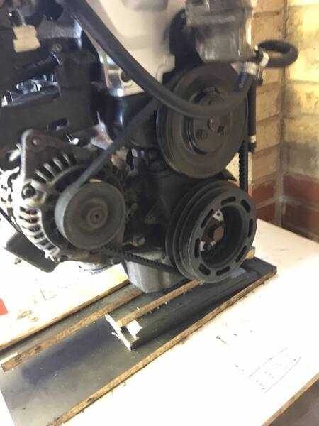

gm Posted May 31, 2020 Author Share Posted May 31, 2020 that manky intake manifold needed to be addressed so off it cam. I tried masking up but that turned out to be a right pain in the 'nads so removed the fuel rail and did it properly. big improvement and to finish off, I refitted the engine mounts and alternator Shirley Knott, CGSB, dome and 8 others 11 Link to comment Share on other sites More sharing options...
320touring Posted May 31, 2020 Share Posted May 31, 2020 That throttle body is crying out for a pipe from an intercooler and some boooozt Good work on tarting it up The Moog and gm 2 Link to comment Share on other sites More sharing options...

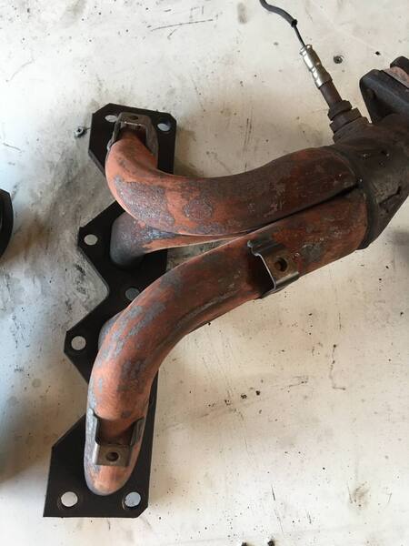

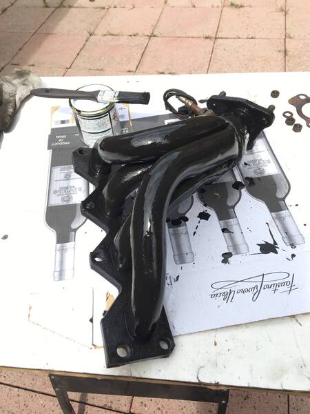

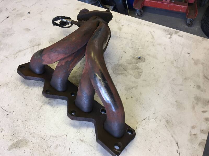

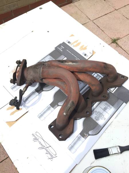

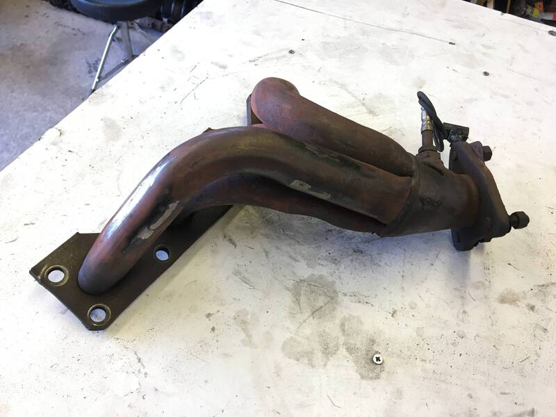

gm Posted May 31, 2020 Author Share Posted May 31, 2020 that exhaust manifold is looking pretty shabby too - ideally I'd like to replace it with a shiny stainless one but that will have to wait. How effective is exhaust paint ? I could try wrapping it but suspect that would look quite clumsy at the 4-1 join any tips, folks ? garbaldy 1 Link to comment Share on other sites More sharing options...
320touring Posted May 31, 2020 Share Posted May 31, 2020 The Halfords high temp paint is good if you go for the darker stuff. Sets well and seems ok with temp. You can also get brush on versions which are not too bad gm 1 Link to comment Share on other sites More sharing options...
gm Posted May 31, 2020 Author Share Posted May 31, 2020 sounds like a nice easy job for tomorrow then, cheers Link to comment Share on other sites More sharing options...
garbaldy Posted May 31, 2020 Share Posted May 31, 2020 Just dont go for red on the exhaust as once heated it goes a nice shade of pink. So the big question is have you decided which kit yet ? Link to comment Share on other sites More sharing options...
gm Posted May 31, 2020 Author Share Posted May 31, 2020 7 minutes ago, garbaldy said: So the big question is have you decided which kit yet ? I'm pretty sure it's going to be the Exocet (I haven't ordered anything yet so there is still time to change my mind) but I really want to go and have a good nosey around one in person. I've posted on the Exocet forum to see if any local owners can help but I don't think lockdown is helping my chances rainagain, Jim Bell and Vince70 3 Link to comment Share on other sites More sharing options...

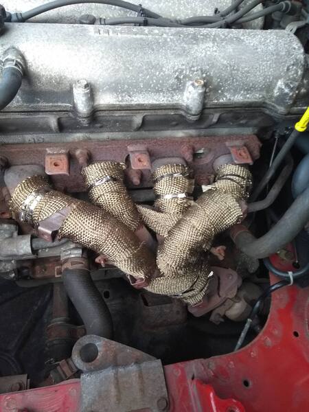

The Moog Posted June 1, 2020 Share Posted June 1, 2020 Dont wrap the exhaust it makes them rot quicker. If you want really fancy stuff you can ceramic coat it, which keeps temps down I might have a spare ecu available at some point - either Speeduino or Megasquirt depending on which one I can get working. Look how easy it is to fit a supercharger - gm 1 Link to comment Share on other sites More sharing options...
Tenmil Socket Posted June 1, 2020 Share Posted June 1, 2020 13 hours ago, gm said: that exhaust manifold is looking pretty shabby too - ideally I'd like to replace it with a shiny stainless one but that will have to wait. How effective is exhaust paint ? I could try wrapping it but suspect that would look quite clumsy at the 4-1 join any tips, folks ? I tried wrapping my manifold but does look a bit crap. Although I was still able to attach the heat shield. I wish I did my inlet now! gm 1 Link to comment Share on other sites More sharing options...

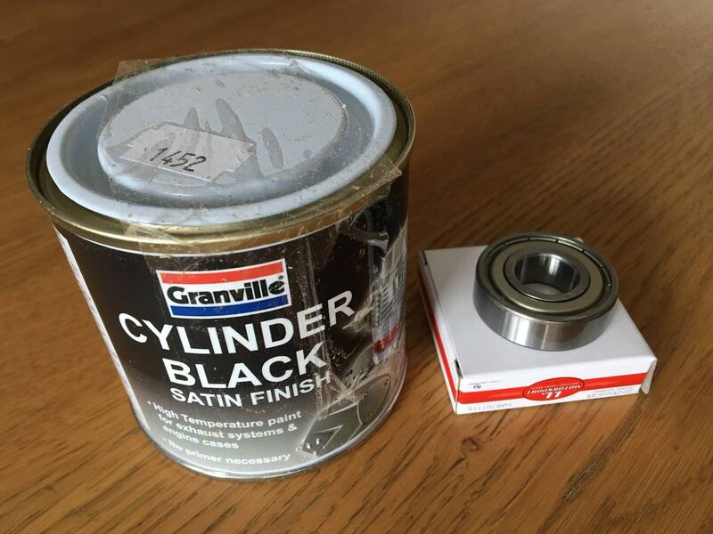

gm Posted June 1, 2020 Author Share Posted June 1, 2020 that’s how I imagine mine would look if i tried wrapping it - I’ll give paint a go for now, will probably buy a 4-2-1 manifold some time in the future the rest of your engine bay is looking smart though Link to comment Share on other sites More sharing options...

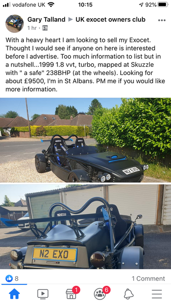

gm Posted June 2, 2020 Author Share Posted June 2, 2020 just spotted this for sale on the owners club page : 238 bhp must be terrifying I do like the black on black colour scheme, might be similar to the look I go for The Moog, Vince70, Craig the Princess and 2 others 5 Link to comment Share on other sites More sharing options...

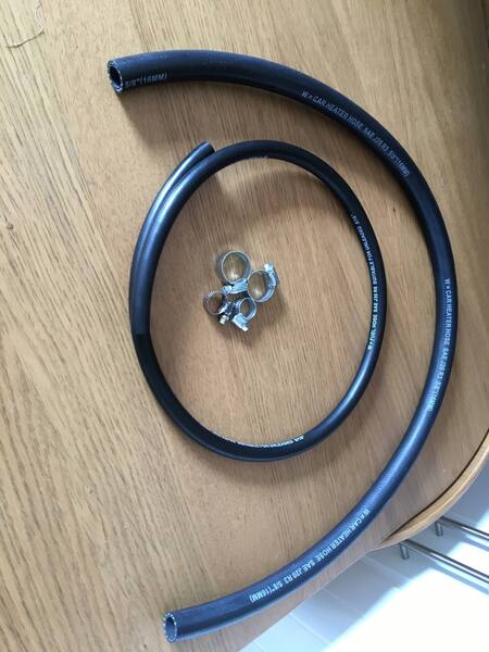

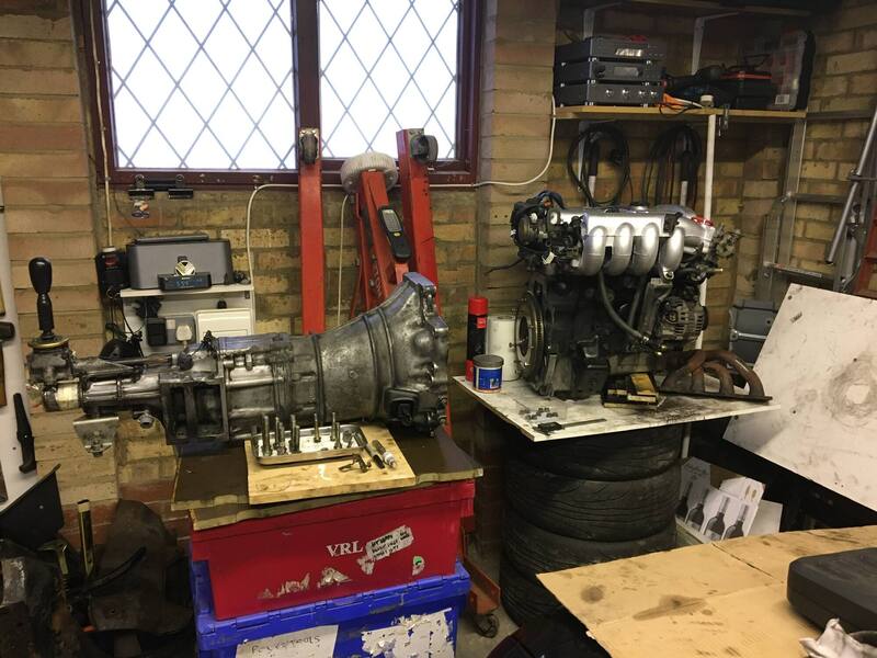

gm Posted June 2, 2020 Author Share Posted June 2, 2020 Yesterday's postal delivery was disappointing, to say the least there was also a Thomas Dolby cd delivered but I can't imagine that is interest to many of you. so stuck for something to do, I wheeked off the scabby looking manifold the factory heatshield will not be going back on so those tabs are surplus to requirements whizz, whizz, grind, grind etc and I think we'll call that ready for paint (when it arrives) Jim Bell, paulplom, Vince70 and 3 others 6 Link to comment Share on other sites More sharing options...

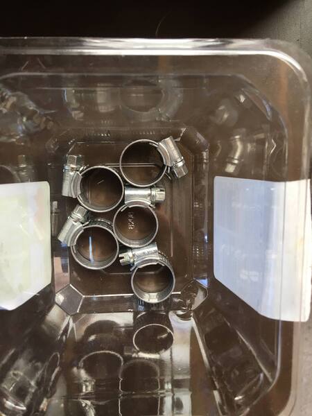

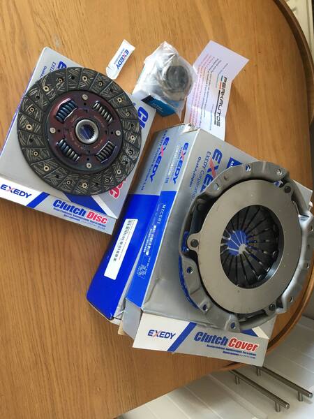

gm Posted June 2, 2020 Author Share Posted June 2, 2020 today looked promising a wee blue card told me that a neighbour had a parcel oh yes, that's more like it - shiney bits the eagle eyed amongst you will have counted only three parts in that kit, the pilot bearing is coming separately in the post except it didn't todays delivery consisted of bugger. even smoll jobs count as progress so I replaced the coolant pipes that feed the intake manifold - exciting stuff with the missing clutch bearing due tomorrow, I got organised for a busy day sonic screwdriver alignment tool prepared (craft knife and insulating tape) release bearing and fork installed let the dog see the rabbit should be a productive day tomorrow loserone, Vince70, djim and 12 others 15 Link to comment Share on other sites More sharing options...

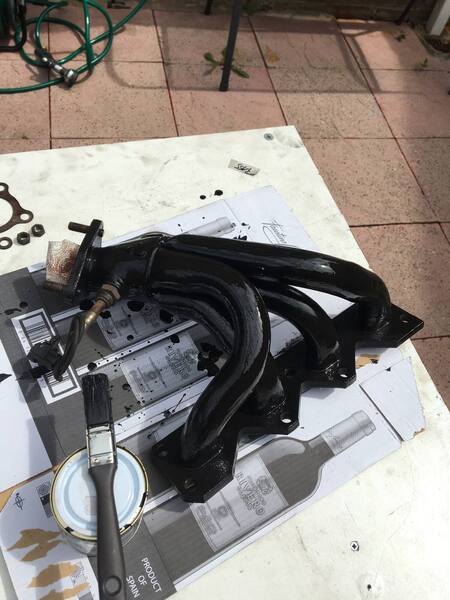

gm Posted June 4, 2020 Author Share Posted June 4, 2020 No progress yesterday because postie was missing in action. but today, he was here nice and early and brought me gifts so I rushed outside and set up my worktable (a cupboard door screwed onto the planks of my aldi workmate) and let's have a go at that manifold a quick wipe down with thinners to degrease and on with the first coat looks pretty good so far, we'll come back to that later on for another coat. LightBulbFun, dome, Tenmil Socket and 6 others 9 Link to comment Share on other sites More sharing options...
camryv6 Posted June 4, 2020 Share Posted June 4, 2020 On 6/2/2020 at 11:07 AM, gm said: just spotted this for sale on the owners club page : 238 bhp must be terrifying I do like the black on black colour scheme, might be similar to the look I go for I bet you couldn't build one the same for that could you ? Link to comment Share on other sites More sharing options...

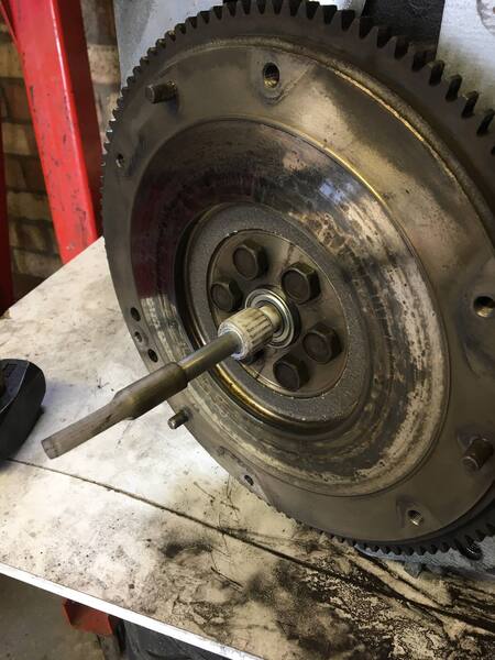

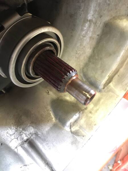

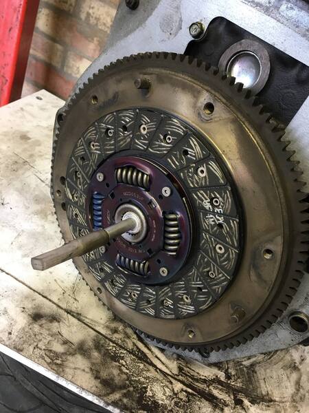

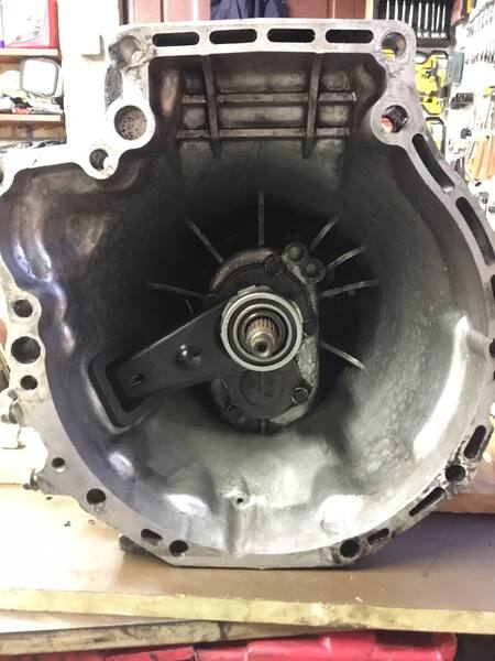

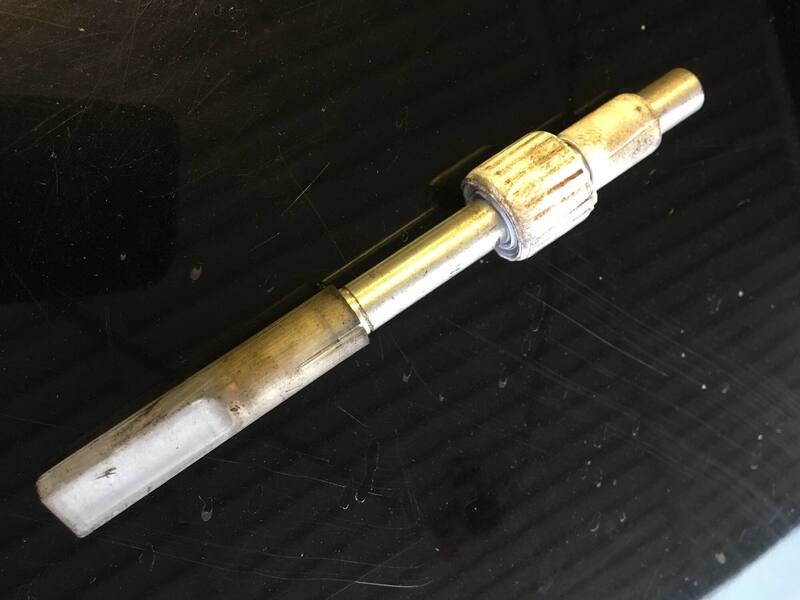

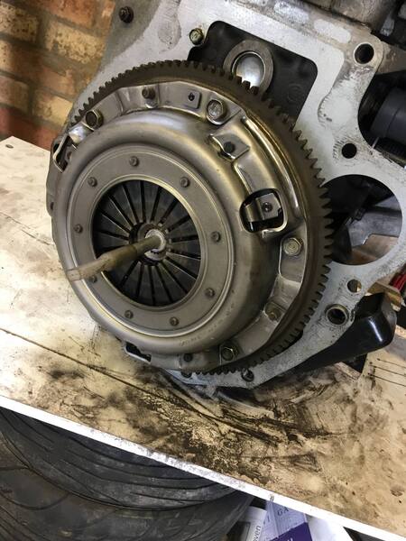

gm Posted June 4, 2020 Author Share Posted June 4, 2020 not a chance there's another one just popped up for sale, non turbo for £8k. but what's the point in buying one ready built ? you'd miss out on all this 'fun' ! anyhoo, now the pilot bearing has arrived, we can get cracking with that clutch. alignment tool doing aligning ooh, that slid on just nice pressure plate all nicely torqued up a lightly greased shaft and let the mating begin @loserone those bed slats came in very handy paulplom, DVee8, djim and 8 others 9 2 Link to comment Share on other sites More sharing options...
