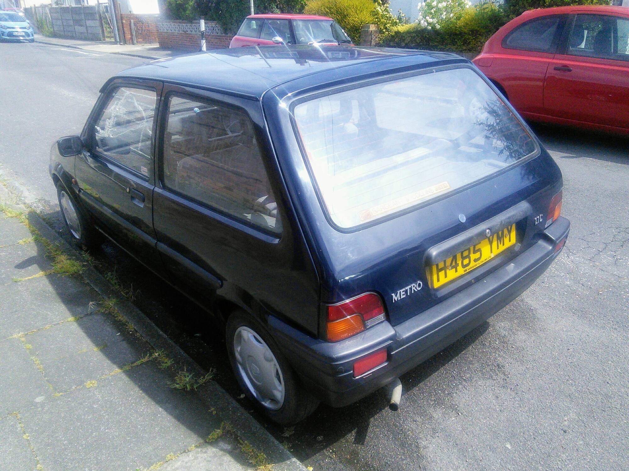

Yummy Rover Metro - HGF confirmed

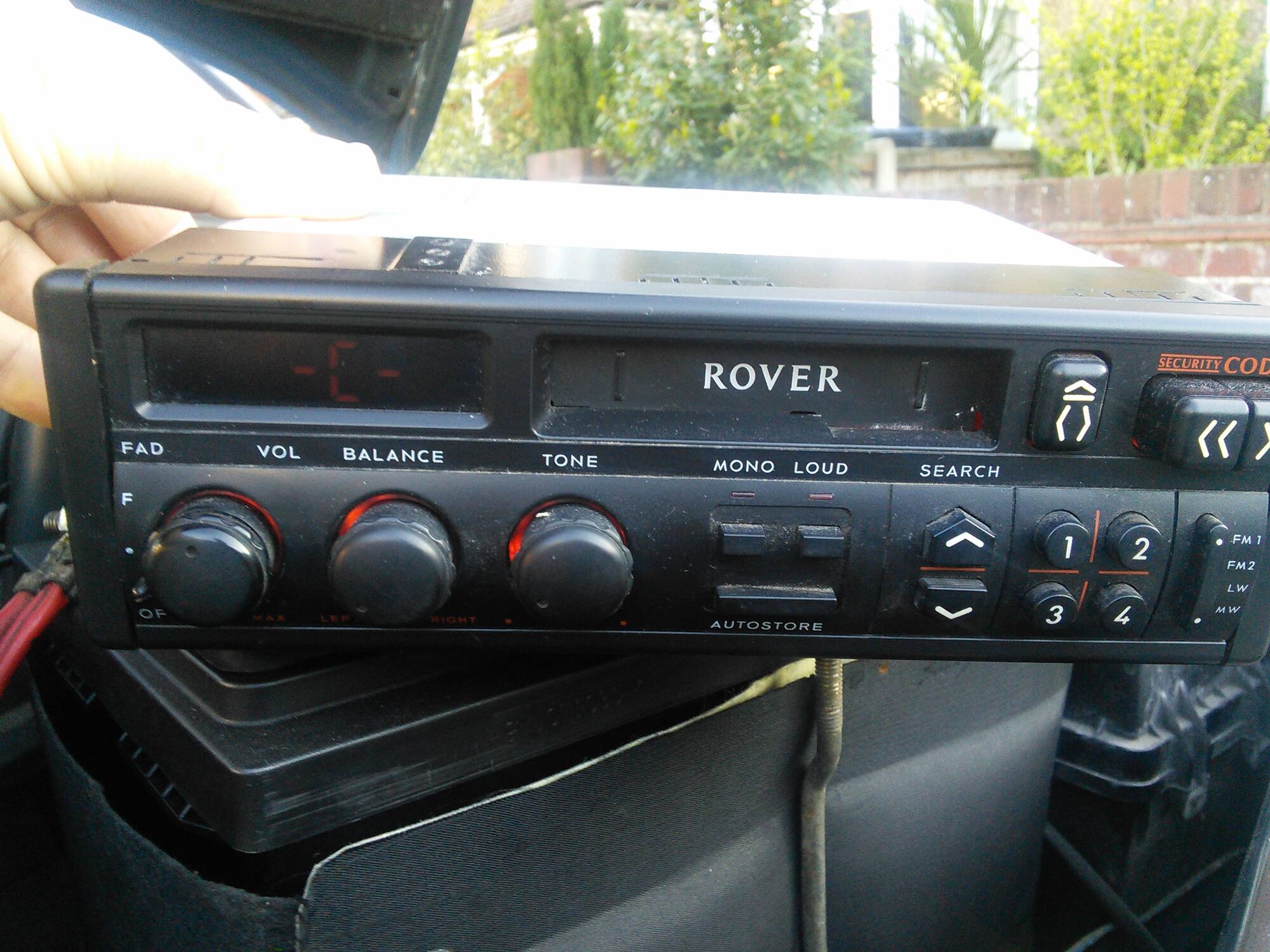

JimH sent me a stereo for this. Then I remembered I had an ISO connector I didn't mind butchering. So I connected it jerry-rigged to the Mondeo battery - and yes it powers up :-). Jim didn't ask for any money for it as he wasn't sure it worked.
I have an error code though - any Rover lickers know what that means?
Is it like a Ford and enter a code - if so how?
yes it wants a code- iirc each preset is used to scroll through the code 1 for digit 1, 2 for 2 etc it may then need autostore pressed or such like

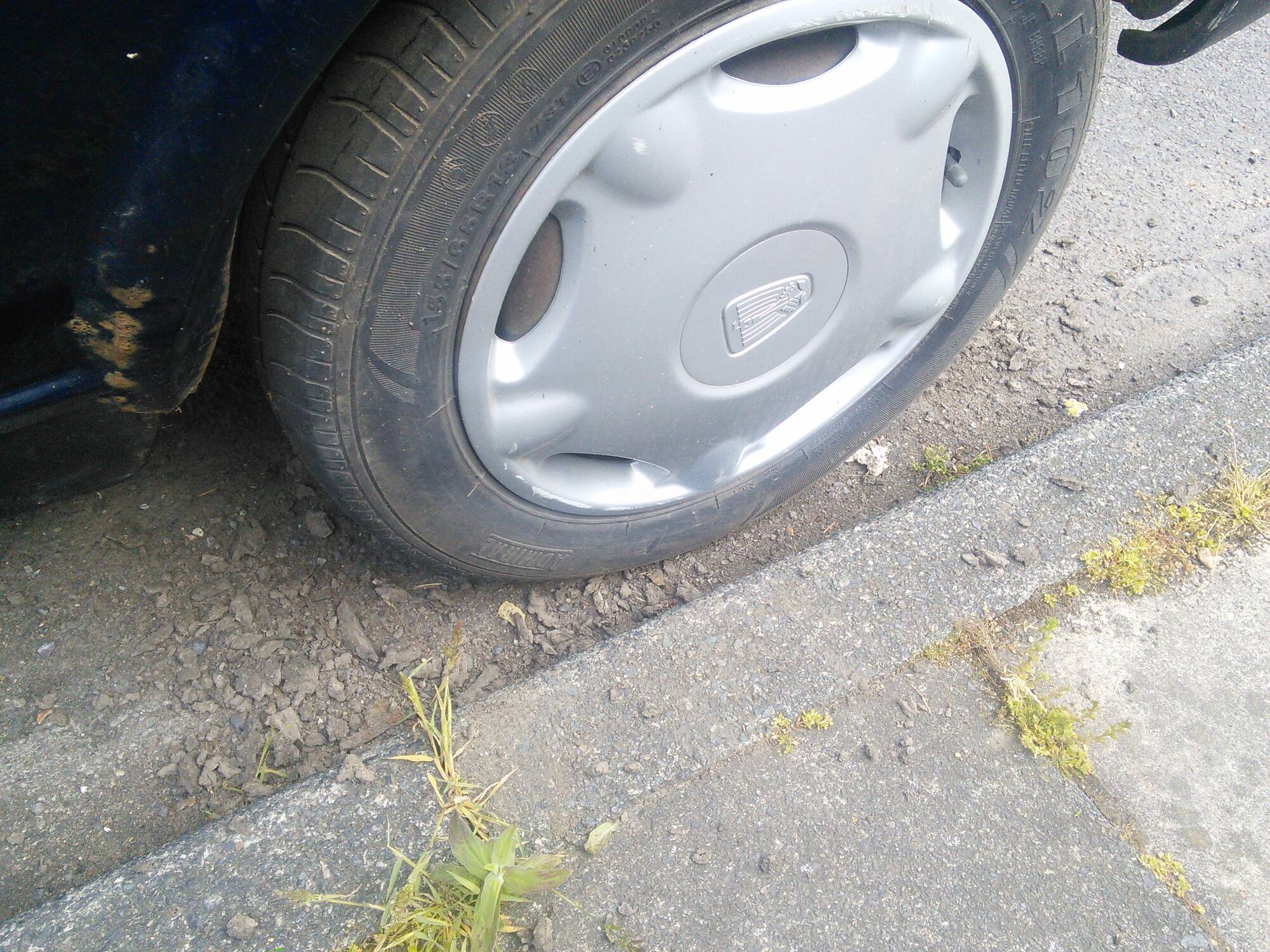

So I'd better tax it again, chuck a bucket of water over it (it's in a bit of a guano covered state), top it up with water and see if the battery has any charge in it.
Not touched since March, bit of choke and starts first time :-).
Desperately needs a wash. Taxed it. Put 500ml water in before I started it, that's gone straight on the ground since I've moved it.

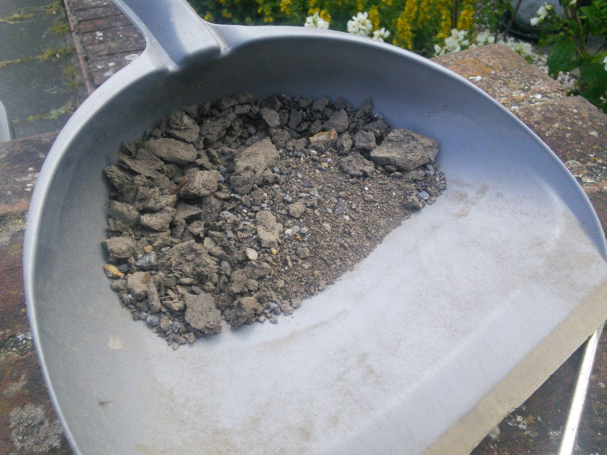

Just been doing one of the worst things you can do with a British car, poke at the rear arch wells. No liners at the rear. This car lived down a track and the screwdriver relieved it of a huge amount of dried on mud.
The suspension set up lends itself to all sorts of nooks and crannies for rust. Just about made the grease points visible now! Two arch sections will be needed for this car to live long time.

Mechanic popped round, did a quick sniff test - instant colour change, so almost certainly OMGHGF.
Oil leak has got a lot worse in lockdown that could be sump gasket or even from the oil filter, he thinks it has been on there a while.
So I got a bit done really, especially as vendor said that as recently as the Autumn he had confirmed the HG was ok at a local garage.
Anyway, mechanic is going to price the HG up for me, given I already have the cambelt/water pump and tensioner ready.
He thinks about £600 to get the rear arches done both sides as well at a pro body shop.
I expect I'll still bail at this point. I could spend a grand on it - and it would probably be worth that, given what people are asking on Autotrader (see below) £2k and £2.5k for exact same model with similar miles, but it's not probably the best idea!
