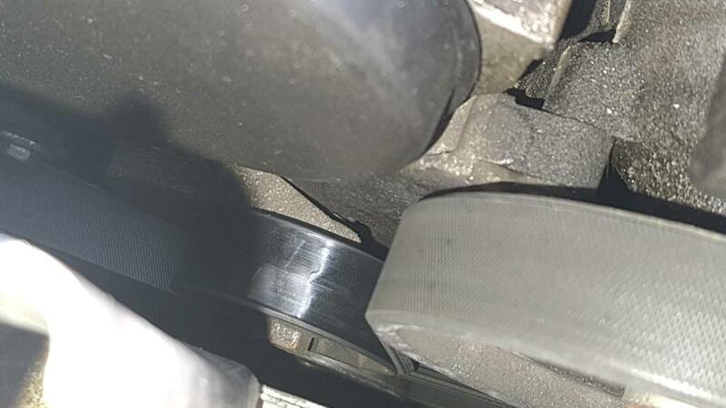

beko1987 Posted July 7, 2021 Author Share Posted July 7, 2021 I'm off work today, taking my stepdad for an eye test at rhe hospital, and spent 10 minutes cleaning out the xsara, in an attempt to stop an interior sounding rattle. I also topped the screenwash up and noticed one of my aux belt pulleys looking a bit worse for wear... I've already got a new belt to put on, but have zero idea what pulley I need. Would probably be prudent to change both of them (think one is a tensioner, the other an idler), @Andyrewdo you know off your head what pulleys a 2002 xsara 110 hdi with air con would need? I also noticed what I assume is the rockercover gasket? Its not dripping off the bottom of the engine so hopefully just a simple change and clean up? Link to comment Share on other sites More sharing options...
maxxo Posted July 7, 2021 Share Posted July 7, 2021 3 hours ago, beko1987 said: I'm off work today, taking my stepdad for an eye test at rhe hospital, and spent 10 minutes cleaning out the xsara, in an attempt to stop an interior sounding rattle. I also topped the screenwash up and noticed one of my aux belt pulleys looking a bit worse for wear... I've already got a new belt to put on, but have zero idea what pulley I need. Would probably be prudent to change both of them (think one is a tensioner, the other an idler), @Andyrewdo you know off your head what pulleys a 2002 xsara 110 hdi with air con would need? I also noticed what I assume is the rockercover gasket? Its not dripping off the bottom of the engine so hopefully just a simple change and clean up? 110? cos intercooler pipe didn't realise the xsara got the 110 (am being stupid i imagine) Link to comment Share on other sites More sharing options...

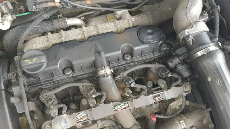

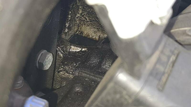

Talbot Posted July 7, 2021 Share Posted July 7, 2021 Yep. 110. It's not a slow car. The oil contamination on that looks completely normal. I wouldn't even bother with it. The pulley will be common to all DW10 engines with AC. beko1987 1 Link to comment Share on other sites More sharing options...
Andyrew Posted July 7, 2021 Share Posted July 7, 2021 Oddly the tensioners cheaper than the idler Tensioner, skf brand 16.75 plus vat Idler pulley 27.14 plus beko1987 1 Link to comment Share on other sites More sharing options...
beko1987 Posted July 7, 2021 Author Share Posted July 7, 2021 2 hours ago, Andyrew said: Oddly the tensioners cheaper than the idler Tensioner, skf brand 16.75 plus vat Idler pulley 27.14 plus Awesome, cheers! May be in touch after payday if that's OK? I'll not begrudge it a rocker cover gasket and a general clean up, I'd like to have the egr valve out and cleaned too but I'll sort the aux belt out first, it'll be more annoying if it let's go Link to comment Share on other sites More sharing options...

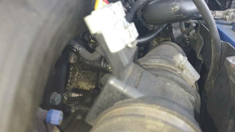

Talbot Posted July 7, 2021 Share Posted July 7, 2021 4 minutes ago, beko1987 said: I'd like to have the egr valve out and cleaned too Trust me, you don't want to try that on that engine in that car. The access is impossible. It's an engine-mount-off-and-lean-the-engine-forwards job. BorniteIdentity, beko1987 and chaseracer 1 2 Link to comment Share on other sites More sharing options...
beko1987 Posted July 7, 2021 Author Share Posted July 7, 2021 2 hours ago, Talbot said: Trust me, you don't want to try that on that engine in that car. The access is impossible. It's an engine-mount-off-and-lean-the-engine-forwards job. Feck I have read that, or rather the lack of finding an easy how to guide or similar clicks further into place now.... On the 1.9dci with laguna2 wrapped round it is was there infront of you. 2 bolts (then chisel the fucker out) it wasn't bad. Nice preventative maintenance on a Saturday morning type job black hands but no* blood I'll put that right from my mind then, sod that! Link to comment Share on other sites More sharing options...
Talbot Posted July 7, 2021 Share Posted July 7, 2021 11 hours ago, beko1987 said: Simply because I cannot be arsed to edit an image at this time of night... the EGR valve is top left of the above image, under the braid covered coolant hose, behind the inlet manifold. It's about 6" tall, and bolted to the exhaust manifold, hence the access needed down the back of the engine. To compound matters, you have an EGR cooler, which is the stainless cylinder on it's side behind the inlet manifold that the braided covered hose mentioned above connects to, and has two stainless flexis connected to either end (these are visible in the above picture, just about, down the back of the inlet manifold. The connection to the exhaust manifold will be rusty. The stainless clips to hold the EGR tube to the valve are an absolute bastard to get undone, and 10 times harder to put back together. Forget it. (Yes, I know you already have) beko1987 1 Link to comment Share on other sites More sharing options...

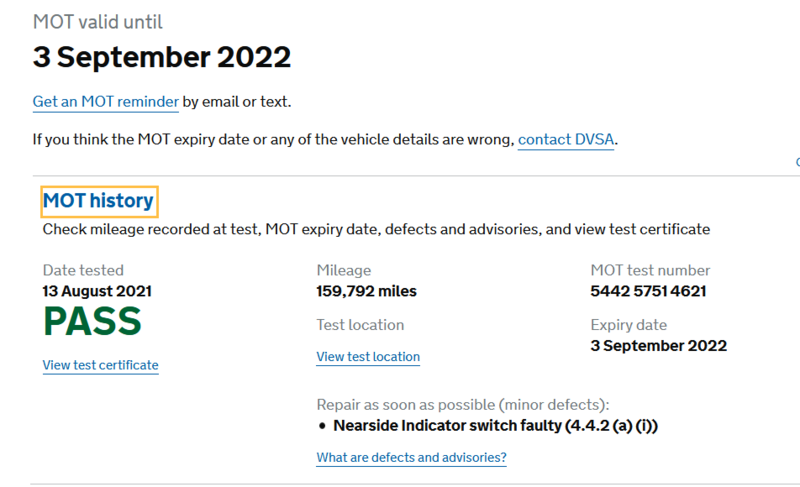

beko1987 Posted August 13, 2021 Author Share Posted August 13, 2021 In the hands of the shite gods now! Hopefully she'll get a pass for her 20th year on the road loserone, brownnova, Rocket88 and 9 others 12 Link to comment Share on other sites More sharing options...
loserone Posted August 13, 2021 Share Posted August 13, 2021 That's a nice looking car that, Sam. 500tops and beko1987 2 Link to comment Share on other sites More sharing options...
beko1987 Posted August 13, 2021 Author Share Posted August 13, 2021 Just now, loserone said: That's a nice looking car that, Sam. Thanks! There's some rust bubbling up on the front drivers wing I keep forgetting to sort but bar that she wears her 160k well! It's been a perfect 'an car' so far! Assuming it passes I'll tap @Andyrew up for some aux belt pulleys and tick another job off the list of stuff that needs doing but not urgently! Sort of hoping it does pass, taking my daughter to my dad's tomorrow... GrumpiusMaximus, Split_Pin, Andyrew and 1 other 4 Link to comment Share on other sites More sharing options...

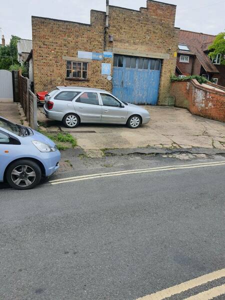

Andyrew Posted August 13, 2021 Share Posted August 13, 2021 Thats a cracking looking mot station too! beko1987 1 Link to comment Share on other sites More sharing options...
beko1987 Posted August 13, 2021 Author Share Posted August 13, 2021 Woohoo! Guess I need to get over my fear of removing the steering wheel, airbag and clock spring to change the stalks... (although im so used to just holding it down to turn left whilst juggling gears and steering it's second nature now...) GrumpiusMaximus, Datsuncog, loserone and 12 others 15 Link to comment Share on other sites More sharing options...
beko1987 Posted August 13, 2021 Author Share Posted August 13, 2021 2 minutes ago, Andyrew said: Thats a cracking looking mot station too! Run by a guy with such a heavy italian accent who speaks so softly I can barely understand him, but it's a wonderful oil smelling place inside! GrumpiusMaximus, Andyrew and Dyslexic Viking 3 Link to comment Share on other sites More sharing options...

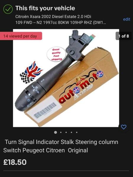

beko1987 Posted August 15, 2021 Author Share Posted August 15, 2021 Are all the xsara indicator clusters the same? Seems their pretty bloody easy to get apart and just change the whole unit. Indeed there's lots of whole units, but the numbers on them are different. But every photo of ever one is physically the same... But every single code like mine is the same format but different. I'm wondering if their just all plug and play and done as long as I get one with the front fog switch. There's a brand new one on ebay for £42 which is bloody well go for if I was a bit more confident... Am I overthinking this and it'll just bang straight in? Link to comment Share on other sites More sharing options...
beko1987 Posted August 15, 2021 Author Share Posted August 15, 2021 Or, since its got to come off anyway, do I buy one of these I mean I've got the magic database to back me up that they said it would work and it doesn't guarantee, and since mine electrically works until it clicks, and that all looks very self contained it should fix the issue... Having watched some ootube videos their fairly simple to have apart, the dreaded clock spring is in the outer housing the entire other side of the module self contained to the side the pcb is. Sounds like a fod job too if I order it tomorrow morning... I'm sure @Talbotwill have a 24mm socket to hand Link to comment Share on other sites More sharing options...
