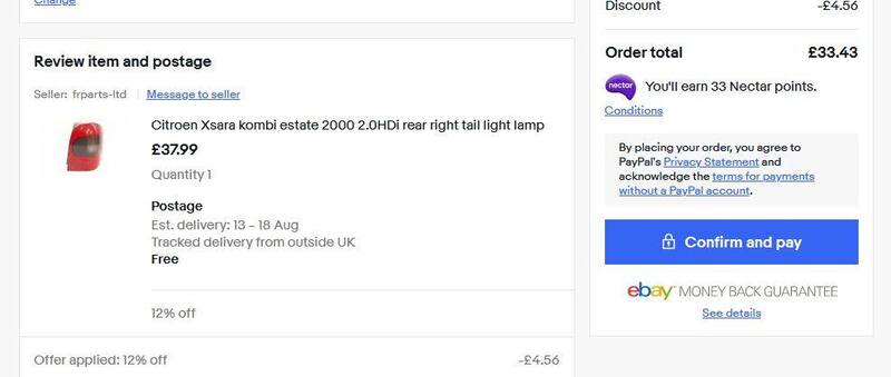

beko1987 Posted August 10, 2020 Author Share Posted August 10, 2020 1 hour ago, paulplom said: I might be teaching yous to suck eggs but, If you type 'xsara -picasso' into ebay the minus sign will filter out all the picasso listings. Not sure on other search engines though. https://www.ebay.co.uk/sch/i.html?_from=R40&_trksid=p2380057.m570.l1313&_nkw=xsara+-picasso+light+cluster&_sacat=0 No I didn't know that, that's very handy. Got slightly different results than making it choose parts that fit my car (with my specs plumbed in). Still no match though. I'd almost like to see if the hatch bulb holders use the same metal contacts as I could cut a bulbs worth out, fit and solder back to the original traces. Cba to buy one to find out though! paulplom 1 Link to comment Share on other sites More sharing options...

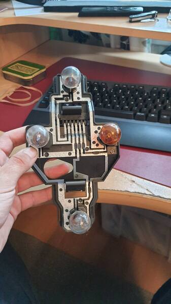

ruffgeezer Posted August 10, 2020 Share Posted August 10, 2020 This one do you? https://www.ebay.co.uk/itm/Citroen-Xsara-kombi-estate-2000-2-0HDi-rear-right-tail-light-lamp/264647944996?hash=item3d9e3f2b24:g:~08AAOSwRzheVj5g Link to comment Share on other sites More sharing options...
beko1987 Posted August 10, 2020 Author Share Posted August 10, 2020 20 minutes ago, ruffgeezer said: This one do you? https://www.ebay.co.uk/itm/Citroen-Xsara-kombi-estate-2000-2-0HDi-rear-right-tail-light-lamp/264647944996?hash=item3d9e3f2b24:g:~08AAOSwRzheVj5g Mmm it's the right size and shape, but from a LHD car... Will it have the same bulb layout etc? My dad found one listed from a breakers and sent me the quote. I've just phoned up and asked if it has the bulb holder, waiting for a call back. If the LHD bulb setup is the same then it's the best price yet! Link to comment Share on other sites More sharing options...
ruffgeezer Posted August 10, 2020 Share Posted August 10, 2020 I think they have two fog lamps on RHD models so I see no reason why not? Link to comment Share on other sites More sharing options...
beko1987 Posted August 10, 2020 Author Share Posted August 10, 2020 Zooming in on the relevant picture the part number exactly matches mine. But I haz the hesitations. Because French... paulplom 1 Link to comment Share on other sites More sharing options...
beko1987 Posted August 10, 2020 Author Share Posted August 10, 2020 Ah sod it, life's too short to worry about it being 100% correct, but given it took more money off at the checkout and the bulb holder part number is identical to mine, so worst case I can use my existing exterior cluster. Thanks @ruffgeezer I'd best look into tyres next ruffgeezer 1 Link to comment Share on other sites More sharing options...

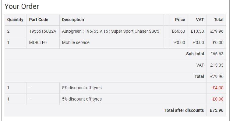

beko1987 Posted August 10, 2020 Author Share Posted August 10, 2020 Sweet, someone just paid me for a little rewiring job I did ages ago and forgot about Free* tail light. Might spend lunchtime tomorrow seeing if I can beat £77 fitted for 2 tyres... Or maybe not paulplom 1 Link to comment Share on other sites More sharing options...

beko1987 Posted August 14, 2020 Author Share Posted August 14, 2020 That was fast! Not even that excited by the spare good lens outside still on the table, this is what I need! Now to wait for it to stop raining and fit it and find out its something else... LightBulbFun and Tickman 2 Link to comment Share on other sites More sharing options...

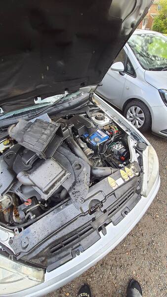

beko1987 Posted August 18, 2020 Author Share Posted August 18, 2020 Well, that will teach me. Got a front sidelight bulb out. No bother, says I... I removed the bloody dipped beam bulb by accident, and can now get neither in! The ABS block is too close to the back of the headlights, and I can't fully work out how to remove them to make the whole job easier... Anyone done it before? There is a white clip of some sort buried down by the radiator, but it started utterly fucking it down so I had to abandon the job and run inside. Link to comment Share on other sites More sharing options...
beko1987 Posted August 18, 2020 Author Share Posted August 18, 2020 I asked on the Facebook group and... Bumper off! Fuck off... I'll remove the air box and give it a go, even if I tear my hands to shreds! Currently fucking it down atm though... Abs is unplugged, bonnet is resting on the plastics I need to refit. Link to comment Share on other sites More sharing options...
beko1987 Posted August 18, 2020 Author Share Posted August 18, 2020 Today started out well intentioned enough. Tyre man turned up at 9.30 and was done by 9.48. So I went out at lunchtime and took the back wheel off and fitted the spare Which held air! Sidewall looks like the desert though! This allowed me to put both new tyres on the front and the 2 not too perished Michelin on the back. Spare went back under the car, fronts look nice now Bulbs for the rear lights haven't arrived, but the new numberplate lights have. One had a lens missing, although both bulbs still worked. Tenner for the pair, it seemed silly not to Does smarten it up Then onto the front, because there's a sidelight out. Easy, right? And after removing and moving the abs pump on its pipes, the air box and unbolting the air box bracket from the chassis I could get the bulbs in and out... And it doesn't work. Known working bulb, doesn't work... Works in the drivers side. So no MOT until this is fixed... I've asked on the forums if it's likely to be the headlight or wiring to it... But I think the bumper is going to have to come off to do it... Ho hum! Link to comment Share on other sites More sharing options...
Talbot Posted August 18, 2020 Share Posted August 18, 2020 Are you sure it's not just a duff bulb holder? I'm sure that was working not that long* ago. beko1987 1 Link to comment Share on other sites More sharing options...
maxxo Posted August 18, 2020 Share Posted August 18, 2020 I really hope for your sake it's not the dreaded comms2000 doing typical comms2000 fun i'd be quite tempted to clean the hell out of the connector and bend the pins slightly so it makes a better connection typical stupid french design though, it;s always the headlight bulbs which are a total nightmare or as above it could be corrosion on the lamp holder, i do know PSA headlights tend to get damp inside pretty quickly beko1987 1 Link to comment Share on other sites More sharing options...
beko1987 Posted August 18, 2020 Author Share Posted August 18, 2020 Think my plan is to just ignore it for now, then the next free Saturday I have (rain or not) have the front bumper off so I can check everything properly and get my multimeter on the pins Could do it at the FoD on Saturday but again, it's a bit far away if it all goes wrong! Link to comment Share on other sites More sharing options...

beko1987 Posted August 18, 2020 Author Share Posted August 18, 2020 26 minutes ago, plasticvandan said: Who did you use for tyres beko? National tyres. It's got 2 £33 autogreens on it, and very round and black they are too! plasticvandan 1 Link to comment Share on other sites More sharing options...
beko1987 Posted August 19, 2020 Author Share Posted August 19, 2020 Boom! My stop/tail light bulbs came. Was 20p more to buy many... So when the rain paused I went out, plugged the new bulb holder in and... Still no sidelight However I was reading this morning and the ever brilliant French car forum came up. Turns out there's 2 fuses for the sidelights, and they work on the diagonal corner, so I presume the car isn't in full darkness on one side if one goes. Clever, but FUCKING ANNOYING, I cut my hands to shreds in vain. Aha Bunged a 10a in and Of course both sidelights at the front are now bloody different, but they work, I never have them on their own, it's either no lights or headlights, they'll pass the test (hopefully) Next job now I think, get it in for a test... Whilst everything needed works paulplom, Tickman, Broadsword and 4 others 7 Link to comment Share on other sites More sharing options...
