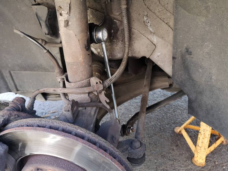

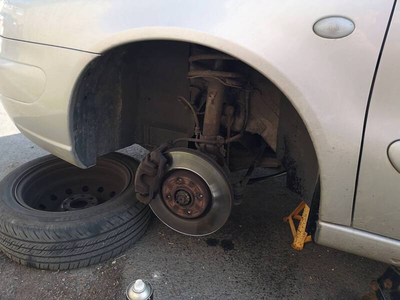

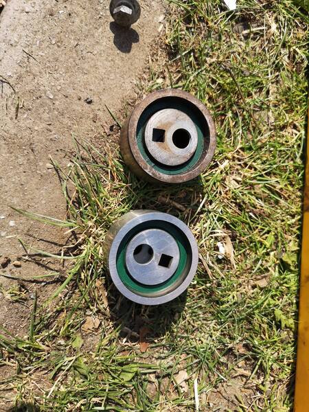

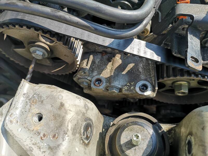

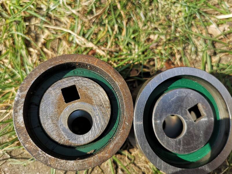

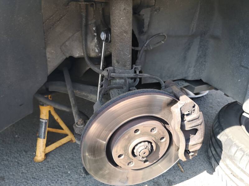

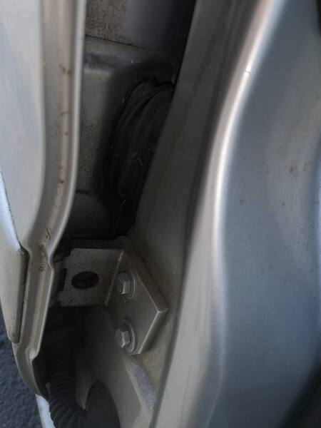

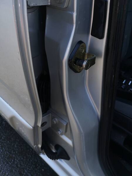

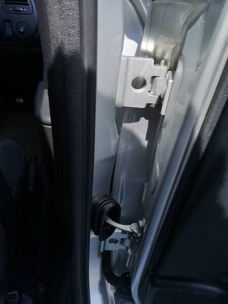

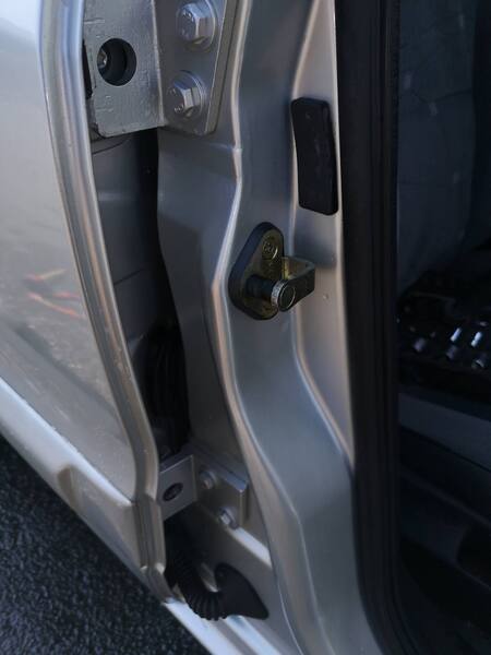

beko1987 Posted April 10, 2020 Author Share Posted April 10, 2020 Yep, enterprise. X2 as well, due to the abortive first try! Anyway, lovely day here so I got out on the car and clonk be gone! Nice and simple! But splitter did actually work fine on the lower one, but the angle of the upper made it impossible, so vice grips around the inner with the boot ripped off worked wonders! Bloody shame the oil hasn't turned up as its a perfect day for it, but I'm having a cup of tea then have some more jobs I want to tackle! Shirley Knott, LightBulbFun and Coprolalia 3 Link to comment Share on other sites More sharing options...

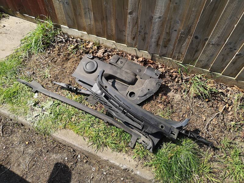

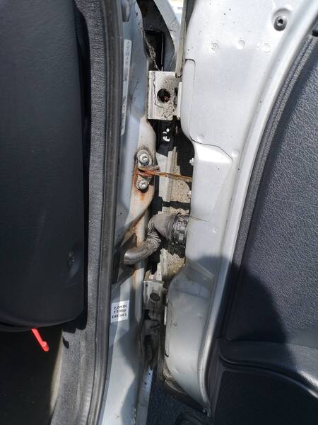

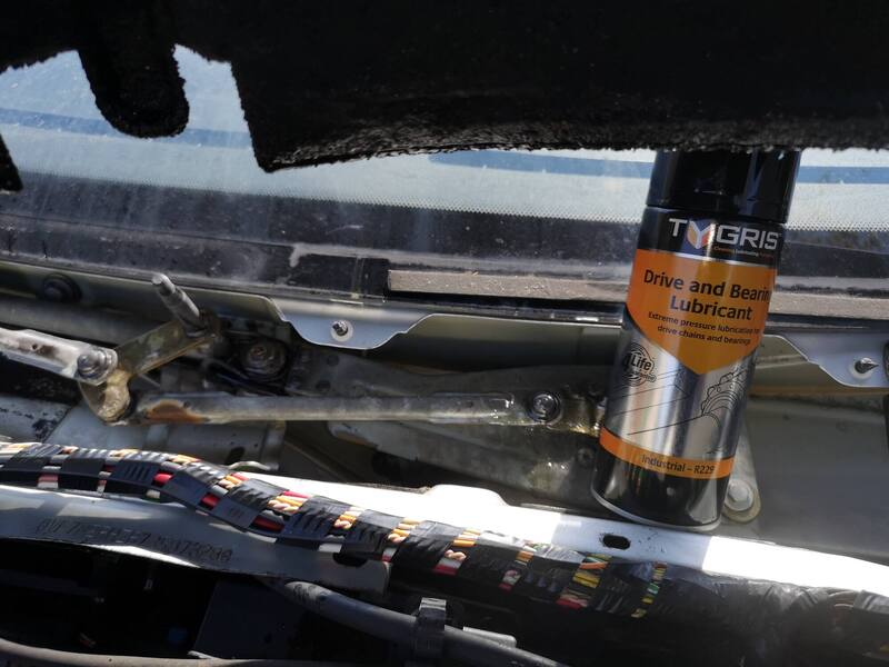

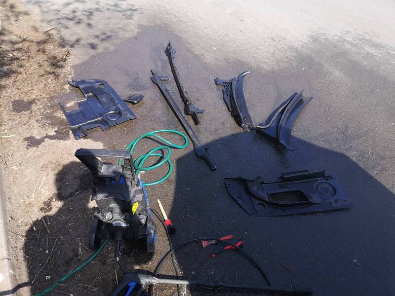

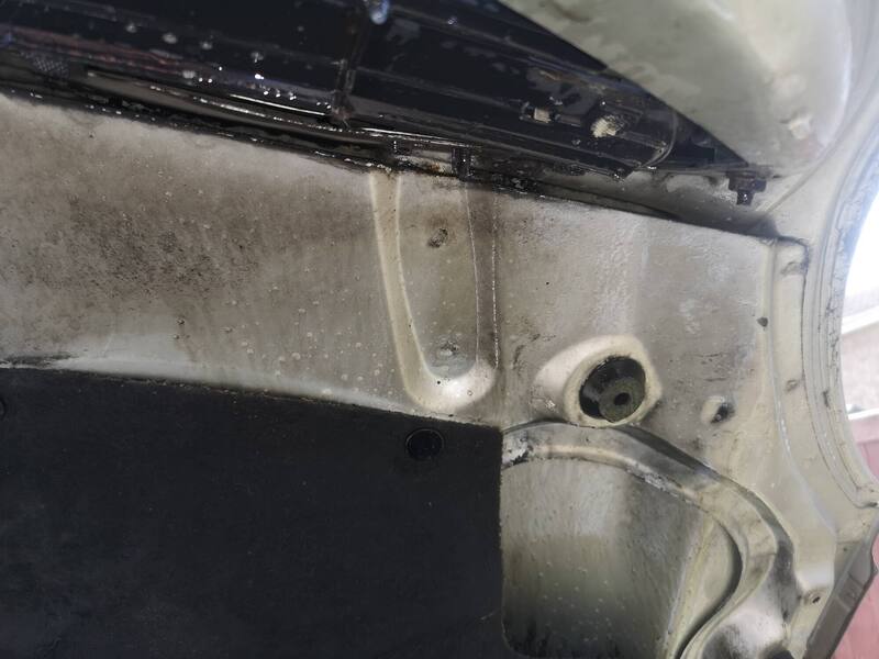

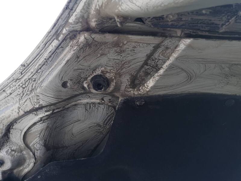

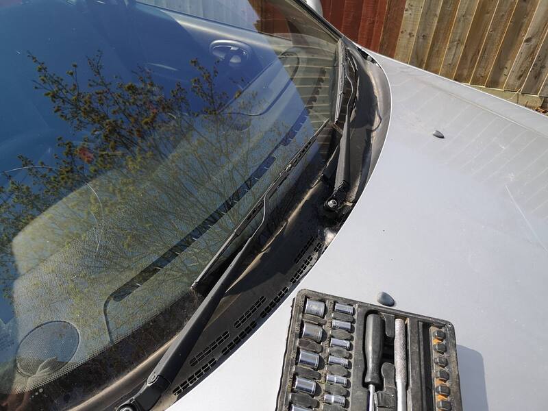

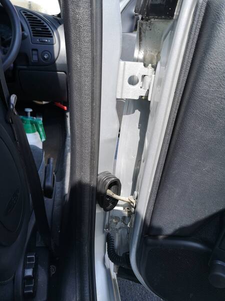

beko1987 Posted April 10, 2020 Author Share Posted April 10, 2020 So, on with less important jobs! But a key one on all old citrii (despite being an 02 plate this thing is basically a ZX) is the scuttle panel. So off with the wipers Then off with a cover over the wiring loom as it crosses the engine bay, then the loom lifts out of it and drapes across said aformentioned engine in the bay, then the bottom channel unclips from the bulkhead. Very soon we had a pile of plastic and I immediatly noticed the grille for the fan intake was off. I had a feeling about this as for the last few weeks there's been a leaf stuck in the motor... Got a vacuum out and cleaned alll the dead foliage and twigs from everywhere Then I got the pressure washer out and blasted it all clean. But it's such a lovely day, and I have such little else to do that 4 minutes later I had assembled all equipment needed for a bit of an engine bay clean... Everything got rinsed, scrubbed wit ha heavy G101 mix then rinsed again,, including all the removed plastic which came up a fucking treat! That done, and with it being in the full sun drying nicely I accidentally opened the drivers door... Rinse rinse squirt squirt scrub scrub with 4 different brushes two rounds of that and a final rinse later and it's about as good as it will get/needs to flipping be. So I opened the back door and repeated, but with added mud I'd JUST finished rinsing the back door off when my pressure washer hose burst and sent itself dancing around the street like a snake on ket FFS Buggar, hoiked it all back into the garden Bit of a pisser really as I would have gone round the entire thing, then by the time that was done the sun would be over the other side of the house and I'd have probably washed it. Was eying up the filthy but genuine floor mats too, wouldnt have taken 2 minutes to set the Vax up for wet suction and it's the perfect day for it. Arse. Grabbed a cloth and wiped up all the now clean door shuts (well, 2 of them) I then smashed the engine bay back together, with liberal application of this all over the plastics And an even more liberal application of this on every moving part of the wiper linkage, bonnet hinges, latch and the 2 door hinges and check straps (went over with a can of brake cleaner first to flush the old shit out) And it looks OK. At least I'll be able to go 5 minutes when changing the cambelt before getting dirty hands Come in now for some lunch, then there's a few other little jobs I want to tackle in the interior, but the pressure washer breaking is a pisser. Now I need to go and see how expensive just a hose is vs an entire already cheap pressure washer (has to be a nilfisk as it fits my snow foam lance, and a new lance will cost more than another cheap nilfisk! Enjoyable day so far though! paulplom, Shirley Knott, Stanky and 7 others 10 Link to comment Share on other sites More sharing options...

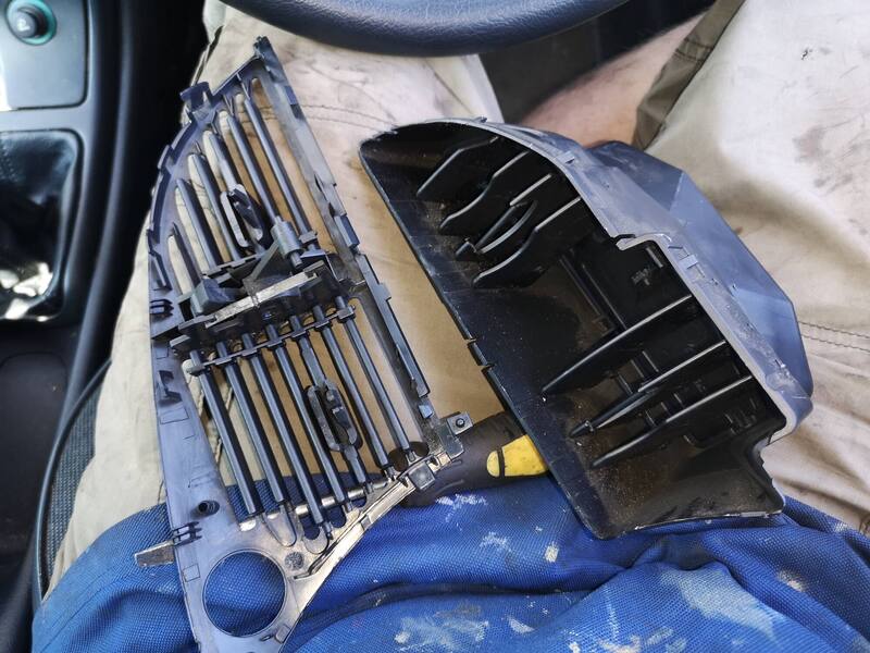

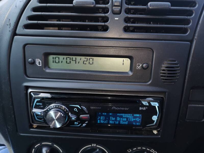

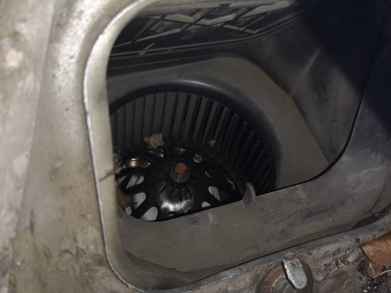

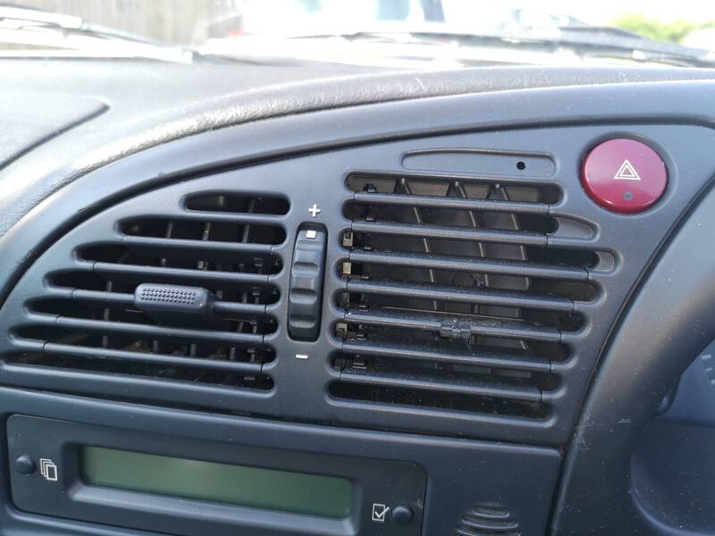

beko1987 Posted April 10, 2020 Author Share Posted April 10, 2020 And the last job! When I cleaned the inside at my dad's I took the air vents off and washed them as they were filthy, and forgot to align the vents up when reassembling it Some levering later And alignment before closing it up again Still fuck all air comes out of said centre vent though, if I could be any more bothered I'd have a Google, but tbh I roll with the windows down in this weather anyway... (aircon is a bit cold, but not enough. Its had many regasses too, every 5 or so years so I'm hoping with a gas up it'll be less shit for a fair few years) Also confirmed that the outside temperature sensor is broken Because its certainly not 1 degrees out there. It's either broken or needs the radio to work, either way it displays the clock unless I push the button so meh. Done now. All tidied up and in the process of putting everything away the porch and undersink cupboard is tidy. Went for a shakedown run and it's silent* again! Mrs6C and The Moog 2 Link to comment Share on other sites More sharing options...

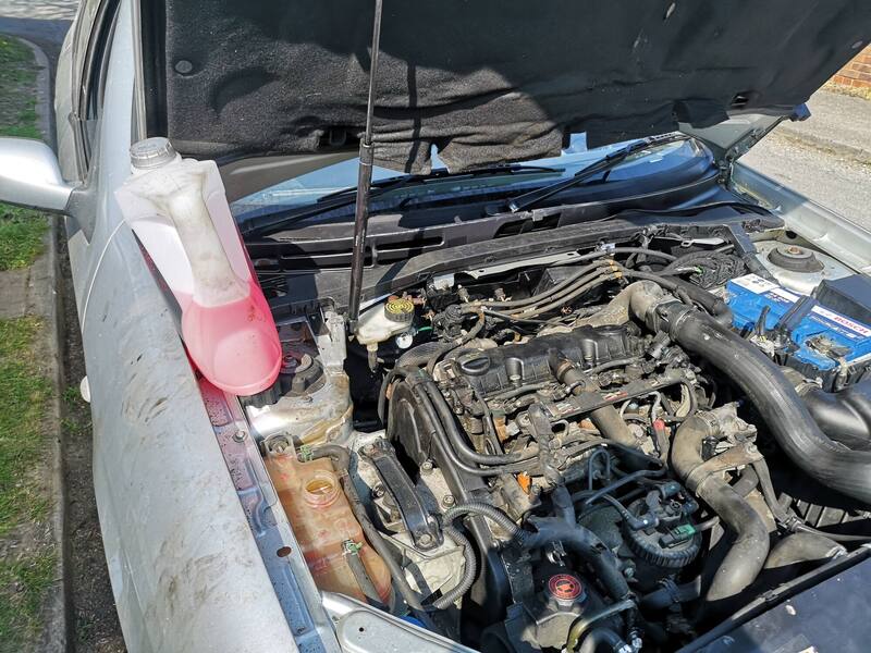

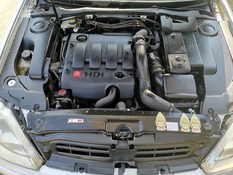

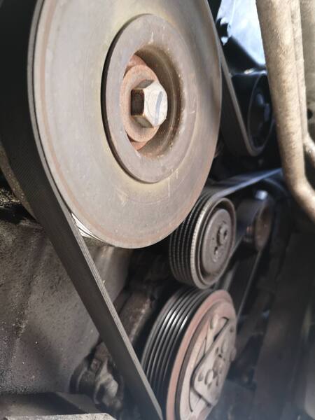

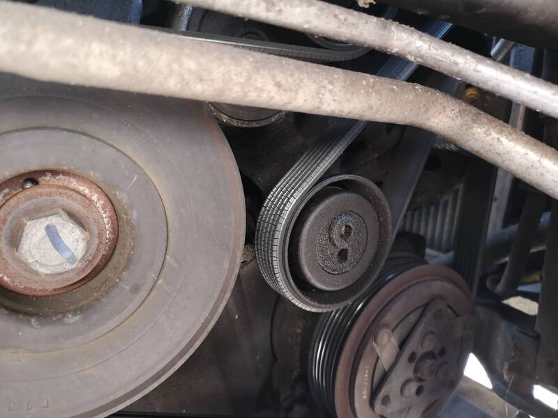

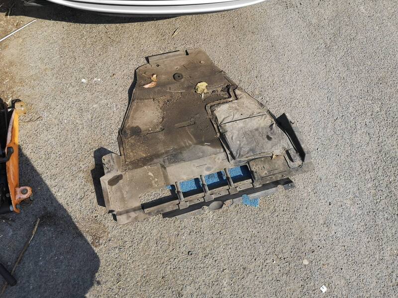

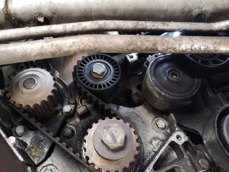

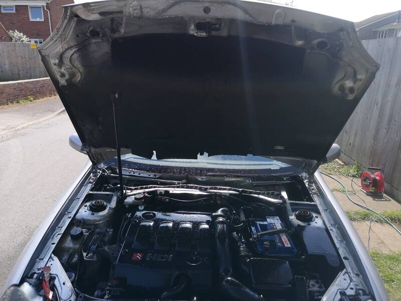

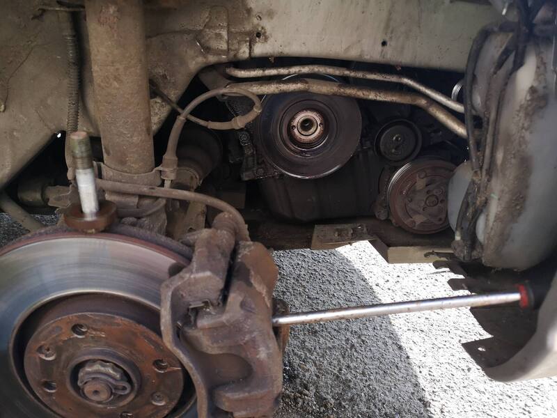

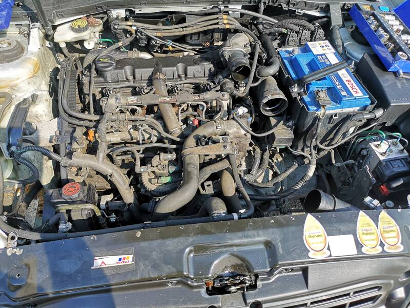

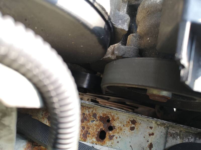

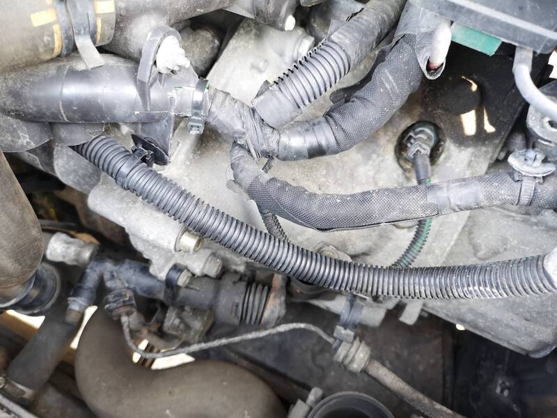

beko1987 Posted April 11, 2020 Author Share Posted April 11, 2020 Been a good day so far! By 8am I had the arch liner off, and took a picture of the little birds nest under there Then hoiked the fucked looking aux belt off (Need a new one of those) Things generally went OK then, bar the how to video I followed was for a non ari conditioned car, mine has pipes running right where the tensioner hole is on the tensioner.... They've been bent a bit and then there was access! Car's still got its undertray too! Held in with 3 bolts, 2 screws and 1 original 1/4 twist fitting. Could jack the engine then (and lowering it loads helped too) Hello! Belt looked fine, could have gone on for a few more years... The pulleys are the same INA part as I bought too, so that's good I then released the coolant.... it was very oily, but not mayo, so I'm wondering if there's something in the new radiator it has that's caused the oil to mix with the coolant a bit.... My plan is just to act ignorant and fill up with fresh and see how it goes, if I need to change it again in 6 months but it becomes clean that's OK And there we go! As of now, the new tensioner, pulley and waterpump are on, the belt is on and tensioned too, and the egnine back on it's mount. I'm going to have a cup of tea and a fag then re-assemble the whole thing, change the thermostat and see if it explodes or I need to back the tensioner off a tad when I turn it on! LightBulbFun, Shirley Knott, Coprolalia and 5 others 8 Link to comment Share on other sites More sharing options...
rickvw72 Posted April 11, 2020 Share Posted April 11, 2020 I’ve been using some OAT type antifreeze lately, that feels a bit oily. Got it in 4 different cars and it’s the same in all of them. beko1987 1 Link to comment Share on other sites More sharing options...

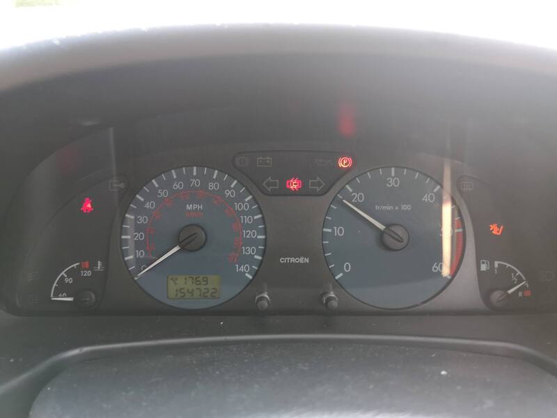

beko1987 Posted April 11, 2020 Author Share Posted April 11, 2020 Fires up a treat! Belt doesn't seem unhappily tight so I'll whazz the aux belt and covers back on! Andyrew and LightBulbFun 2 Link to comment Share on other sites More sharing options...
beko1987 Posted April 11, 2020 Author Share Posted April 11, 2020 All together! Now bleeding it and hoping it doesn't omghgf doing it as the zx nearly did! paulplom and LightBulbFun 2 Link to comment Share on other sites More sharing options...
beko1987 Posted April 11, 2020 Author Share Posted April 11, 2020 I'm being really fucking anti social... It's silent here has been all day... Brum brum Link to comment Share on other sites More sharing options...
beko1987 Posted April 11, 2020 Author Share Posted April 11, 2020 Still not up to temp! Halfway Link to comment Share on other sites More sharing options...

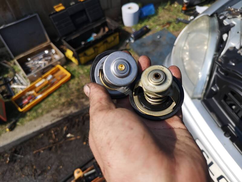

beko1987 Posted April 11, 2020 Author Share Posted April 11, 2020 So, after a break I fitted the new thermostat Then because I removed the air box to get at the starter (which I didn't even bother locking in the end as I couldn't find the hole) I hoiked the filter out and it was a bit dirty Luckily it was a posh bosch one, and by simply peeling the white layer away to reveal the blue underneath (see top pic, stupid phone) Brand new that is, ace! 12 months time the blue layer can be peeped and it'll be a regular air filter then! Then came bleeding and it took about 45 minutes... The neighbors went inside from their gardens, I need to apologise later But after lots of this and way higher it came to life, and eventually the engine fan kicked in. Lobbed everything back together bar the undertray as the oil will come next week/I'll complain, get a refund and get it from elsewhere) and 2 nuts that hold a load of solonoids and vac stuff on the firewall as it's right above the turbo pipe which was fucking hot! Just been for a shakedown drive to socially distancely collect a vacuum and it deffo needs a wash now! Bonus phonecall from mummy kins earlier too, stepdads bought us a pressure washer (a nilfisk too so it fits my lance, plus they've got metal pumps not plastic like the karcher ones) and had it shipped to me. Said when I've done the car he'll have it for their garden, and I can just borrow it when needed, which is ace as I can have porch space back! I need a shower, I'm knackered but I think I've done what I've not done for a while and actually add some value to a car! Need to put the wheel trim back on too... 500tops, holbeck, Mrs6C and 11 others 14 Link to comment Share on other sites More sharing options...

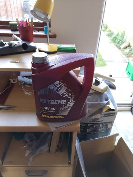

beko1987 Posted April 11, 2020 Author Share Posted April 11, 2020 Fuck sake! Having a coffee and a rolly in the garden Ed next door pops his head over the fence, there's a box outside the front door... No idea when they snuck past, wasn't as if the gate next to the big 9 on the fence wasn't open with a fad sweaty oily man lying on the floor infront of it... Id have smashed that in too if I'd known it was there but fuck it, maybe tomorrow. I'm at the achy stage now, and all the cuts on my hands are stinging! paulplom 1 Link to comment Share on other sites More sharing options...
