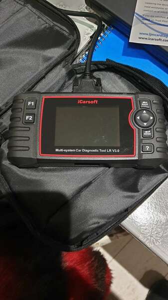

Cookiesouwest Posted December 29, 2022 Author Share Posted December 29, 2022 1 hour ago, Zelandeth said: How's the battery? Multiple systems losing their marbles in a modern can often point at marginal system voltage, especially if it's not been used every day lately. I had read that low battery can cause a Disco, a boatload of issues. Sadly I have no way of testing it. I've also read that a blown tail or brake light can give the same issue. Went out and started it up. No warnings The diagnostic kit can't get here quick enough. Once Mrs C takes against a car, it can be very difficult / nigh on impossible to change her mind.  Link to comment Share on other sites More sharing options...
andyberg Posted December 29, 2022 Share Posted December 29, 2022 10 minutes ago, Cookiesouwest said: I had read that low battery can cause a Disco, a boatload of issues. Sadly I have no way of testing it. I've also read that a blown tail or brake light can give the same issue. Went out and started it up. No warnings The diagnostic kit can't get here quick enough. Once Mrs C takes against a car, it can be very difficult / nigh on impossible to change her mind. Â Multimeter over the terminals will give you a rough idea of idle battery voltage, then check it every day to see if it drops any. A decent battery should read over 12.5 volts. Link to comment Share on other sites More sharing options...

Cookiesouwest Posted January 16, 2023 Author Share Posted January 16, 2023 Due to Mrs Cookie being ill, the LR of many faults has not been used for a tad over a week. So I thought I better give it a run. I turned the key more in hope than expectation, but it did fire into life No warning lights either, which was a pleasant surprise. Well till I was half a mile down the road and the suspension fault came on, max speed 30 mph. Pulled over. Switched off. Back on again. Suspension fault gone But now a hand brake fault Oh well. Got home. And thought I should try the most expensive bit of kit, I've ever bought Yep, I spunked 185 quid on a diagnostic. Anyway, I plugged it in. I should have taken a picture, but frankly I was in shock. 10 plus faults !!! I admit I probably crapped myself, hence no pic. But then, when I restarted, no faults ! Probably is just a battery, but I'm loathe to fork out strong money without being sure. Anyway, its off to the local LR Indy specialist next Monday, to have the revised gearbox sump fitted, gearbox fluid change and investigate, fix the sinking suspension and fix the sunroof drains so the car stops flooding. I'm going to get them to read all the codes (many of which may be historic) and advise. At least the rear lights work. Heres a pic  AnnoyingPentium, Fat_Pirate, andyberg and 1 other 4 Link to comment Share on other sites More sharing options...
AnnoyingPentium Posted January 16, 2023 Share Posted January 16, 2023 3 minutes ago, Cookiesouwest said: 10 plus faults !!! I admit I probably crapped myself, hence no pic. I may have you beat at that one. I'm still not sure what went on here... Cookiesouwest 1 Link to comment Share on other sites More sharing options...
SiC Posted January 16, 2023 Share Posted January 16, 2023 On 12/29/2022 at 7:46 PM, Cookiesouwest said: The diagnostic kit can't get here quick enough Damn I missed this post. You could have borrowed my Foxwell thingy. Does the iCarsoft do all the modules? Number of codes isn't important, it's what they are. My mum's Cayman had 18 codes after I replaced the battery but all related to the many modules stopping talking to each other over time as the battery slowly discharged and died. Key thing is also how many of those codes come back after being cleared. Link to comment Share on other sites More sharing options...
Cookiesouwest Posted January 16, 2023 Author Share Posted January 16, 2023 16 minutes ago, SiC said: Damn I missed this post. You could have borrowed my Foxwell thingy. Does the iCarsoft do all the modules? Number of codes isn't important, it's what they are. My mum's Cayman had 18 codes after I replaced the battery but all related to the many modules stopping talking to each other over time as the battery slowly discharged and died. Key thing is also how many of those codes come back after being cleared. Yes it reads all modules Does some dealer level stuff too. Also has Jaguar software, so if I ever buy one of those I'm covered. I do suspect battery, but as its going to a garage, they can sort it out. Later this week, I will clear the codes and then give it a run. Then read again and see what comes back. SiC 1 Link to comment Share on other sites More sharing options...
SiC Posted January 16, 2023 Share Posted January 16, 2023 What were the codes it pulled? Link to comment Share on other sites More sharing options...
