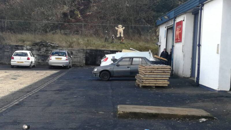

HillmanImp Posted March 5, 2020 Share Posted March 5, 2020 Is nobody going to mention the dead teddy bear? Strung up. Poor sod. His test results must've been even worse. stonedagain, davidfowler2000, The Moog and 8 others 3 8 Link to comment Share on other sites More sharing options...

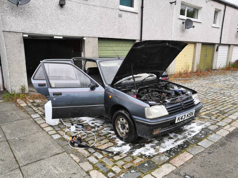

davidfowler2000 Posted March 5, 2020 Author Share Posted March 5, 2020 8 hours ago, Six-cylinder said: Poor thing needs a clean and polish! The vast majority of the muck was from it's trailering from EK to Cumbernauld in the snow. Wet roads and lots of salt. Yay*. Six-cylinder and juular 2 Link to comment Share on other sites More sharing options...

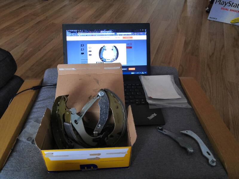

davidfowler2000 Posted March 18, 2020 Author Share Posted March 18, 2020 Dates: Various Some time off work and some decent-ish weather after the MoT allowed for some investigation of parts to see what the setup of the various bits on the 205 were... As with most cars, it's basically just trying to find out what the brake setup is. Seeing as my main personal experience doing brakes on older cars is Volvos usually with Girling fronts, TRW rears and ATE hydraulics, it's nice to have a car that's all the one system - Bendix. autodoc.co.uk would be the main target for finding parts. Euro Car Parts could get... some bits. GSF could get other some bits however the Glasgow branch of GSF closed recently so if I'm going to have to do it mail order, might as well get it all from one place. Also between ECP and GSF, I couldn't get everything I wanted. One week after ordering, two large boxes turned up... Contained in the autodoc order: Front Calipers x 2 Front Discs x 2 Front Pads Front Accessory Kit Front Bearings x 2 Rear Drums x 2 Rear Shoes Rear Fitting Kit Rear Shoes Adjuster Set Rear Wheel Cylinders x 2 Rear Bearings x 2 Master Cylinder Timing Belt / Water Pump Kit Brake Cleaner Tin x 3 1L Brake Fluid Air Filter Oil Filter Circlip Pliers Also from another source, - Driveshafts x 2 In Other News... Drum brakes can get fucked! I mean having to assemble bits of them OFF THE CAR FFS! captain_70s, theshadow, Jim Bell and 12 others 15 Link to comment Share on other sites More sharing options...

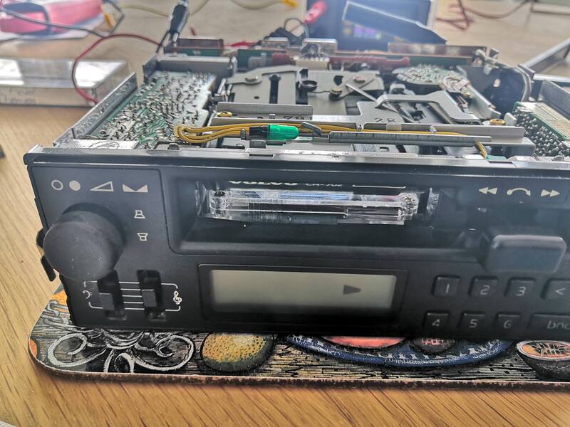

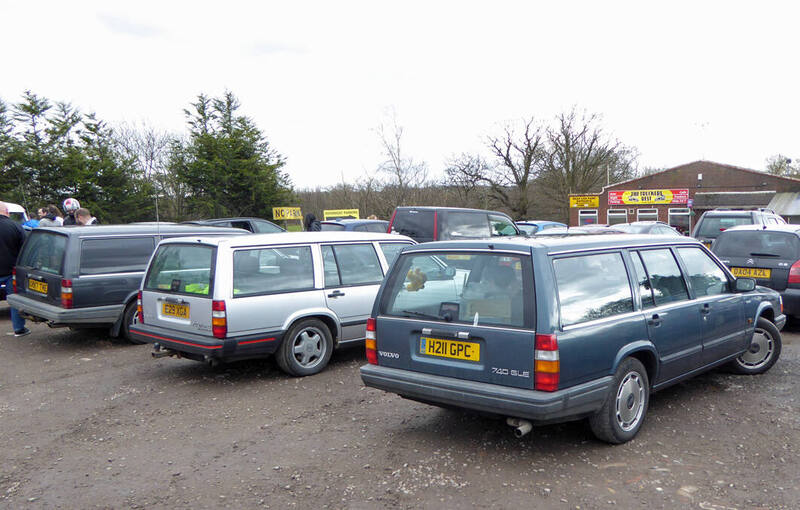

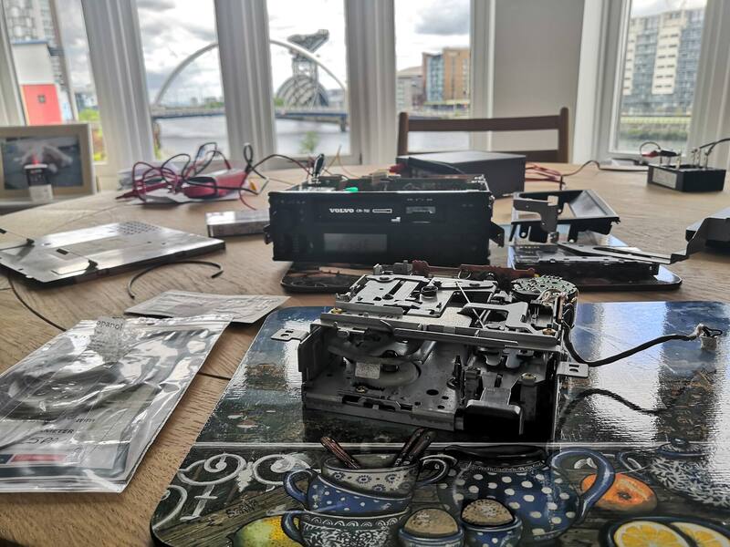

Ghosty Posted June 7, 2020 Share Posted June 7, 2020 Your tape deck broke in October 2017: 1990 and 1987 740 GLEs by max_burton, on Flickr that picture was taken in the Wythall car park as we were comparing GLEs, I drove down with Conelrad and almost passed out at the wheel on the way home (!). On the topic of us having the same car, I've just won a 205 D Turbo on eBay, also a grey five door K plater, except mine has a sunroof. Coprolalia, loserone, Jim Bell and 2 others 5 Link to comment Share on other sites More sharing options...

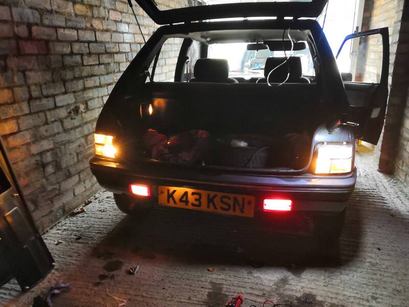

davidfowler2000 Posted July 14, 2020 Author Share Posted July 14, 2020 Dates: Various Lockdown has really put this project back but now that we're allowed to go further than 5 miles for recreation, things can get started again. So to recap the MoT fail sheet mostly consisted of Brakes, Bearings, Doors not working and exterior lighting. With a few odds and ends as advisories. Part were procured including some new tools which I done a review* of... The thing I was MOST concerned about was the doors. Were the latches completely hooped? Was there something more sinister? As it turns out the common failure mode for them is the lever on the back of the exterior handle not returning to it's home position and causing the lock and latch to bind up. Cue many hours of me pulling door cards off and dousing everything with WD40. The rear passenger door which was stuck shut was interesting. All the doors were cured and new locks put in with new keys. Next I thought I'd tackle the rear brakes because I hate drums and wanted to get them out the way. I got the new shoes and a drum on the driver side but the cylinders were not for budging - the two bolts I managed to get moving but the copper brake line is fused to it. I'll get someone else to do that. A few trips up to do some more recon for parts in the meantime. The steel coolant pipe behind the driver's wing had rotted out (TADTS) so a new one was procured from KAM Racing in stainless steel. As an aside some new rubber hose for the injector leak off and some hose for the rear screenwash which turned out to be too short. Tuesday 14/07/2020 Dragged myself out of bed and decided to head up again today with some new bits, a wiring diagram, tools and the power washer. Task #1 get it on charge so it could be moved. The battery hasn't had a full charge in months as it was left connected during lock down. Well I didn't know that was going to happen. While it was doing that off the 740 I did the leakoff hoses. Then out in to the open for it's first bit of summer daylight in 16 years and a wash... Now that I can work on without getting (too) manky by touching anything, it's back inside for the next task - brake lights. Both were non functioning and the fuse was OK. Turns out it was just two dud bulbs so after much footering with the brake light switch and hotwiring, I cleaned the crap off them and got some illumination. They're still dodgy and I could see a blue arc in one of them when I was plugging it in so I'll just replace both. Next - Oil pressure tell tale. Wire had fallen off the pressure switch. And to test that, a startup was in order but more charge was required... So as hinted at, the handbrake tell tale has been acting up. Time to investigate THAT... Easily got it. Took it out for a shufty... So it gets a positive feed from a wire and ground out through the screw. Time to clean those contacts then... And... This has all taken a while 'cos I don't work quickly on cars plus electric gremlins need fastidiousness to track down. Time marching, time to do a checklist: Required - Brake light bulbs, front side light bulb, number plate bulbs, 4mm ID hose at a proper length. As mentioned someone else can do the back brakes because drums can get in the sea. I'll also be leaving pretty much everything on the front end for a garage to do - brakes, driveshafts, gearbox oil seals, drop links, timing belt, water pump - because the front wheel bearings need done and I don't have a press so if someone is going to be in there anyways, they might as well do the whole lot plus working in a small lockup is less than ideal. Anyways I think that's all for today. BONUS ACTION captain_70s, Twiggy, Asimo and 16 others 19 Link to comment Share on other sites More sharing options...
