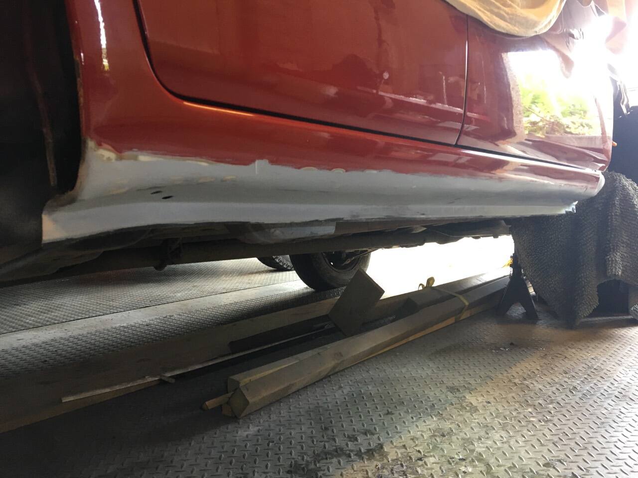

Ian_Fearn Posted July 3, 2021 Author Share Posted July 3, 2021 Drivers side inner sill is all finished now in zinc primer. I’ve got a guy at a panel supplier in Sheffield looking for sill options but short of that the Poland option is looking best. Burnside, BeEP, Shite Ron and 7 others 10 Link to comment Share on other sites More sharing options...
Burnside Posted July 4, 2021 Share Posted July 4, 2021 16 hours ago, Ian_Fearn said: There are 2 options for sills. A complete sill that includes the lower section of the pillars or just the lower part. The lower part is £25 each but out of stock where I’ve tried in the UK. The full sill is over £50 each plus £25 postage. A place in Poland has the lower sills at £65 a pair posted but with VAT and customs/courier charges I’ll probably be looking at over £100 and who knows when delivery…… My next option is to look at fabricating my own. I won’t be able to get the exact profile but you can hardly see it under there and this is supposed to be a budget project. The only company I could think of as I've used them a few times in the past, don't appear to list the newer Panda on their website. Although it could be worth a try still, as I've always found them really helpful. There based over in Malvern and will also post too. https://www.carz2.co.uk/ The other suggestion I thought of, is perhaps trying to salvage the sills from a scrap car instead? Although that would require alot more hassle admittedly. Ian_Fearn 1 Link to comment Share on other sites More sharing options...

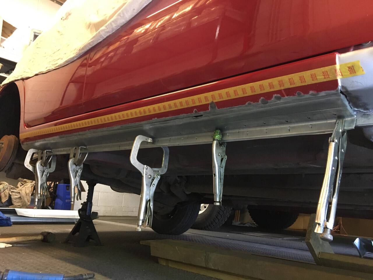

Ian_Fearn Posted July 4, 2021 Author Share Posted July 4, 2021 Super impressed with the tyres. The PO clearly liked to make his tyres go the distance. I lost patience and ordered some sills from the firm in Poland that @St.Jude is getting his RAV4 panels from. Easyparts online they go by. Panda sills have little arrows pressed into them for the jacking point locations and I noticed that the Polish sills have these so that made my mind up. £86 for the pair with postage and UK VAT paid so will see if I get a nasty bill from customs and excise. Burnside, Shite Ron and St.Jude 3 Link to comment Share on other sites More sharing options...
St.Jude Posted July 4, 2021 Share Posted July 4, 2021 1 hour ago, Ian_Fearn said: Super impressed with the tyres. The PO clearly liked to make his tyres go the distance. I lost patience and ordered some sills from the firm in Poland that @St.Jude is getting his RAV4 panels from. Easyparts online they go by. Panda sills have little arrows pressed into them for the jacking point locations and I noticed that the Polish sills have these so that made my mind up. £86 for the pair with postage and UK VAT paid so will see if I get a nasty bill from customs and excise. Slick racing tyres yo. Hope the panels live up to expectations, no pressure on me 😂😂 Link to comment Share on other sites More sharing options...

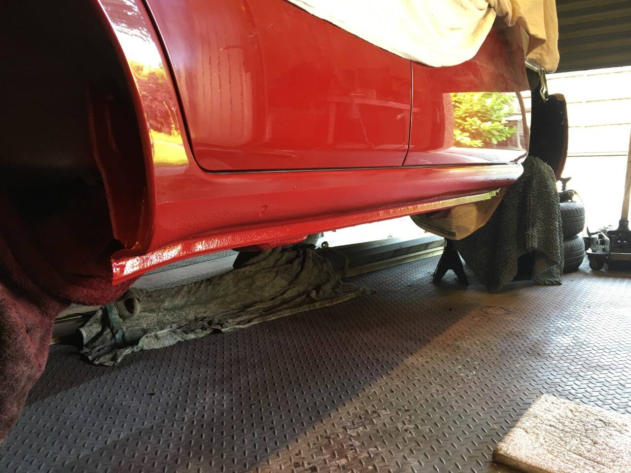

Ian_Fearn Posted July 22, 2021 Author Share Posted July 22, 2021 The sills from Poland did arrive after a couple of week and seem to fit really well. I’ve finished the drivers side now and it’s painted using colour coded Raptor. I’ve had to raise the stone chip line but I think it worked out better than trying to blend normal paint into the rest of the sill. MJK 24, St.Jude, Dan302 and 14 others 16 1 Link to comment Share on other sites More sharing options...

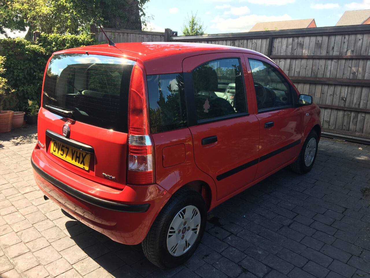

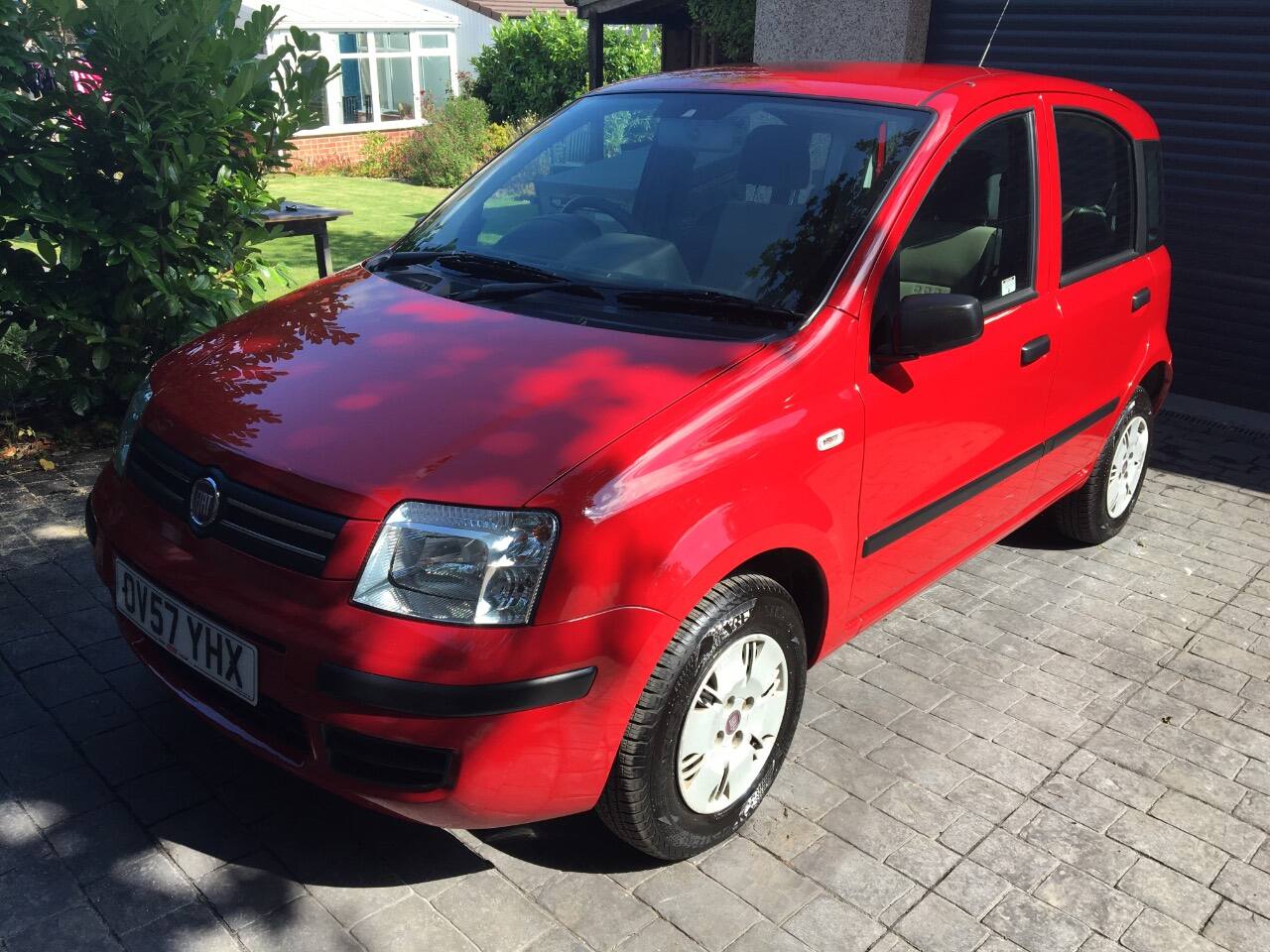

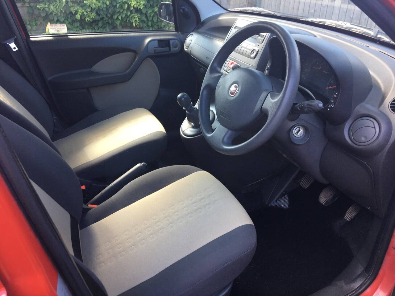

Ian_Fearn Posted August 22, 2021 Author Share Posted August 22, 2021 I’ve nearly finished this now. It really is looking great. The repairs aren’t all ‘factory’ but I think it’s all very satisfactory without bodgery and will make somebody a great car. Anybody want it? All the seat and interior plastics came out for a thorough clean and a ‘cost effective’ repair on the drivers seat with some black webbing fabric. It’s really nice inside now. I sourced and fitted some OE plastic side trims from the scrap yard. I think the Pandas really suit these. I then gave it an oil and filter, fuel and air filter change with genuine Fiat parts. Basic servicing is really easy on these things. Also stripped and rebuilt the brakes. Nothing new needed there. I investigated the rear axle next. It looked a real mess but actually after a load of work it really wasn’t too bad. For a bit of added security I welded some gussets on where they normally break, doused it in Bilhamber Deox, Bilthamber Hydrate 80 and then splashed some Dinitrol over it. I think it’ll realistically outlast the car now. Finally, new tyres going on tomorrow. As on my other Panda, Vredestein Quatrac 5 all seasons. IMO these are the best tyres money can buy in this size. Shirley Knott, BertiePuntoCabrio, neil1971 and 11 others 14 Link to comment Share on other sites More sharing options...

Ian_Fearn Posted August 23, 2021 Author Share Posted August 23, 2021 Apart from a set of glow plugs later in the week, this is finished and driving great! Any interest in a roffle? Justwatching, louiepj, UltraWomble and 11 others 14 Link to comment Share on other sites More sharing options...
