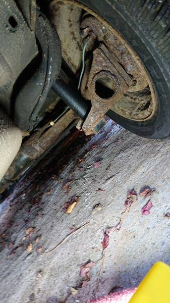

Re the gearbox oil smell: check the gearbox breather. On the 1.3s there's a nylon style breater that has a tendency to get stuck (it looks a bit like a white bung) and block up. This causes gearbox oil to be drawn up the speedo cable and drip down the back of the clocks and onto the carpet/your shoes! (Ask me how I know...)
Don't know if the 1.6 shares this trait, but its worth a look for nothing! Good buy btw, these are bloody decent little cars.

3 hours ago, bunglebus said:
Hubs/suspension look a bit crusty, is it near the sea?
Time to learn to MiG, get those arches done
Is it near the sea haha you could look over the garage and 100m down the road all you see is the sea.

Sorry for the lack of updates. Just been busy with personal life. A super big thanks goes out to DodgyBastard for letting me have a look at the car on the ramp the other week.
This gearbox breather thing is being a pain, it was stuck when I had a look at it today and I've put some WD40 on it and managed to lift it up and down slightly.. but i can't seem to get it out. also there's a crack on it which is putting me off pulling it out or using any force in case I end up breaking the thing off so I just cleaned it up a bit from what I could and left it stuck open as the pictures show.
finally found a use for my bike pump 😂
crack down the middle.. hmm.
cleaned up a bit. not really a great success overall. but i'll see if that does anything..
