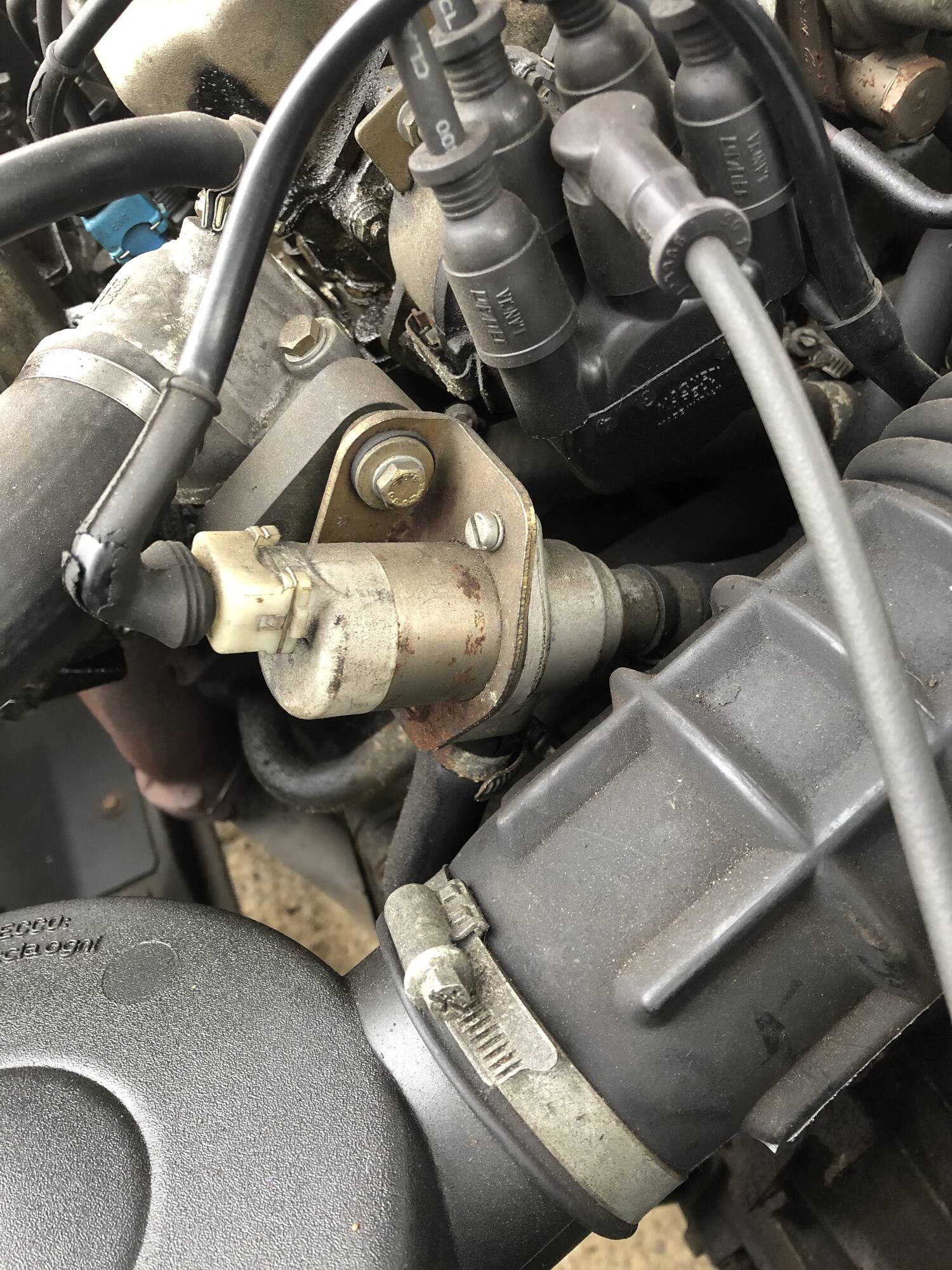

jmsguzzi Posted January 2, 2020 Author Share Posted January 2, 2020 34 minutes ago, lanciamatt said: On turbo it's bolted near throttle body Am I right in thinking that this is it? Link to comment Share on other sites More sharing options...
lanciamatt Posted January 2, 2020 Share Posted January 2, 2020 Yes that's it, take it off and put ign on then look in it while plugging it in and you should see it move, and feel it too. Link to comment Share on other sites More sharing options...
jmsguzzi Posted January 2, 2020 Author Share Posted January 2, 2020 29 minutes ago, lanciamatt said: Yes that's it, take it off and put ign on then look in it while plugging it in and you should see it move, and feel it too. Arghh didn’t think to do that! I’ve had it off and cleaned it out with WD40 the best I could, didn’t try and take it apart though. Just been on a run for an hour or so and it’s still lumpy and cutting out on idle occasionally so it might be knackered. I’ll have it back off tomorrow and do what you suggested! Link to comment Share on other sites More sharing options...
lanciamatt Posted January 2, 2020 Share Posted January 2, 2020 It could also be the Co that needs adjusting. It might be running a bit lean. I've got a Co machine, but it's a bit far for you to come to Barnsley, but you can if you want to. Link to comment Share on other sites More sharing options...
lanciamatt Posted January 2, 2020 Share Posted January 2, 2020 What rpm does it idle at? . Should be about 800rpm, adjuster is on top of throttle body, it's a brass lock nut and flat blade screw driver adjuster. You set it with idle control valve disconnected and engine warm. Link to comment Share on other sites More sharing options...
Noel Tidybeard Posted January 2, 2020 Share Posted January 2, 2020 6 hours ago, jmsguzzi said: Arghh didn’t think to do that! I’ve had it off and cleaned it out with WD40 the best I could, didn’t try and take it apart though. Just been on a run for an hour or so and it’s still lumpy and cutting out on idle occasionally so it might be knackered. I’ll have it back off tomorrow and do what you suggested! you'll prolly be better using icv cleaner or carb cleaner the wd40 jmsguzzi 1 Link to comment Share on other sites More sharing options...

Bstardchild Posted January 4, 2020 Share Posted January 4, 2020 On 1/2/2020 at 10:40 PM, Noel Tidybeard said: you'll prolly be better using icv cleaner or carb cleaner the wd40 Definately ^ WD40 is rubbish for idle control valves that are sticky If you don't have an ultrasonic bath and some solvent - manual method is normally quite effective Remove it - 50% fill with carb cleaner Fingers over holes - agitate for a few mins Drain - note colour of liquid removed Repeat until carb cleaner coming out after agitation is nearly same colour as new stuff going in Jim Bell, jmsguzzi and Kringle 2 1 Link to comment Share on other sites More sharing options...
