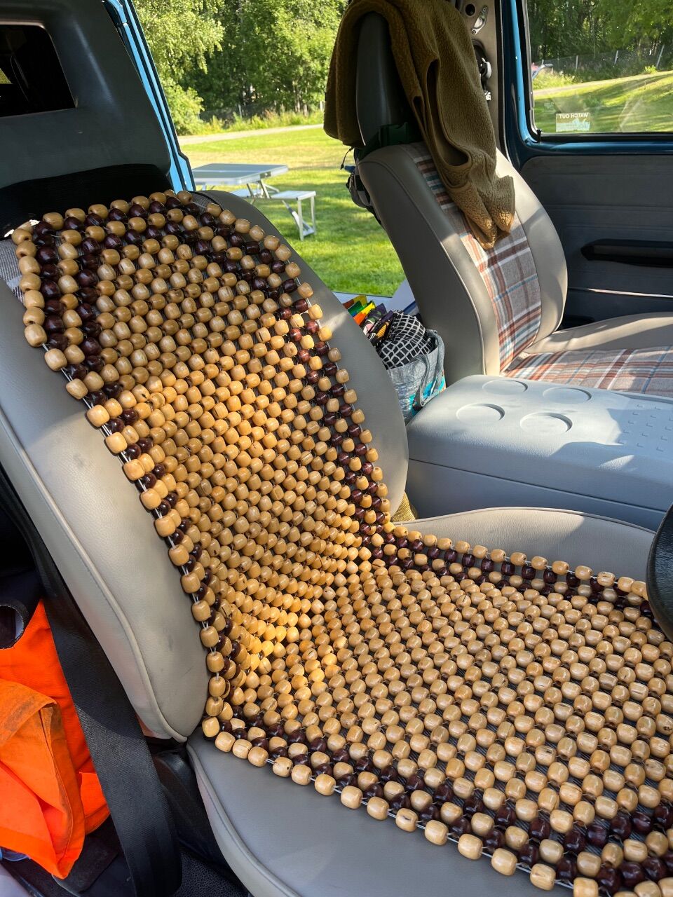

In other news the reupholstered seats for the T25 were shite, the foams weren’t replaced (as per contract) instead they’d just lobbed in a load of cotton wadding that slowly moved around and formed a ridge right where a man doesn’t need a ridge to be. Awful. This improved it slightly:
but after a full and frank discussion we have been refunded. Just weighing up if it’s best to get someone else to have a go, or just bite the bulllet and get the ready made covers and fit them myself. I chickened out last time but having seen what an expert does (for a grand!) I’m confident I can do at least as well! The ‘repaired’ bolster on the drivers side is worse than it was when it went in looking at the photos side by side. Why is it so hard to get stuff done properly?!
Nice to see someone properly using their T25! 22 Mpg makes me feel better about the 20 Mpg I get out of my air cooled auto.
Have you put sound proofing in yours? The most tiring aspect of long trips in mine is the road noise- I need to dynamat the cab and under the seats methinks

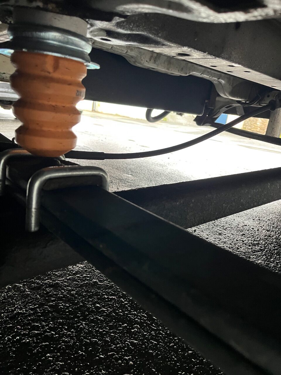

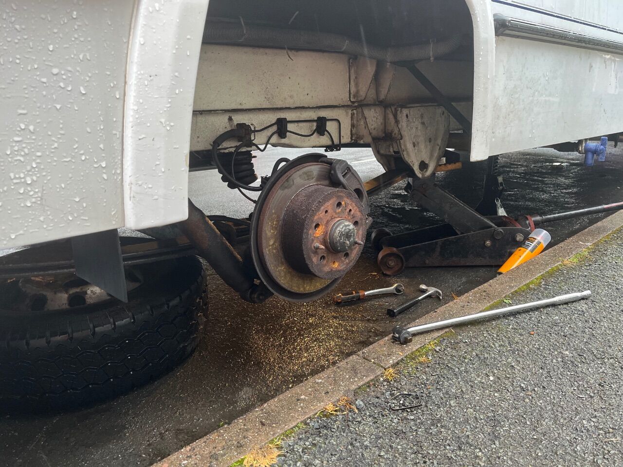

Ordered leaf springs, new 'rear suspension rebound blocks' (or bump stops?!), new rubber mounts and new shocks. New heavier duty axle stands await at Halfords.
All parts on 24 hour dispatch. Most have arrived apart from shocks, as apparently they have to check compatibility before shipping and their system was down. Did suggest that maybe if they offer parts specificlaly for an '07 boxer then if I have an 07 boxer and order these parts the hard work should already have been done surely. Now arriving Monday which is 5 day shipping not 24 hours. Never mind, they can be done later, but why does it always seem to be so hard to actually buy stuff now.

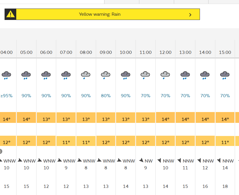

So mostly set, and the weather is looking spot on for groveling around in the gutter:
I can almost feel the water entering my trouser legs and running back out through my collar now..... Got to love street mechanics as a hobby....
I fear after today I may have become amphibious - even in waterproofs I have been able to wring out my under crackers form the rain that’s come in.
How it started - wheel off and jacked up, with a little stream running down the kerb:
old things - life expired bump stop/spring assister thing, shock without a dust cover (and it’s got a small kink in the rod which ain’t ideal) and is leaking oil, although it is till surprisingly tough to operate
So was it bust, I reckon yes, seller agreed discount but said he thought it was supposed to be like that -
nice to be right. It’s actually fractured where the part number was stamped on it, so well done fiat for creating a stress fracture propagation  point during manufacture. Been like it for some time as both faces are well corroded. Been through a recent MOT as well.
New spring and assistor thing, shocks still in the post but have cracked off both bolts so it’s an easy job when they arrive
Back on it’s wheels,
The old springs had the much shorter assistors resting on them, have gained almost 2 inches in height.
Finishes the broken side at about 15:30, not time to do the other side before we were due out for dinner, so that awaits tomorrow….. yay.
Also found there is a hole in the back box which I missed during inspection so need to have a better look and see if it’s omg replace now or it’s actually a bit of paste and give a while!

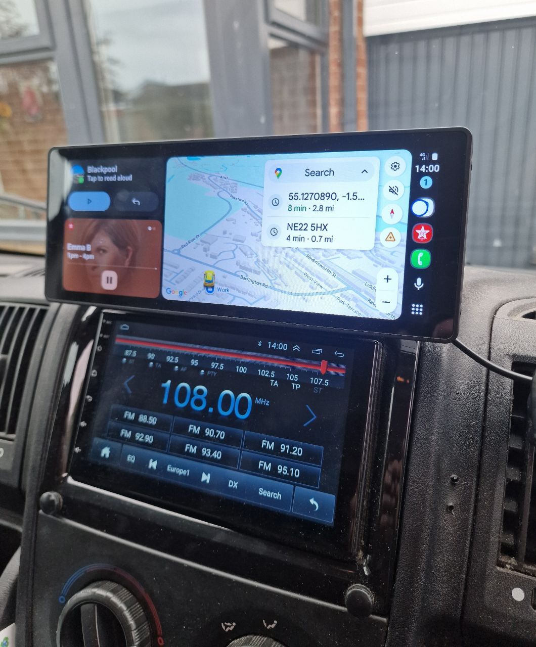

I have a 2016 Relay and I changed my head unit for a generic 7" android unit about four years ago. It has a reverse camera too which stops me reversing into skips again. I bought an extra cable so I could still use the steering wheel controls.
It doesn't have android auto so I added a 10" extra screen yesterday recommended by L1 and GM as the sat nav on the 7" was shite and too small.20251016_140002.jpg.186f5c6e8b43e60497e63e340a6f61bc.jpg
The photo doesn't show it at a good angle but it doesn't get in my view at all.

That’s cool - l like the size of the screen, I use my phone at the moment but it’s a bit small! Had a hire transit with car play and it was great.
I need a magic wire to change mine apparently, something to do with the way it integrates with the van - certainly if you take it out the dash gets grumpy.  Cheapest version of wire is £60. It will get done, just lower down the list of priorities. At least I have Bluetooth now, not sure I was up for a return of the giant wallet of CDs (ah the forgotten skills the Youth will never know!!)

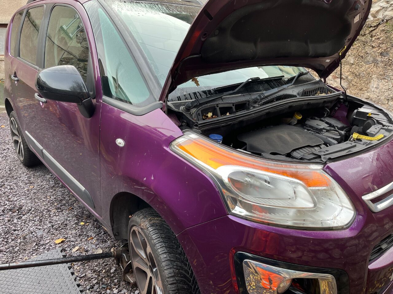

as per thread in ask a shiter I have had no success in getting anyone to do my wet belt on a puretech engine so I have watched a YouTube video and decided it can’t be that hard….. expensive belt kit, cheap locking kit, which feels like the right way round!
  • rusty_vw_man changed the title to Rusty VW bothering …. ‘Modern’ cam belt, slippery when wet

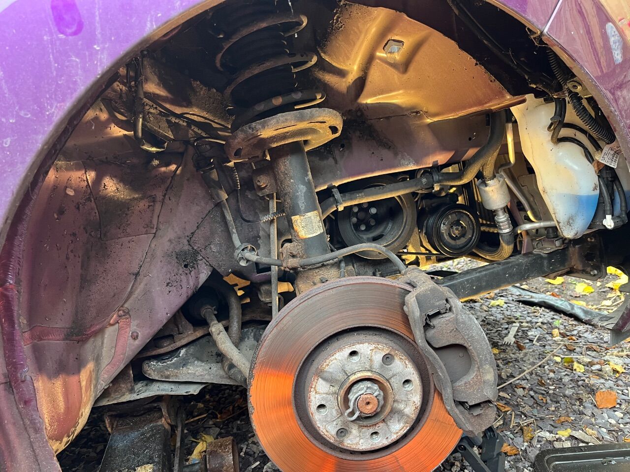

So, no local takers for doing my wet belt change on the ‘modern’ - it’s at 60k and 8 years old, so well under the original service interval, but 2 years overdue in the revised schedule due to the premature failures they see.
Much is made of how hard they are, so I was feeling confident* and relaxed*
step 1, purchase The Big Purple One from a box of quality street. Ensure it has the 1.2 puretech engine.
step 2
remove wheel and arch liner, including those push in plastic rivet things, torx screws and a couple of 10mm bolts for luck
Step 3
assemble tools. Consider if a ramp or a gravel driveway is best. I chose gravel driveway for the win.
step 4
Strip all the bits out the way, and remove 16 8mm bolts to expose cams:
Step 5
realise you have a super late model engine, which has a different cam cover arrangement than the online checker thinks, so the cam locking set doesn’t work. Drive to Bangor (or other ECP of your choice) and drop £140 on a second set of c locking tools.
step 6
Fit crank lock (little peg in the gearbox that locks the flywheel) then inlet cam lock
Mmmmm anodised aluminium tool.
Step 7
Remove exhaust cam driven vacuum pump, and insert exhaust cam locking tool
as a short side quest, admire the condition of the belt
has all the smooth elasticity of Keith Richards.
Step 8
Remove aux belt, pulley and crank bolt. Crank bolt is quite* tight. Option here to feel the muscle in your shoulder tear just a little, due to too much force in a very poor position. Still happy with my gravel driveway choice  though, who needs a ramp.
Step 9

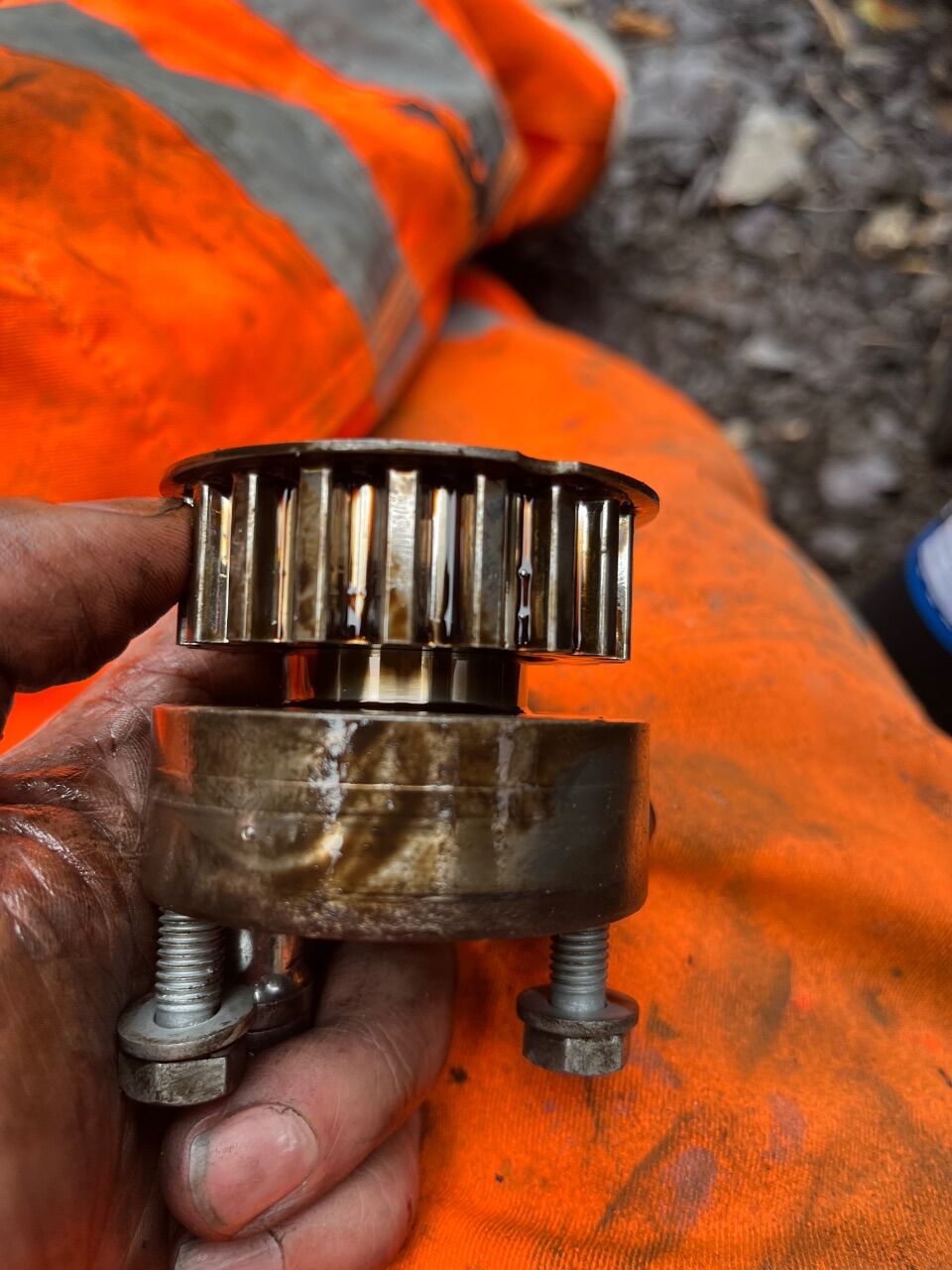

Remove inspection hatch, idler and tensioner that are underneath and lower pulley
Step 10
Admire this bit of engineering - the bottom pulley when not under full torque of bolt is free to spin. No woodruff key, no machines keyway, just lots of clamping force.
Step 11
Fiddle belt out the top, it does just squeeze round the cams, so no need to remove like the belt kit suggests. Outside is quite cracked
inside is breaking down, the left bit that’s shiny is the original hard rubber, the bit on the right is where bits have fallen off, between each tooth is the same. These are the bits that can block the oil pickup, solenoid valves and brake booster pump. Take a minute to appreciate that despite ordering more gloves, they haven’t turned up, despite everything else from the order arriving.
Step 12
Thread new belt back though, fit idler, tensioner and bottom pulley, but only loosely. As you tension the belt the bottom pulley moves on the crank(which is locked in timing position). Then do up the bottom pulley bolt 50Nm and 180 degrees. The first 90 degrees are fine, the second quite hard going. Fit poxy stretch belt thing over water pump.
Step 13
Give it all a spin (I removed plugs for ease) a few times. Pop timing tools back in loosely, still fits, nothing clashes so going to call that timed
Step 14
Get heavier rain. The drizzle was not enough. Still don’t need a ramp, or a roof.
The photos stop here as it really did come belting down, and with an umbrella in one hand and tools in the other I ran out of hands for the camera, but basically fit new gaskets, reassemble.
You should remove the sump to check for blockage of the oil pump pick up from those bits of rubber, but a sneaky endoscope was used instead as the sump is siliconed on (from the factory) and removal is an arse.
All bits refitted. Twisted the key and it runs, no errors (other than it needs a bit more oil) and drives.
Total cost came in at £360 for the belts, lock kits plus more for the service items like oil and filter.
It’s done though, and the new belt has 120,000 mile service interval, so it will see the car out I reckon.
It is not the worst cam belt I have done by any stretch, would do another one without worrying about it, so if you are handy I don’t think the Puretech wet belt is nearly as bad a job as people suggest - just remember to use a gravel drive in heavy rain, makes it all so much nicer and easier……

Also need to do the bottom ball joints as they haven’t magically fixed themselves since the last mot and will be a failure as the boots look like a couple of bits of elastic bands.
Checks weather:
Excellent, my favourite kind of car fixing weather! At least this is all just bits of metal and I shouldn’t mange to soak anything electrical!!
In happier news the T25 is holding all its fluids at the moment and the new thermostat is working well. Also fixed the awful cold running, turns out the auto choke bimetallic spring had come unhooked (possibly my error from the last lot of fiddling) so the choke was very much doing whatever it liked.
