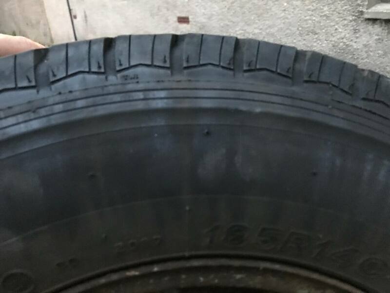

I was aware that the MOT man wasn’t overjoyed by the age of my tyres, so after a bit of good luck I scored a 10 mile set of tyres on decent wheels for less than a set of tyres would have cost. Result.
Having inspected the old ones closer I had two firestones, a continental and a Yokohama, with between 4 and 8 ply construction and varying amounts of tread.
The firestones look surprisingly good:
tread - 6mm, uniform wear
side walls not particularly perished:
but the date code is a shocker:
they are a week off being 25 years old. Think me and the last two owners got good value out of these!
The other two were virtually new in comparison, being only 18 and 20 years old .

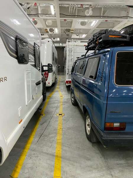

Did 6 ferries - most had a cut off height of 2.4m for cheaper tickets. I measured the van with top box at 2.4m ish so took a punt - it was quite tight, especially as the car deck flexed as you drove on it…5F12012B-DD32-4060-B774-665A347DE2C7.thumb.jpeg.b299964a9b3bc5703c2136db99fbeef2.jpeg

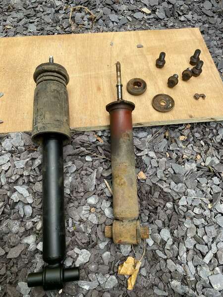

First up is shocks all round. The ride is a bit choppy, so we’ll start with the way bits and see if that improves things. Rears simple - bolt top and bottom and they’re off, had value out of these:
fronts are an arse in as much as they have the typical 6mm flats to hold the piston, which had  rusted to a general blob:
a quick blast with a nut splitter and it saw sense. 3F32DD76-C72A-4940-B92B-CBB5D4F729CC.thumb.jpeg.95dace91138581592bf90ab8f1635d6a.jpeg

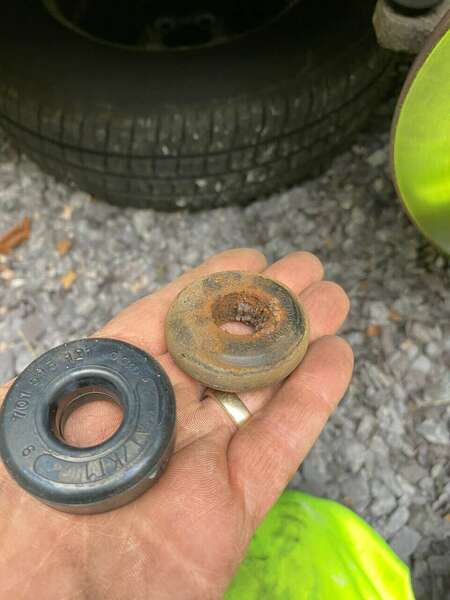

plastic sleeve is also the bump stop and no longer available, so gets swapped to the new shock. New shock is much smaller diameter, so we’ll see how well it performs. Trusted supplier says they are fine, so expect they will be.
top mount was proper shagged, about half the thickness of the new ones, and hard as rock. All the rubber bushings in the shock bolts were equally hard and cracked.

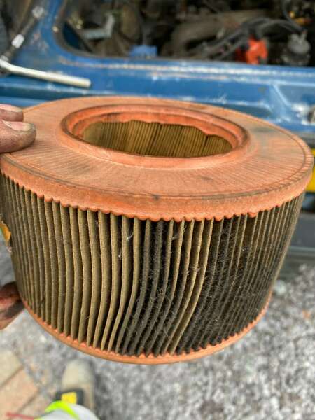

This done I did a fuel, oil and air filter change. Air filter looked  minging, but it’s mostly just oil that gets fed in by the breather. New one is a fetching pink colour.

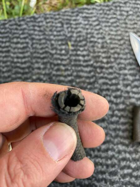

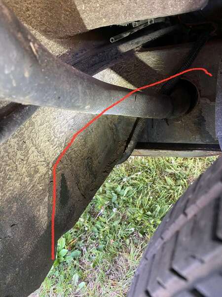

Now all this driving meant lots of fuel required , which let to the next issue. 60 litre tank, but it’s kind of in two halves, so has a funky balance/breather arrangement.
With more than 30 litres in I get wet feet and a sinking feeling in my wallet. Some investigation showed that this 12 month old hose looked like this:
It wasn’t just the end either, it had split comprehensively. E10 proof my arse.
only slightly tricky issue was access - in here, between the base of the seat box and the chassis rail:
with these two hoses to replace:
work area was quite pleasant though, as I dragged it dripping back to a campsite. The fire risk seemed low*
here shows the staining of quite how much fuel was slopping everywhere, there was a tide line

In preparation for mega 4000 mile road trip I have done the boring bits (oil change etc). Having read a horror story on here of a leaky gearbox that shat itself after running dry I thought I probably best check mine
not so clear upside down, but it’s rather leaky, simple fix but needs drive shafts removing, so one for after holiday.
first, level van:
then simply top up until it dribbles out the hole. Only issue is that it’s clearly not designed as a service item, as the filler is tucked behind the selector rod, and access is an arse - you can just make out the silver hole in this shot behind the bellows
oil can then be added drip at a time from a little bottle. Almost 700ml went in, which is something like a quarter of the box capacity. What an absolute arse of a job.
