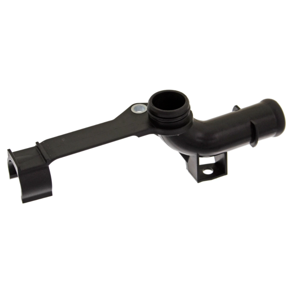

Rusty Pelican Posted March 14, 2021 Author Share Posted March 14, 2021 Well its still alive , failed MOT on CO which turned out to be the back box falling off , Merc wanted two kidneys and a lung but got a pattern part for £150 . Then we had a coolant leak which took forever to trace to a crappy plastic pipe on the back of the head , its one bolt , one clip , one hose and an O ring fit , with access its a 10 minute job - took me three feekin hours and a very scratched hand come the finish . Still it seems to be leak free at long last Next !!!!!!!!!! Suppose to look like this Mine was a tad knackered , and what is it with these spring hose clips - bloody nightmare 🙄 theshadow, Jim Bell, Low Horatio gearbox and 1 other 4 Link to comment Share on other sites More sharing options...

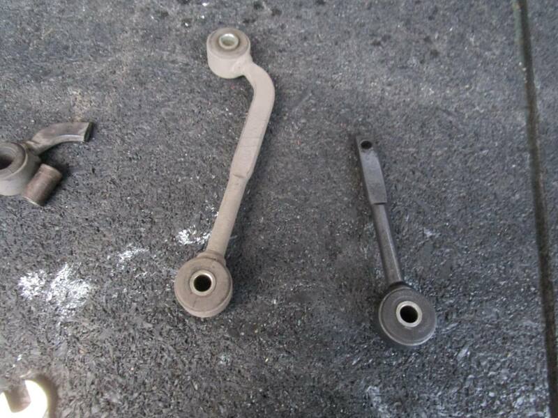

Rusty Pelican Posted April 8, 2021 Author Share Posted April 8, 2021 Ive had an annoying clunk clunk from the NSR for about a year and today i found it , drop link is toast . Weird how it passed two MOTs like it Link to comment Share on other sites More sharing options...

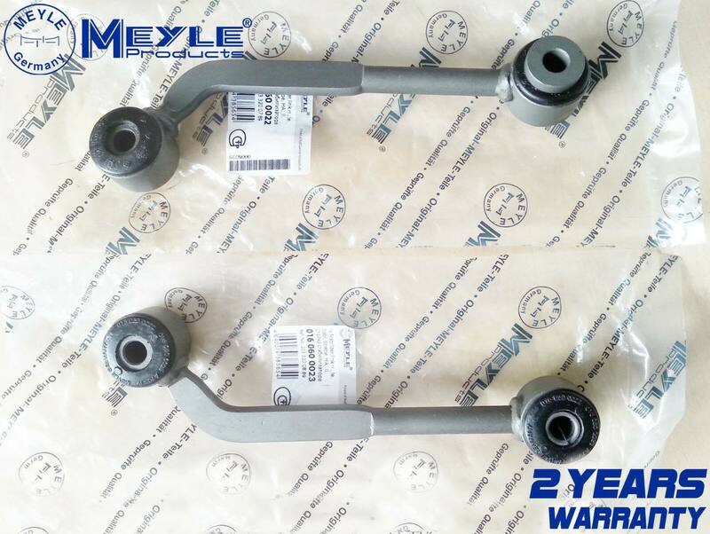

Rusty Pelican Posted April 9, 2021 Author Share Posted April 9, 2021 Ive spend 3000 pennies on a pair of these - bet the old ones put up a fight though Jim Bell 1 Link to comment Share on other sites More sharing options...
Rusty Pelican Posted April 15, 2021 Author Share Posted April 15, 2021 Fitted , dead easy and took 35 minutes to do both , in typical Autoshite fashion i used the top parts of the old ones with still decent bushes as exhaust pipe hangers for my Imps > PS coolant leak is no more 😃 stripped fred, Jim Bell, Tickman and 8 others 11 Link to comment Share on other sites More sharing options...

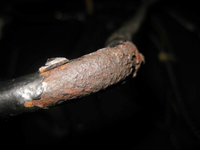

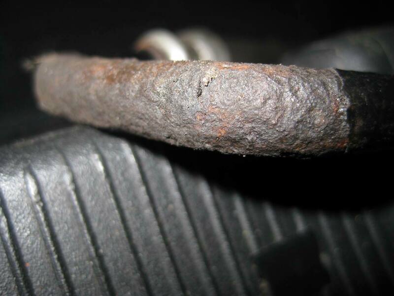

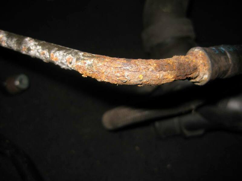

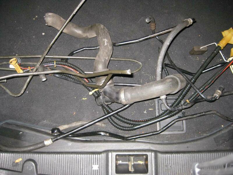

Rusty Pelican Posted October 15, 2021 Author Share Posted October 15, 2021 Well heres a story of how things can escalate on these things . Due to various reasons I was unable to do this myself so bunged it in my local garage . I get a phone call a while later - Transmission oil cooler pipes rotted through and is leaking , Its all over the under trey , we advise you not to drive it , also the front to back fuel pipes badly corroded , they gave me a price and i said go ahead . Today i get another phone call . One oil cooler pipe refuses to come out the rad so its new rad time . Tank had to come out for the front to rear pipe whereby the plastic bit on the sender disintigrated so needs one of these , apparently theyve got two fuel pumps , one in the tank and one outside , not sure if they doing the in tank one but the external one sheared its outlet just like the sender . Bill has gone way beyond what its worth although theres no labour charge fitted the bits that broke as " its not your fault " Ive been up and had a good look and everything they have said is true - i trust this garage What a wanky bit of kit these cars are , all plastic and junk Its an 06 C180K Rant over dome, Jim Bell, BorniteIdentity and 1 other 3 1 Link to comment Share on other sites More sharing options...
Rusty Pelican Posted October 22, 2021 Author Share Posted October 22, 2021 IT LIVES Sadly my wallets not so lucky Saga is as follows . Book it into my friendly garage for a service B - or was it A - Feck knows but it sprang up on the dash demanding attention within 28 days . No time myself and this garage is great , been using them for decades . Get a phone call a few hours late - Huston - weve hit a problem !!! We took the undertray off and its full of ATF - Must of looked like a murder scene with all that red everywhere 😗 . Weve tracked the leak to an oil cooler pipe that rotted through , Merc only part and BTW tother pipes none too happy , means a rad out job so wont be cheap . Figured it daft to scrap a car just because of two rusty pipes so i gave em the go ahead . Then it got a bit iffy . Front to back fuel pipes hanging on by a thread and wont pass the next MOT - Merc only again only its gotta come from Germany , will be 10 days . Ah WTF just do it I said , il leave it there seeing as its bleeding to death - I mean just how bad can it get - a fuck loads as it turned out . So they had to drop the tank to fit the fuel pipe , cue the sender outlet snapping off , Oil cooler for the box is in the rad - and guess what - its refused to come out along with the bottom hose which also grenaded itself - this meant new rad / cooler . So what started as 3 rusty pipes turned into the biggest bill ive ever had the misery to pay . Still WTF , its only money 🙄 Fuel pipe , by the tank , goes into a filter apparently F The oil cooler pipe that wasnt leaking The one that was Sender unit shit itself A collection of dead bits , i didnt collect the rad , didnt see the point theshadow, richardmorris, BorniteIdentity and 3 others 1 2 3 Link to comment Share on other sites More sharing options...
