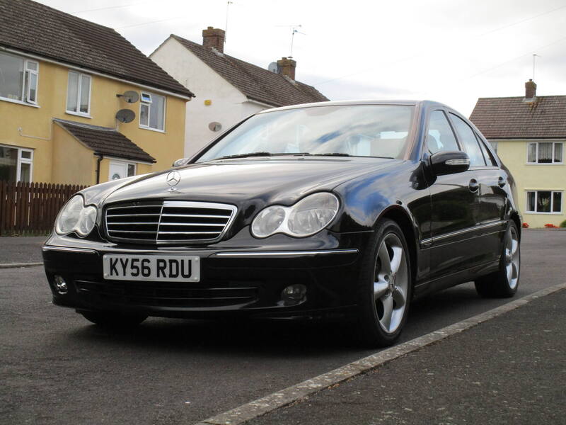

Rusty Pelican Posted November 27, 2019 Share Posted November 27, 2019 Back after a lengthy break Well the E30 finally got eaten alive with tin worm but it did go to a loving home who is going to do a LOT of welding on her and sort it out . So a new daily was required , had to have 4 doors this time to assist with carting my aged parents about if required . So i spotted an 06 Merc in nice " cant ever keep clean " black , Its a W203 C180K with 127,000 miles on the clock , apparently only available with very fragile timing chains , bucket loads of computer and SAM electricery issues and a thirst for fuel , road tax , tyres and every suspension bush fitted . Being an 06 its galvanised so theres no rot at all. So are ive fixed the busted fog lamp , the busted centre heater vent , the leaky boot , the borked wipers , changed both cam magnets , fixed the alarm ( didnt even know it had one until the Star test picked it up ) , Star test also picked up the Crank sensor " out of range " , that did at least sort out it perplexity to suddenly splutter and flash every dash light at me in blind panic . Basically ive swapped a very rusty but reliable motor for a very unrusty but temperamental gremlin ridden nightmare . WCPGW taxi paul, Scruffy Bodger, djim and 30 others 27 6 Link to comment Share on other sites More sharing options...

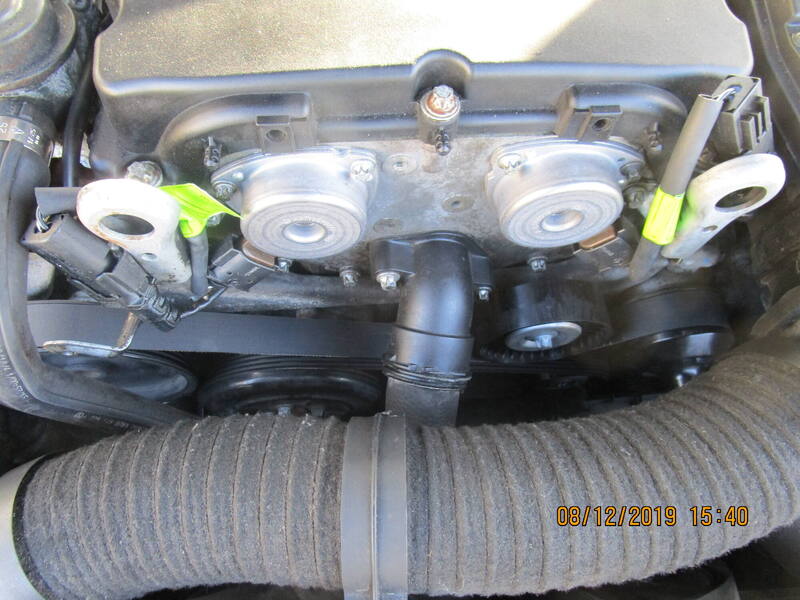

Rusty Pelican Posted December 6, 2019 Author Share Posted December 6, 2019 Well the joy was short lived , after only 4 months it decided to shit the belt tensioner pulley in a mighty grand way , bearing seized and the plastic pulley span on it until it melted , flew off and buried itself into the supercharger inlet , belts royally fucked as well , now abandoned at work until i can sort the mess out BorniteIdentity, HillmanImp, Spurious and 1 other 4 Link to comment Share on other sites More sharing options...

Rusty Pelican Posted December 8, 2019 Author Share Posted December 8, 2019 £115 and 1 1/2 hours of cussing later its alive again stonedagain, The Moog, Shep Shepherd and 5 others 8 Link to comment Share on other sites More sharing options...

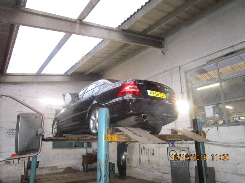

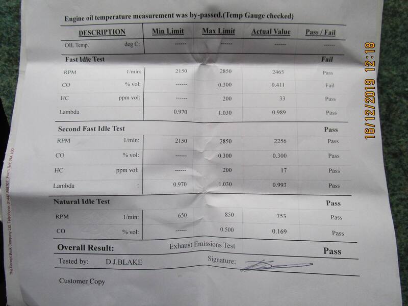

Rusty Pelican Posted December 16, 2019 Author Share Posted December 16, 2019 Well Ingrid failed the MOT on a squiffy O/S headlight bulb ( working but fitted wrong and not by me ) Then passed the MOT after said bulb was fitted correctly.However it was a bit tight on the emissions to say the least. As Basil Faulty said in Flowery twats i think it needs a right good thrashing ? Braddon81, doug, 320touring and 1 other 4 Link to comment Share on other sites More sharing options...
