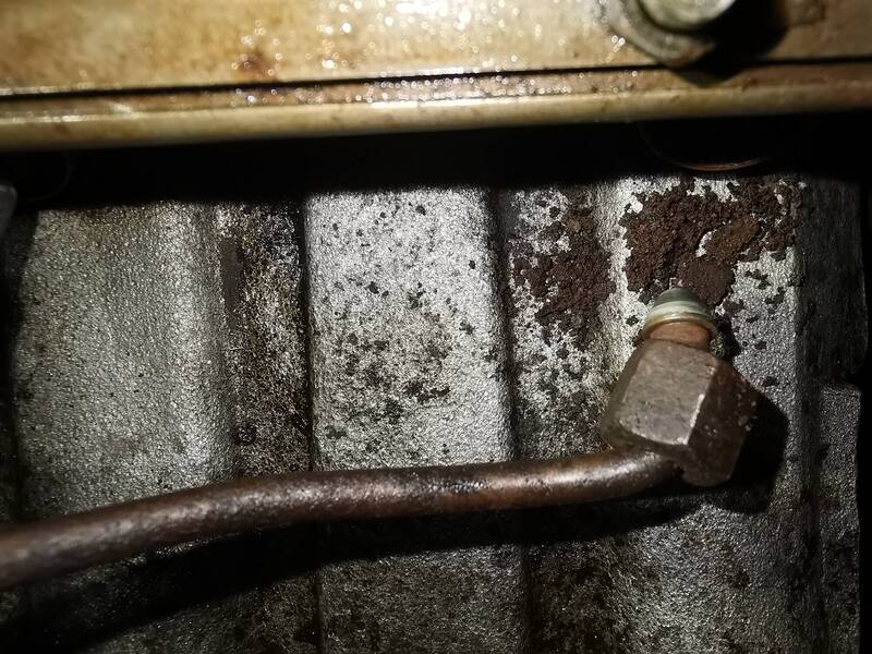

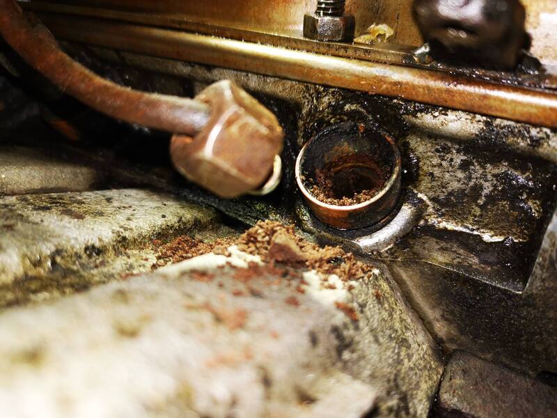

Spurious Posted December 9, 2019 Author Share Posted December 9, 2019 It started running really rough this afternoon. Hot and cold on both idle and overrun. It was kangaroo-ing off throttle a good bit. I was thinking there has to be an air leak somewhere and sure enough. I'm pretty sure the injectors are the source. There's a little o ring on both the bottom and the top of the Jetronic injectors and I was thinking they'd failed and drawing air. Pulled out injector one and I was greeted with a rusty mess full of schmoo and dirt. Injector 2 was a similar mess. Not touched the other 3. I'm going to go out on a limb and say the top seals are fucked on this, beneath the o ring the surface is pitted and flaking. No way are they air tight. New injectors all round. And the little seal cups things too.  Link to comment Share on other sites More sharing options...
Spurious Posted December 9, 2019 Author Share Posted December 9, 2019 Gunk, dirt and schmoo. I hope this hasn't fallen into the intake manifold.   Link to comment Share on other sites More sharing options...
Spurious Posted December 9, 2019 Author Share Posted December 9, 2019 Just now, Spurious said: Gunk, dirt and schmoo. I hope this hasn't fallen into the intake manifold.    Asimo 1 Link to comment Share on other sites More sharing options...
Spurious Posted December 9, 2019 Author Share Posted December 9, 2019 This is what it should look like ? Link to comment Share on other sites More sharing options...
somewhatfoolish Posted December 9, 2019 Share Posted December 9, 2019 What holds them in? Link to comment Share on other sites More sharing options...
Spurious Posted December 9, 2019 Author Share Posted December 9, 2019 Just now, somewhatfoolish said: What holds them in? The injectors are a friction fit with the top o-ring. The cups, I'm not sure. They didn't want to pull out for me too easy. I think they're a friction fit too.. Link to comment Share on other sites More sharing options...

Spurious Posted December 13, 2019 Author Share Posted December 13, 2019 I think these injectors seats need to come out for a clean too. I dunno how these got so bad. I'm afraid to clean them in situ, I'll just push a load of crap down into the cylinder head which is no craic.   Need a 13mm hex to get these out. Has anyone removed these before? Haynes is no help here and I don't want to drop something into the cylinder head.   Link to comment Share on other sites More sharing options...
garbaldy Posted December 13, 2019 Share Posted December 13, 2019 On 12/9/2019 at 7:45 PM, Spurious said: The injectors are a friction fit with the top o-ring. The cups, I'm not sure. They didn't want to pull out for me too easy. I think they're a friction fit too.. Mine has a metal bar bolted down that slips over injectors to hold them.  Link to comment Share on other sites More sharing options...
Spurious Posted December 13, 2019 Author Share Posted December 13, 2019 Mine has a metal bar bolted down that slips over injectors to hold them. Â Mine has that too, forgot to mention. I don't think it does a great deal however, most of the friction seems to come from the fat o-ring Link to comment Share on other sites More sharing options...
garbaldy Posted December 13, 2019 Share Posted December 13, 2019 5 minutes ago, Spurious said: 7 minutes ago, garbaldy said: Mine has a metal bar bolted down that slips over injectors to hold them.  Mine has that too, forgot to mention. I don't think it does a great deal however, most of the friction seems to come from the fat o-ring Trying to get mine out was a right mare as they're well stuck. I only got number1 the easy one out. Link to comment Share on other sites More sharing options...
Spurious Posted December 13, 2019 Author Share Posted December 13, 2019 Trying to get mine out was a right mare as they're well stuck. I only got number1 the easy one out.Trouble is getting leverage behind them to get them to shift. Once you can do that, they seem to come free. Link to comment Share on other sites More sharing options...
garbaldy Posted December 13, 2019 Share Posted December 13, 2019 4 minutes ago, Spurious said: Trouble is getting leverage behind them to get them to shift. Once you can do that, they seem to come free. I've given up with mine again as it's been off the road since 98Â think so I'm sure another year or two won't matter. Link to comment Share on other sites More sharing options...
