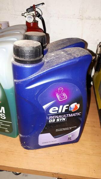

catsinthewelder Posted October 20, 2020 Author Share Posted October 20, 2020 34 minutes ago, RobT said: This any good to you? Not sure if D3 is for later Renner 'boxes, but got two litres FOC if you want it Rich. That's very kind of you Rob but apparently I need D2. Lucky that you reminded me to check though as I'd probably have just filled it with ATF. I'm up on Clee Hill, Link to comment Share on other sites More sharing options...
RobT Posted October 20, 2020 Share Posted October 20, 2020 No probs. I'll keep it for the day I finally lose my mind and buy a Laguna II. catsinthewelder, Angrydicky and DSdriver 1 2 Link to comment Share on other sites More sharing options...

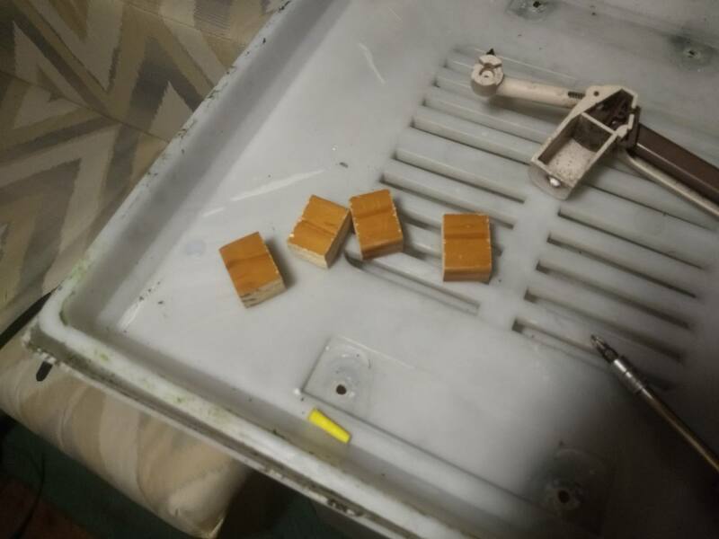

catsinthewelder Posted November 2, 2020 Author Share Posted November 2, 2020 Aye, the Discovery is getting quite ripe. Today the V5 turned up for the Sherpa so I went out and made an effort to get her started. As it's not going anywhere near the road soon I just used Kerosene. Once she'd fired up I wandered into the back to check on the leaking roof and found that the plastic skylight had vanished in today's strong winds. Fortunately I found it behind the van and it's just the plastic bolts that have snapped. I'm hoping that numberplate bolts are the same size but might have to do it with steel bolts for the time being if they don't. Lacquer Peel, Mrs6C, beko1987 and 4 others 7 Link to comment Share on other sites More sharing options...
catsinthewelder Posted November 2, 2020 Author Share Posted November 2, 2020 So this is the sight that greeted me, not ideal for keeping the rain out. Fortunately the lid would fit through on an angle so a plan was formed. With the opening catches or whatever you call them removed I thought I could unscrew the bolts with pliers and replace them but it turned out that they weren't bolts. Drill a hole and use a screw then except there wasn't much for the screw to go into. Why didn't I do this earlier when I could use power tools? Hang on there a vice in the shed that'll make it easier. All in place, probably should have got some silicon out at this stage. But it's only 4 screws so I might find some brass woodscrews first and use proper sealant. Coprolalia, Six-cylinder, Lord Sterling and 5 others 8 Link to comment Share on other sites More sharing options...

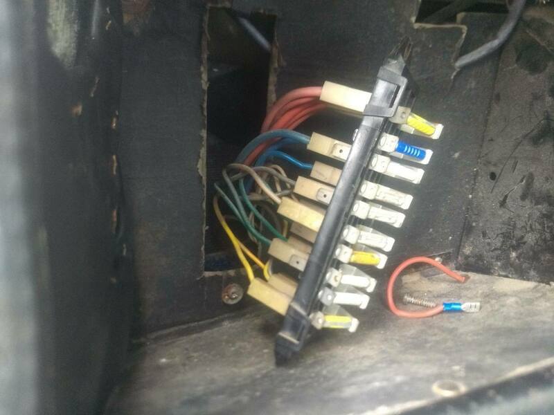

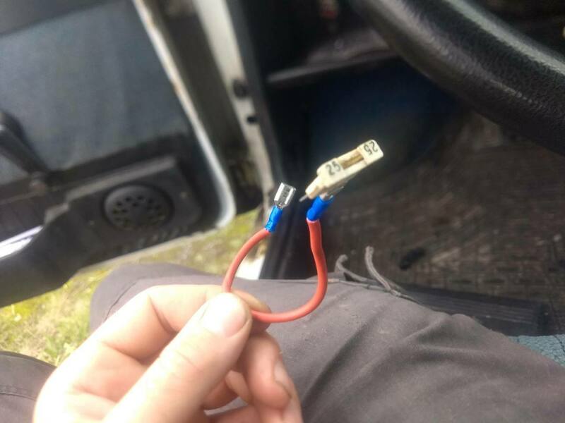

catsinthewelder Posted August 24, 2021 Author Share Posted August 24, 2021 Not put anything in here for ages but the Dacia is now MOTed and has been to the FotU and FoD this month. I was quite pleased to see this the other night Finished work early today so got some tinkering time. First job was to fix the left dipped headlight which stopped working on the way back from the MOT. @3VOM spent ages helping me look for the fault on Sunday and I was fairly sure it lay in the fusebox as he proved it wasn't in the light. I've even bought a new fusebox but can't use it as all the feeds are linked and mine is wired in after the switches (I think). I've eliminated this bodge wire that didn't appear to be required. I spent ages working out which fuse did what as the manual was hopeless. Ended up wiring the two dipped beams together as one of the fuse positions was duff. Not certain what current is required to blow these fuses as they seem to get hot enough to melt without blowing 🙈 Got there in the end though 😁 I was so flushed with success that I had a go at the Rover Managed to get one wheel unseized which is a start. Fresh battery won't turn the starter motor so I tried rocking the car to unstick it and found it wouldn't move, even the fronts are seized 🙈 Angrydicky, LightBulbFun, Dyslexic Viking and 12 others 14 1 Link to comment Share on other sites More sharing options...

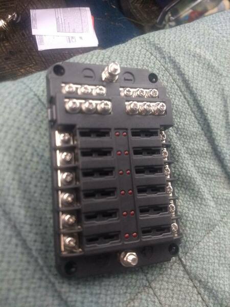

mat_the_cat Posted August 25, 2021 Share Posted August 25, 2021 On 8/24/2021 at 10:11 PM, catsinthewelder said: @3VOM Not certain what current is required to blow these fuses as they seem to get hot enough to melt without blowing 😁 I can't seem to be able to delete the the or smiley whilst on my phone, but the fuse melting issue sounds very much like a high resistance connection at the actual fuse holder (either wire to terminal or terminal to fuse). As soon as you start passing any significant current it heats up, dropping the voltage over the circuit in question, and potentially getting the fuse hot enough to melt even though the current is nowhere bear its rating. New fuse box the right shout, but the wrong type! catsinthewelder 1 Link to comment Share on other sites More sharing options...
catsinthewelder Posted August 26, 2021 Author Share Posted August 26, 2021 I think you're right there @mat_the_cat. I'll try giving everything a good clean when I get chance and hopefully the temperature will drop a bit. Otherwise I have 2 possible options. 1, if the car has been wired sensibly all the wires to the fusebox will be from the same place with the switches downstream of them, in which case a thicker wire from the battery to the new fusebox and everything wired after it would work. 2, If it's wired as badly as it looks with all the dash switches being before the fuses I could pinch the little fusebox out the back of the campervan for the Dacia and use the new fusebox in its place which would simplify the wiring there as one side of it consists of all the unfused positive contacts wired together. Link to comment Share on other sites More sharing options...
