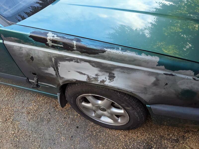

In the meantime, I've been attacking the offside wing.
Cellulose thinners are being more effective than this Strypit shit I have. So far it's shown most of the panel is bare metal. A quick sanding verifies this. Going forward, I'll use the paint removal disc I have and go gingerly. I'll slap some cold galv on, filler primer, sand and then paint with the tins I got with the car. Eaaaasyyyyyyy😂
