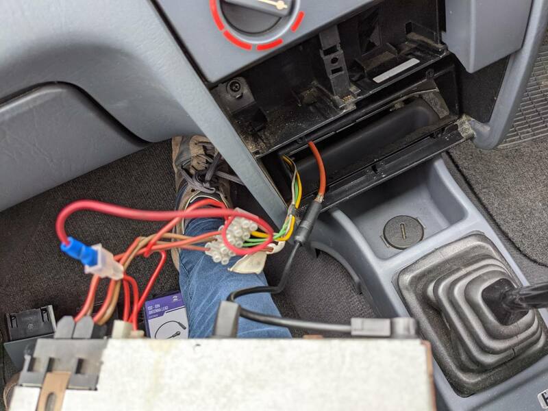

Did radioshite yesterday. While the Panasonic headunit works, the FM quality is dogshit and isn't nice to lisen to. It frequently loses signal in places the Micra's similarly-aged radio didn't. Put simply, it was a pain in the arse to use and tune and I didn't like the look or feel of it.
Fortunately, there was a spare Blaupunkt Boston radio/cassette unit already fitted to a better condition bezel. I took it apart and cleaned it on Friday evening and verified it was working:
All it's presets were set just out of frequency of all the common radio stations. Weird. It demanded a code, as they always do when being powered up for the first time, I punched in the numbers and ws greeted with a functioning unit. Excellent.
Whoever was in there previously needed to edit the factory provided wiring to fit the Panasonic unit. All the spade connectors were lopped off and put in a chocbox yonks ago. Luckily, the owner's handbook describes what wires do which so that was little concern. I needed an earth connection but lacked spade connectors. So I did the right thing and scavenged one from the old alarm wiring which also happens to be coloured red! Perfect.
Fast forward to Saturday, a mate of mine picked up an antenna adapter so I could test the speakers.
We has Choonz.
Programmed in all the radio stations I wanted and it sounds excellent. I'll clean the cassette player and try it out when I'm back home for longer than a day. No Dolby NR but the recorder I have doesn't hiss all that much. Could do with HX Pro though.

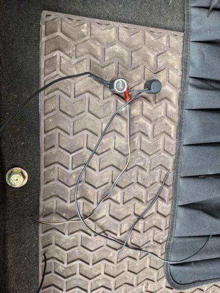

In other banal news, I removed all the visible remnants of the old alarm system attached to the interior.
Bang and the dirt is gone.
When fishing out the wires for the steering column LED, I discovered that all the central wiring was done behind the column fascia. There's an errant relay socket, a rat's nest of wires snaking everywhere, all in the same colours that go to the connectors in the engine bay. I'll chop back as much as possible at my leisure, as all of it is redundant. That being said, the lack of relay in the socket suggests someone already made the steps to disable the alarm portion quite some time ago, which would also explain the missing panel screws and broken clips in that area. My aim is to cut off and insulate the wiring going into the engine bay. From there I can treat and seal the rusty holes entering the dashboard and through scuttle bulkhead. All the hidden wiring doesn't concern me. Depending on what it's connected to, it may prove useful someday.

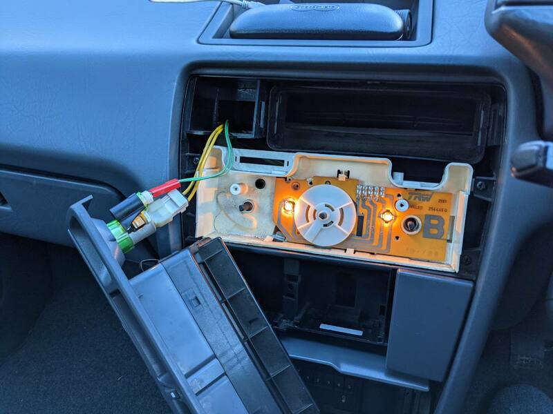

Might this be a later revision board? The mod on BX forum looks to have already been made here and the boost relay clicks like it should.
  • Fumbler changed the title to Fumbler's Crocks- Hot Air
Wet car
The weather made it obvious to drive to a remote location, walk and get soaking wet and then break the heater system so I was forced to drive back in a steamy car. It broke because this happened:
Enhanced imaged goodness. Basically the top piece of metal bridges the traces on the heater PCB to make the blower turn at different speeds. Constant contact with said traces is ensured by the bottom piece, which is a piece of sprung brass. Unfortunately, being brass, it bent out of shape over the years and wasn't providing the springyness to make contact. Unfortunately they're joined with CA glue instead of solder, which I'll rectify in  a couple days' time. For now, I bent the brass out a bit and superglued it in place. All the bulbs were blown so I've ordered 4 new ones which I can fit this weekend.
Now the heater blower nearly completely works without needing to whack it!
There's a dead spot near the top end but I can live with that for the time being. Full speed relay works and most of the variable control does so that's a win in my book.
All the springs are missing on the centre heater vents so they've gone floppy and loose. Fixed with some folded thick paper.
My hands stank of cigarettes afterwards. Fortunately the car's overall smell has improved with use but the smell is always interesting* when the interior is hot.
2 hours ago, Fumbler said:
Lookey lookey @jamescarruthers
Wow, maybe! It certainly looks different from the two I did on later cars than yours. I never knew Citroen actually fixed it. It is very weird that this is fixed on an F-reg car. Maybe you have  previous owner who bought a new panel from Citroen after complaining about poor ventilation?
Very interesting!
Very interesting!
Indeed! Board is dated 1988 which matches the ORGA code. It certainly hasn't moved in a very long time so I suspect it's original. I suspect it's something PSA quitely fixed and didn't tell anyone, not even performed a recall for. I also suspect they continued to use the defective boards just to get them out of the plant.

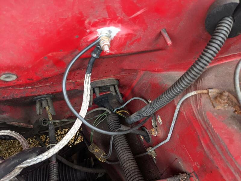

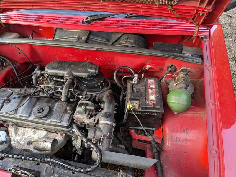

1. Remove old earthing equipment:
PXL_20210515_134911373.thumb.jpg.e24bfdf160b34c69d90c9691552260b8.jpgPXL_20210515_185616941.thumb.jpg.9f6ac8aad58e48807c1309f2daa4028b.jpg
2: Make new body earthing point because the old one was literally tearing out of the car:
Copious amounts of Vaseline added to keep corrosion at bay.

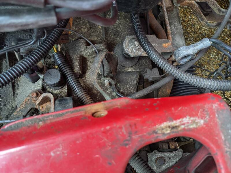

3: Clean the stud and attach new 32mm^2 main engine earth:
4: Admire you new earthing system and revel in the ease at which your car starts.
Relocating the earth to a non grotty spot has caused my map lights to work of all things!
Marvellous.
The car now works very well. Starts better than before and cranks over easier. It still cranks a bit slow thanks to the undersized battery, but that'll be fixed soon as well.

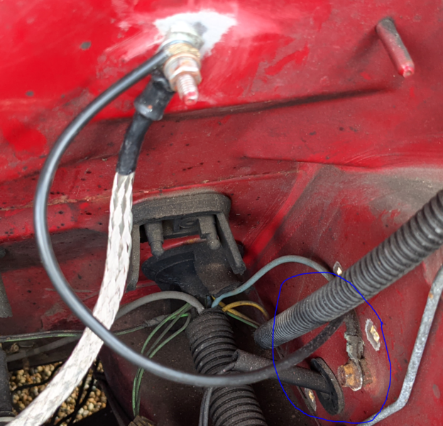

The black cable going haphazardly into the new body earth terminates to the bolt highlited in blue:
From there a fat looking cable goes into the loom. I didn't have any lugs the correct size to hand at that point so I decided to just wedge the wire into the new earth stud with a bolt and a washer. When I receive some lugs which'll fit the stud, I'll crimp one onto the black cable so I can bolt it on securely. I may also eliminate the old earth point from the circuit by replacing the lug with a crimped splice.
After all was said and done, I took it out fora Damn Good Thrashing. My God it's fun to chuck around. I can only imagine what a 205 with the same engine is like. I'd love to try one someday. Acceleration from 20-60 is incredible. Stops on a sixpence and just keeps so stuck to the road. Its zippiness is almost as fun as the Micra, which definitely is fun to blat about in without a black box.

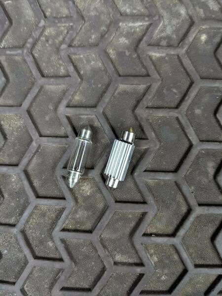

I've also put in new lamps into the centre console.
And I've now properly fixed the heater controls. No hesitation and the fan works throughout the range. The bearings are squeaking at high speed though.
PXL_20210515_194515821.thumb.jpg.90e65df1663a8d06dd9cb46f8e470972.jpgPXL_20210515_194527778.thumb.jpg.9d1e19f80efcfe776419b0907b16bbc6.jpg
I've now got a warm hue from the heater controls. Rather cleverly, Citroen also added a slot under the heater dial to light up the ashtray at night. Because, y'know, finding a place to deposit your smouldering Gauloises in the dark is more important than looking at the road ahead.
